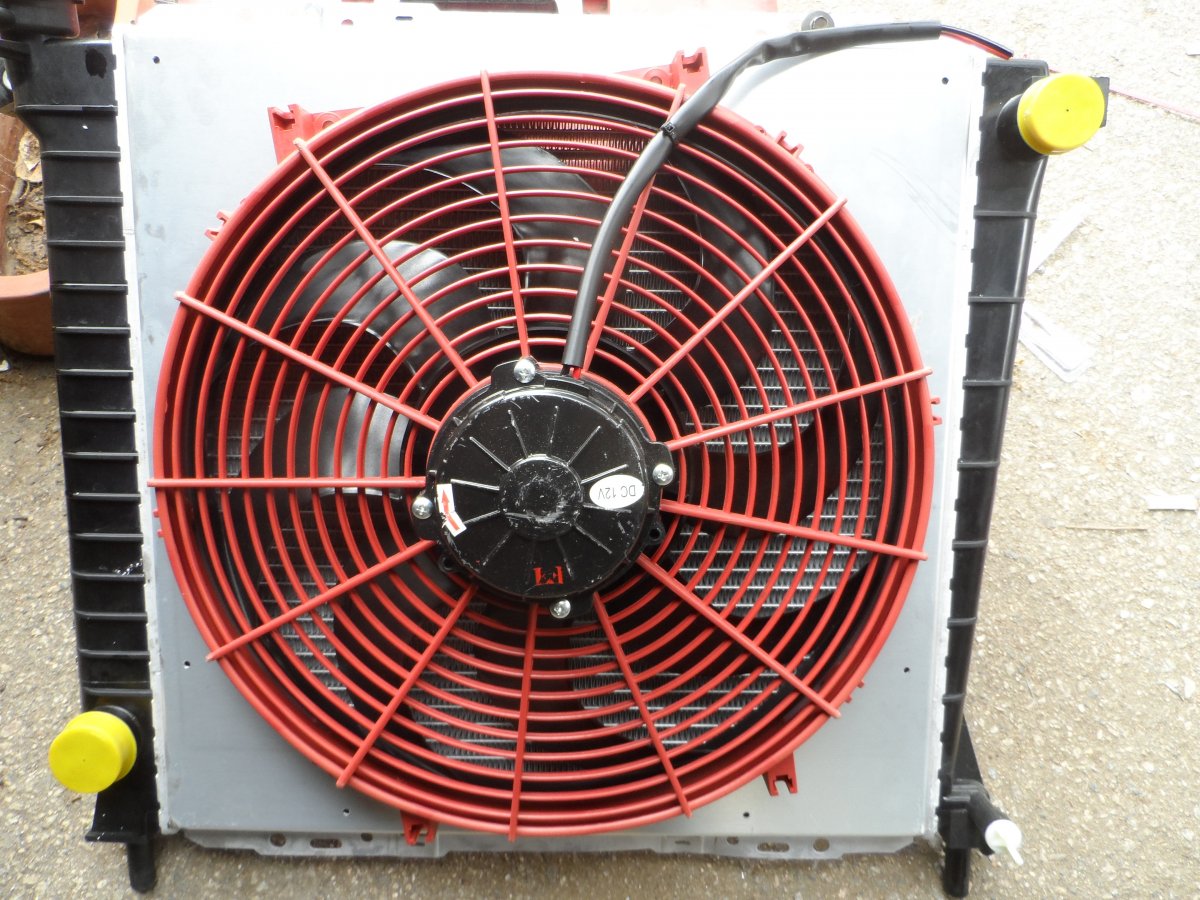

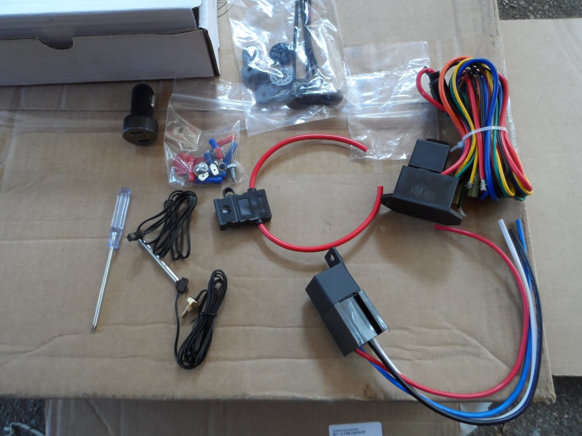

ok heres some pics of the kit and whats going on
My experience mirrors @PetroleumJunkie412 's. I have my switch in the lower radiator hose. Couldn't get it to work at the right temperatures any other way. I think I'm running a 180 or 190 degree thermostat, too. 195 was too high for me. You may have a wiring issue if it runs immediately on a cold startup.

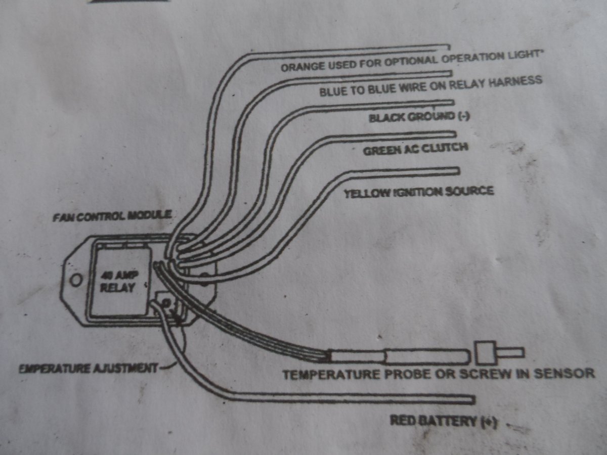

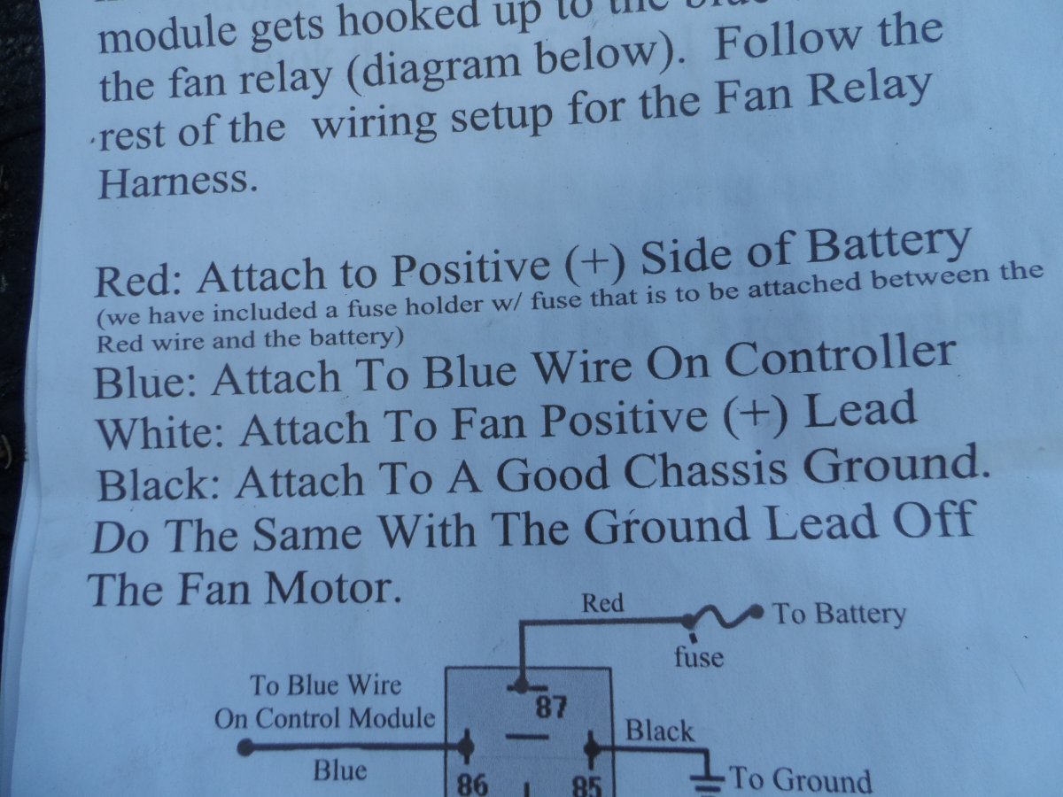

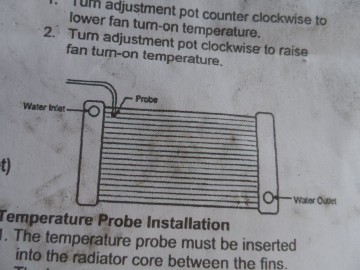

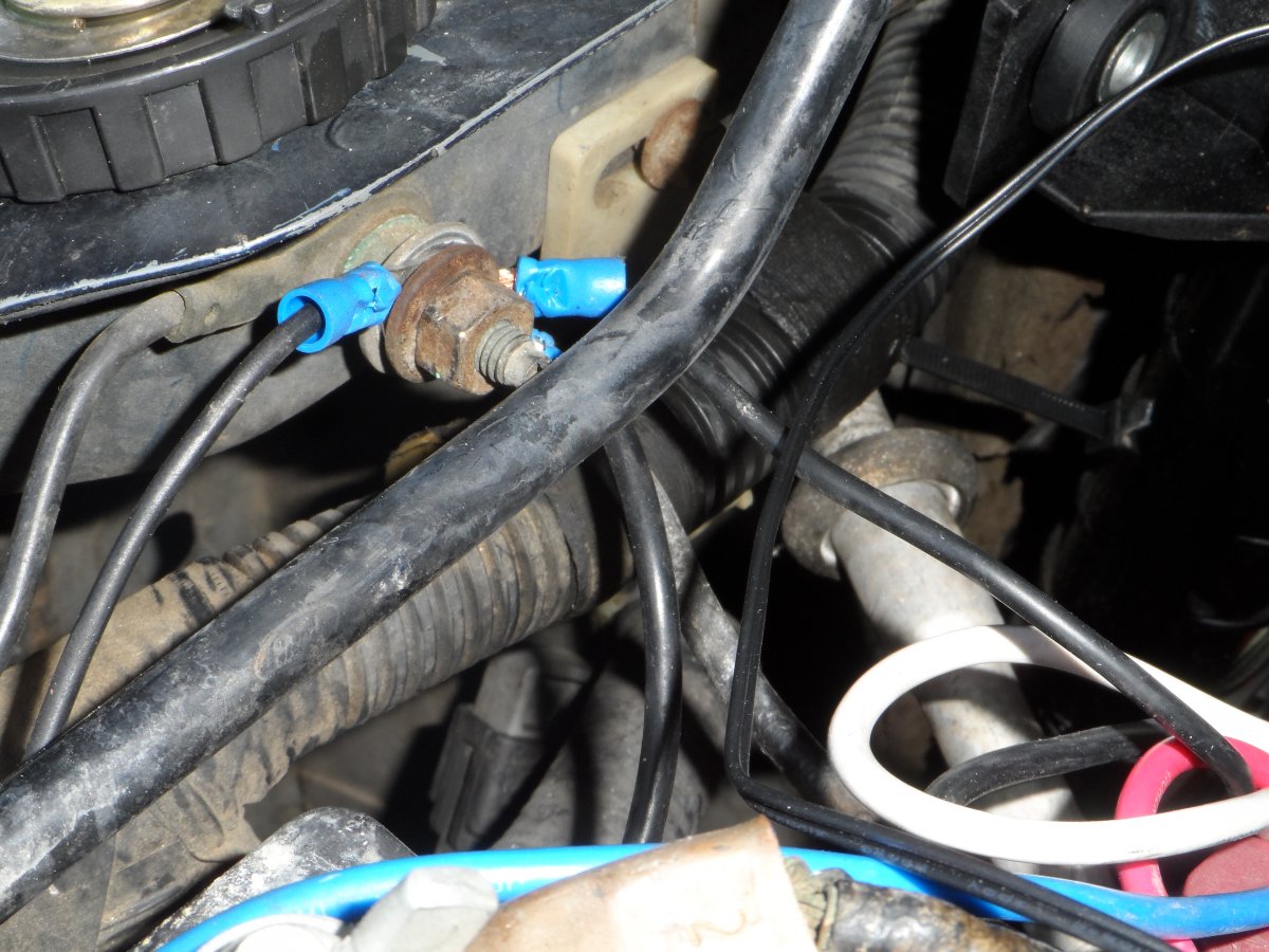

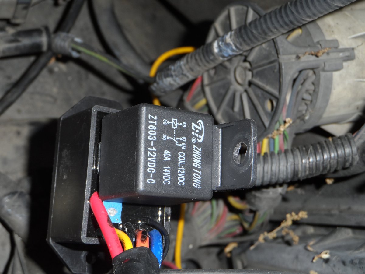

yep running immediately on cold startup. Idk what it could be...I posted pic of my grounding location. The instructions (as pictured) were clear and easy and I followed them to a t. All I can think of is either bad probe or bad controller, neither probe makes an effect, so probably bad controller...
It sure sounds like the controller.

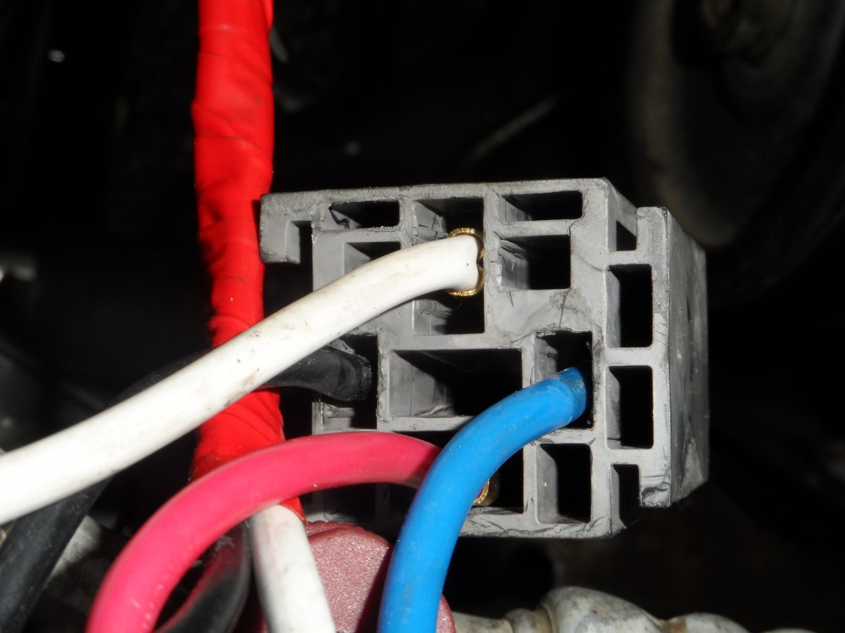

In the instructions is shows the BLUE wire as the ON/OFF for the relay
In automotive relays 85 and 86 slots need a ground and 12v to turn ON the relay
When a relay is ON slots 30 and 87 are connected, this is the 30 or 40amp LOAD the 12volts that runs the fan motor
87A should NOT be used in this setup
In the diagram 85 is grounded, which makes 86(blue wire) the 12v activation wire
So the Controller uses the Blue wire to turn on the relay and fan motor
And with no sensor connected I would expect the controller to deactivate the Relay, cut 12v on blue wire, but..............
There is a thing called Fail Safe, in an e-fan system if there were to be a temp sensor failure you would want it to "fail safe" which would be with the fan ON full time
So no sensor may cause controller to activate the relay
So the sensor itself is what deactivates the controller when it connected and blow temp setting, you don't have a circuit diagram of that and I didn't see one on their website, so can't say, but I would design it that way

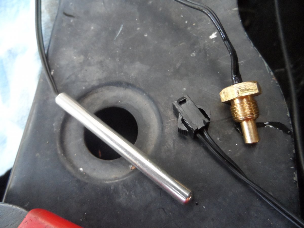

If you have an OHM meter you could test the probe type sensor to see how it reacts to a Match/lighter, do OHMs go UP ot DOWN as it heats up
If so then probe is probably working
So the sensor itself is what deactivates the controller, maybe, you don't have a circuit diagram of that ad I didn't see one on their website
dang good idea I should try that...I would like to at least rule that out, or in...Also yes I think its fail safe keeping it on when unplugging sensor. Instructions said Blue to Blue (controller to relay). Honestly I kinda suck at relays, gotta really study em and connect the dots before I can picture what its doing circuit and switch wise...I was totally reliant on the instructions and wire color coding.
Just realized and wondering if I could just splice in my non adjustable sensor (when it arrives) into or around the adjustable controller, so as to not have to run all new wiring again?
You would need to see what the ohms are on probe to know if other temp sensor will work
OHMS usually go down as temp goes up on these types of sensors

The controller/relay activates the Fan Relay
The controller/relay and sensor are all that's in question because the Fan relay works, fan comes on
You haven't hooked up the Green AC wire yet, correct?
As 12v on that wire would activate fan
And fan goes off with key OFF, correct?
That means its wired to ignition OK
So either the sensor is bad, and BOTH being bad is a long shot, so Controller/relay is bad, best guess
