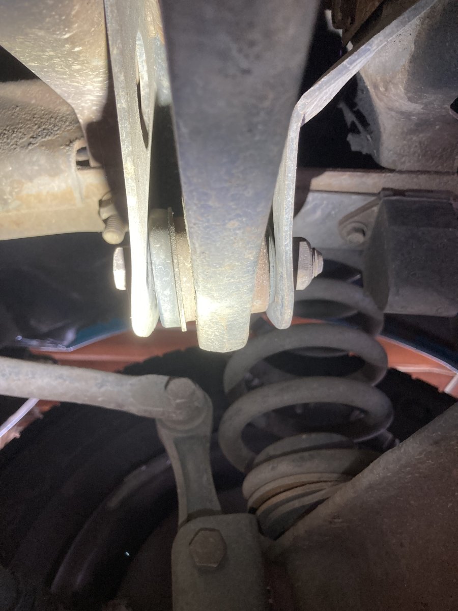

I started a thread about alignment but found out I have bigger fish to fry. Main symptom is significant shimmy going over potholes and some squeak going over bumps at slow speeds. Tires looked slightly out of alignment so I thought that was it so took it to a shop and found...
Findings
  1. upper ball joint play on the driver side front
  2. very bad shocks all around

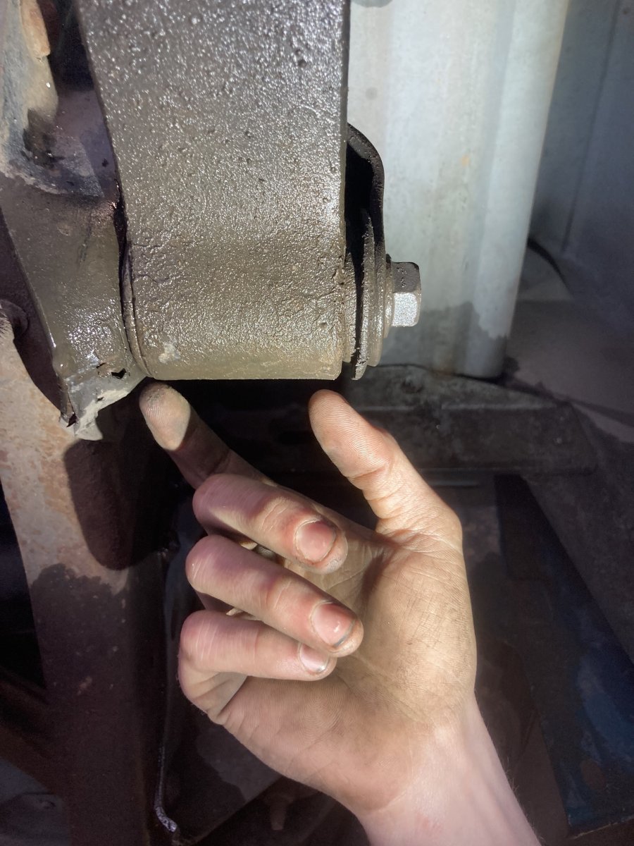

  3. worn bushings on the twin i beams (pics below)
  4. rear passenger leaf springs are a bit tired (the middle one is not snug up to the top one)
Questions
  1. Do both sides of ball joints need to be done? (I plan upper and lower)
  2. Anything else I should replace while doing the ball bearings and I beam bushings?
  3. Is there a specific name for the bushings on the I beams? Pics from the mechanic below.

Always heard those called axle pivot bushings.

These suspensions are pretty simple, I wouldn't lose sleep over those pivot bushings, the radius arm bushings on the other hand do more for ride quality (it's the one behind the tires).

Thanks. I tend to think like you, "hey, while I'm in here...." but money is tight right now so I'm balancing. I'll do all the ball joints and shocks. Might save the axle pivots, they don't look terrible.
