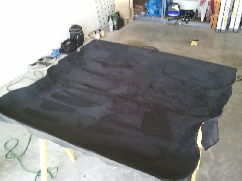

Finally did it! I took my time to remove every little bit of foam from the board before I did any glueing. Til it looked like this!
And here is the finished product!
Mounted up in the truck...

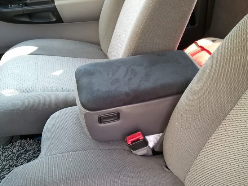

The fabric I used was non foam backed micro suede from the Jo-Anne fabrics and the glue was headliner glue from there also. Total cost was about $46.00 with two yards of fabric and glue. I even had enough fabric left over to do this...

How'd you go about removing the foam?

A wire brush, and a stiff plastic bristle brush for the more fragile curvy areas. When you do it, just be patient, or else any bit of foam left will cause the new material not to adhere properly.
