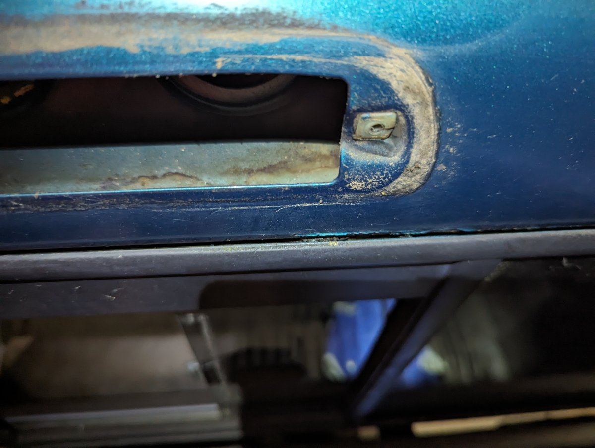

Tightening the nuts to get the window back in place with the new tape was probably the toughest part of the job to me. I spent a little while to make sure I was tightening them evenly across the window. Even then, at the end there might have been a tiny gap but I didn't feel comfortable cranking on it anymore 😂
I don't think you can damage anything. The bolts aren't touching the glass. I didn't think it was really difficult. It was kind of a hassle moving the back panel and side panels out of the way. I was able to use a 1/4" wratchet to tighten the top without removing the headliner. I parked the truck with the back facing the sun to soften the butyl rope and snugged them up a little more. I broke about four panel clips, so I will have to acquire a few of those. I think I am going to try the ones with the plastic screws in the middle to see if they work, if I can find them in the size I need.
My painstakingly renewed headliner got wet (first time in rain). Right by the rear window. I was thinking maybe the gasket/whatever on the cargo light, so whipped up a gasket for it.
But when I was putting it in, I noticed how much the window was pulled away from the body.
I saw that there should be some butyl tape in there fighting the good fight, but seems like a big gap. I guess I could wait for the headliner to dry
and then pour some water on it again and see what happens :cool:
Opinions?
Mine is fixed like that. It's worked at least for several years now.
