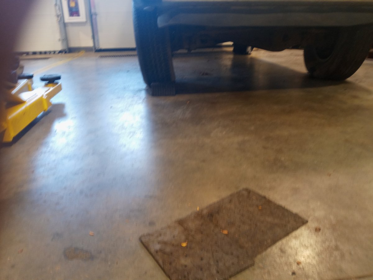

Recently I picked up an 85 ford bronco ii 2.8 manual with the 5-speed and have been working on getting it road worthy again.
Next problem after the horrendous engine timing from the previous owner or whoever is my positive camber change.
Literally just lifted it so I can get the tires off and check some stuff out, set it down, and suddenly it's got a very noticeable positive camber change, I'm not sure if something shifted or what, was just looking if anyone had any insights?
the bushings looks good to me and I'm not really familiar with the systems in this car yet so I figured Id ask.
Sudden Positive Camber after lifting.
Its an I beam thing. Get in and turn the wheels back and fourth or back up or whatever they'll go back to normal.
Its just what they do coming off a jack.
Yeah. What Rusty said. Go drive it 40 or 50 feet. It will be back to normal.
Or just push it forward and back a few feet in the garage. By the way, that's not a lot of positive camber, you should see a swing axle VW with the weight off the suspension.
