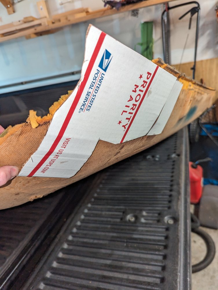

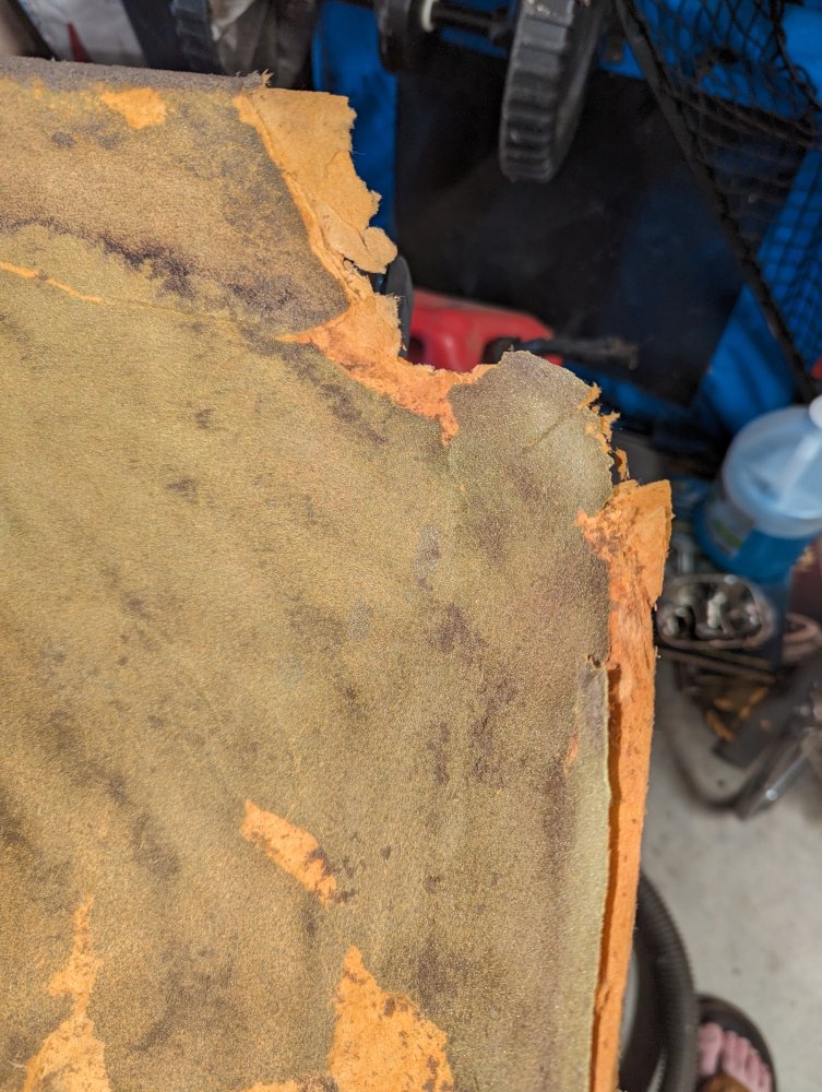

I'm putting new headliner in but the cardboard (??) backer is rough on a few spots.
I was thinking I could add some thin veneer type wood or something similar to fix the bad spots. What have y'all done in this situation?
I hate to be a naysayer, but I think that one is toast. That boards starts doing that and I think it's just going to keep getting worse.
IMO, I'd source another. Looks like you've got an extended cab so one any from 1993-2011 extended cab should work. If it's regular cab you'd need 93-97 due to can length change, or possibly shorten a 98+ one.

Ugh. Everything I've seen in the boneyards are as bad or worse. I haven't looked at aftermarket options though.
Thanks for the info!
Maybe you can get lucky.
I've seen people make new ones out of similar material from Lowes or Home Depot. That was on older trucks where it was mostly flat board, not formed like these newer trucks.
I wouldn't try to make the whole board out of that, but maybe you can use the same stuff to make patches for yours.

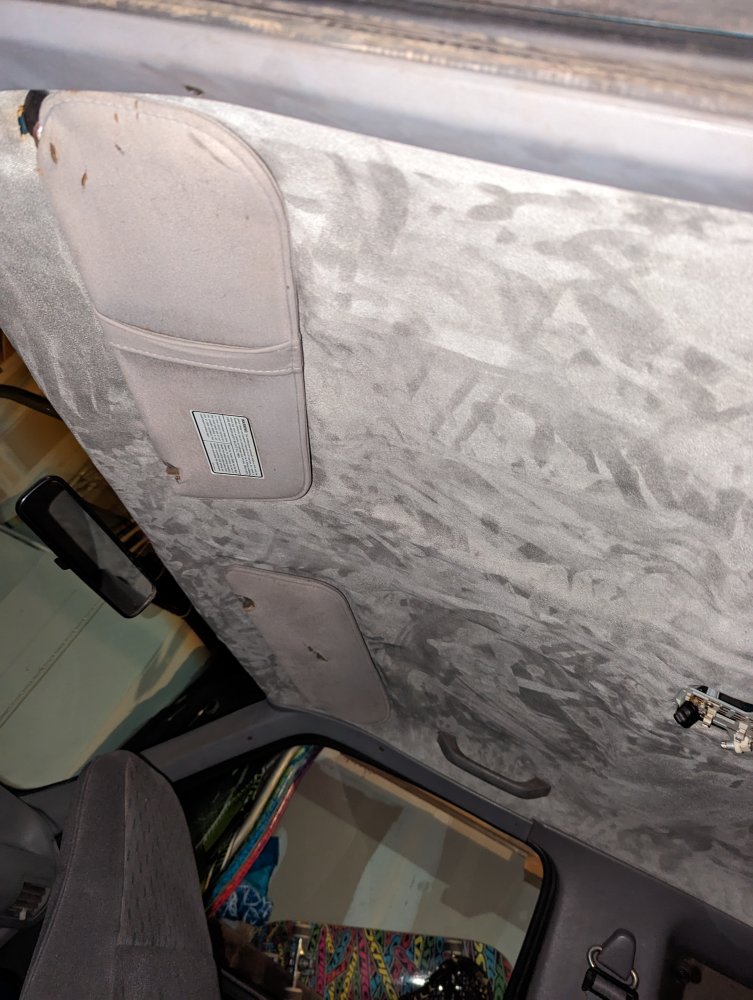

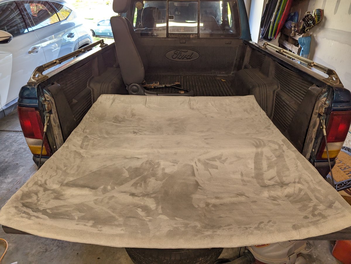

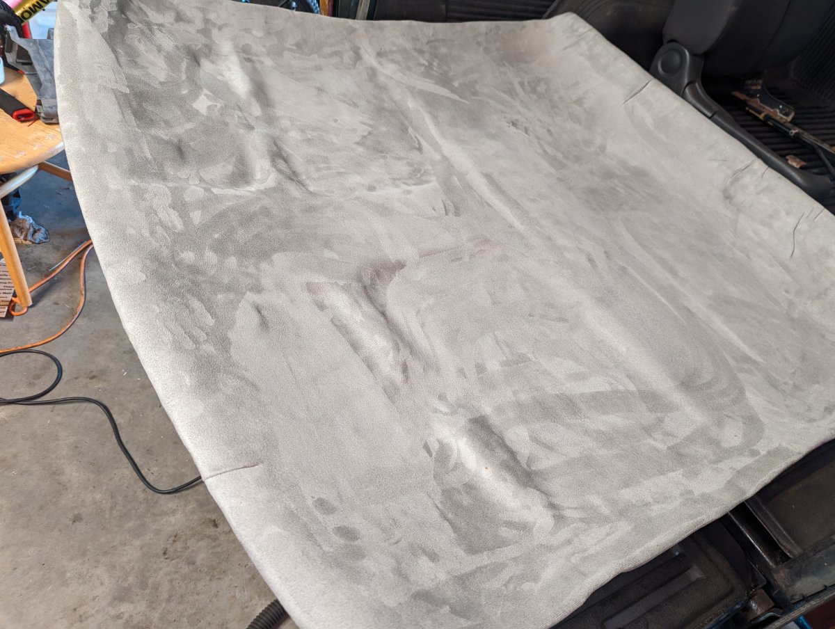

Well, I made do with what I had on hand bc of timing. Hack job is putting it mildly :icon_rofl:
I glued cardboard to the worst spots and then slapped the new fabric on. In my infinite wisdom I started with the back so that my mistakes would be more hidden...
Couple of janky folds, but could be worse. The headliner spray I got is unforgiving. Once the surfaces meet, they are mates for life.
Was able to lay the front down a bit slower and only have one real fold

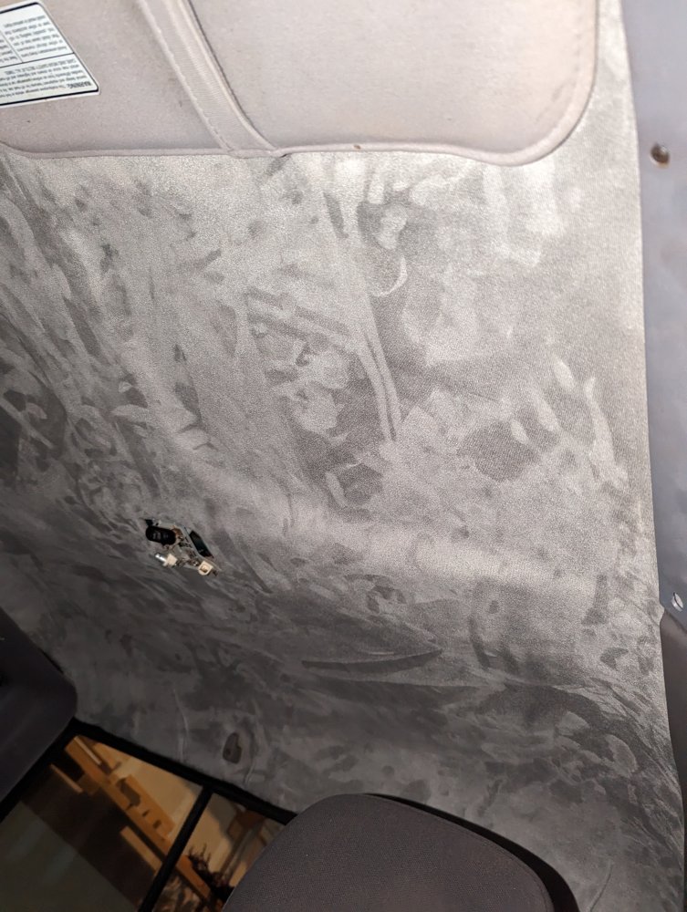

No pics of it installed, but it's in and for the $40 it cost, I'm calling it a 90% improvement.
Luckily I broke more plastic trim to ensure I'm never truly done working on the truck 🤣
The headliner fabric added a good amount of strength once it was installed. Hopefully it will give me a few good years. Will try to remember to get some installed pics tomorrow
