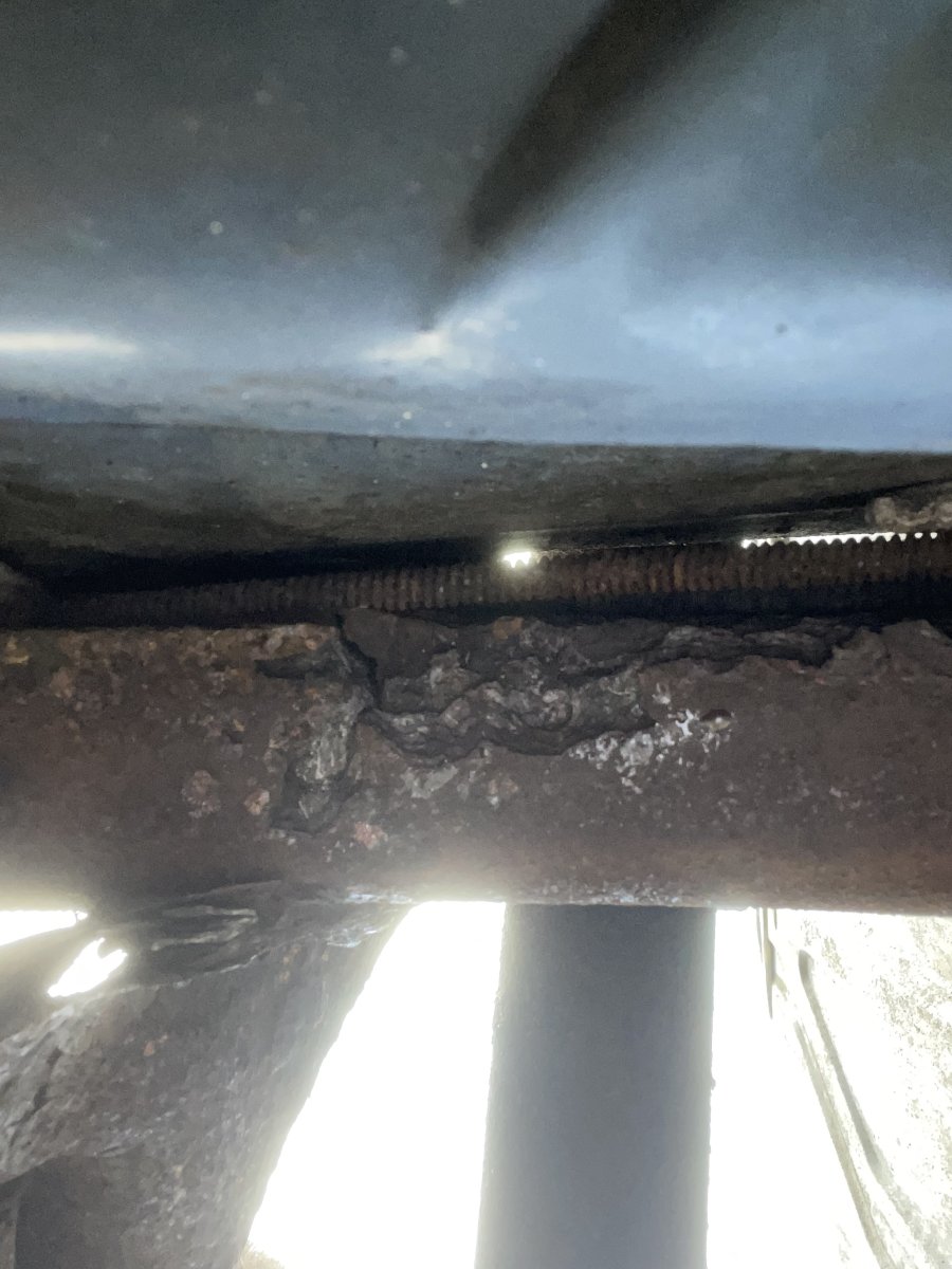

I recently bought a project 1996 Ranger. The frame is rusty, but only has one spot of rot. Is this spot small enough to warrant just cleaning up and spraying with rust reformer? Or is it necessary to cut and weld? This section of the frame is right next to the gas tank. So I may have to remove the gas tank to get good access to it either way.

That frame is broke through. There is no using “rust reformer” on that. It’s toast. You either need a repair piece or to fabricate your own. That spring hanger looks to be a crispy critter too and I bet when you take that off you will find crunchy frame around where it mounted.
That section needs replaced. You get the bed off and started tapping on it with a hammer, you might be surprised at what would be left. I am not familiar with the 2nd gen Rangers, but I seen a thread on here saying some in that generation, the frame is a two piece frame. That might be an easier route to go. Maybe someone can give you more information on that. Good luck finding a frame in New Jersey but if you get south a little ways, they are in great shape here.
