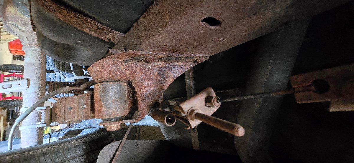

When do I know when there is too much rust on the frame. 1990 Ranger and the frame is a mess. thinking of taking off the bed and trying to clean it off then painting it to at least get a few more years out of it. After that then do the front of the vehicle. Picture attached of the rear spring mount.

Well.. that spring hanger is in need of replacement for sure lol. You're not gonna be able to really super accurately tell how worthwhile the rest of the frame is until you take the bed off though.
Well, it is easier to check the frame when rust isn’t raining down anyway. I usually just reach under and bang around with a chipping hammer until I find the soft spots…
