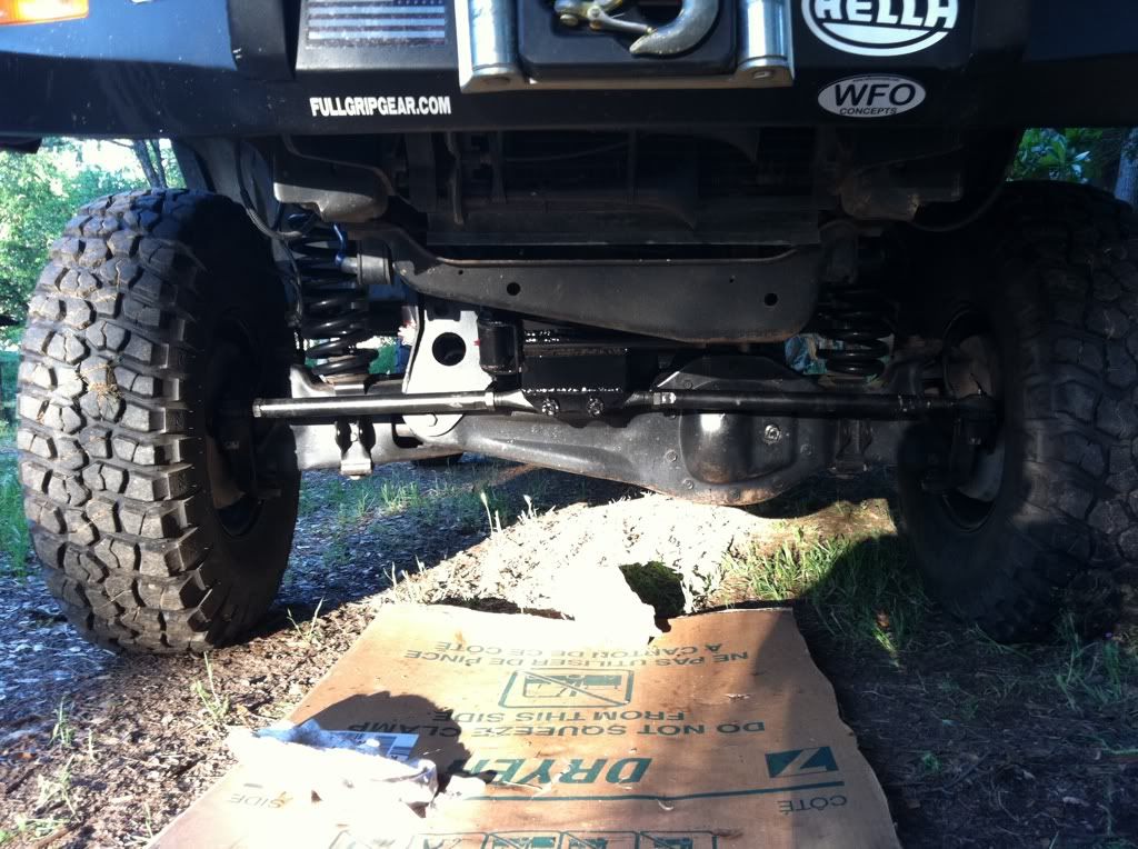

Stonecrusher type steering
Oh yeah
left side fully compressed
front end in the air
driver side view
Doesn't hit anywhere.

concern with that set up is does the center TRE for the drivers side have enough movement when at full droop? like getting a little air hopping over a abrupt hill?.
I'm guessing it does, but bent will have to confirm. It looks similar to the chevy double-pivot drag link ends and if it is of similar design, I know first hand those double-pivots have a huge range of motion.
That is what I used and so far hasn't been an issue.

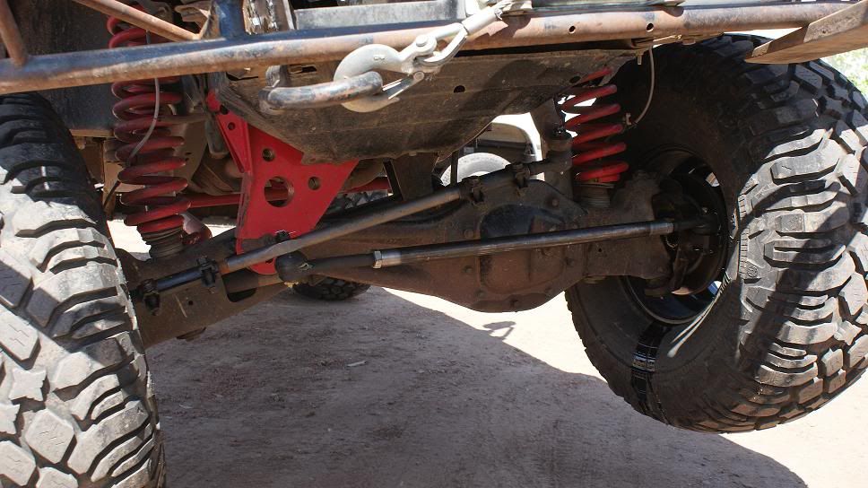

Just for future reference, no matter what kind of steering set up a person runs, flat tie rods minimizes most (if not all perceivable in the cab) bumpsteer and increases drivability considerably.
Here is a good picture of what I mean by flat, and not angled upward tie-rods:
The tie rods are swinging on completely different arcs than the beams.. Look at how short they are. It's definitely a improvement from stock..

My setup would work with a truck using huge drop brackets. The swinger would have to be hung lower on the frame rail. Also, a drop pitman would help out..
Their shortness is irrelevant. The bumpsteer produced is not perceived in the cab, even if it *is* happening due to the difference in length between the tie-rods and beams as long as they are matched and flat.
