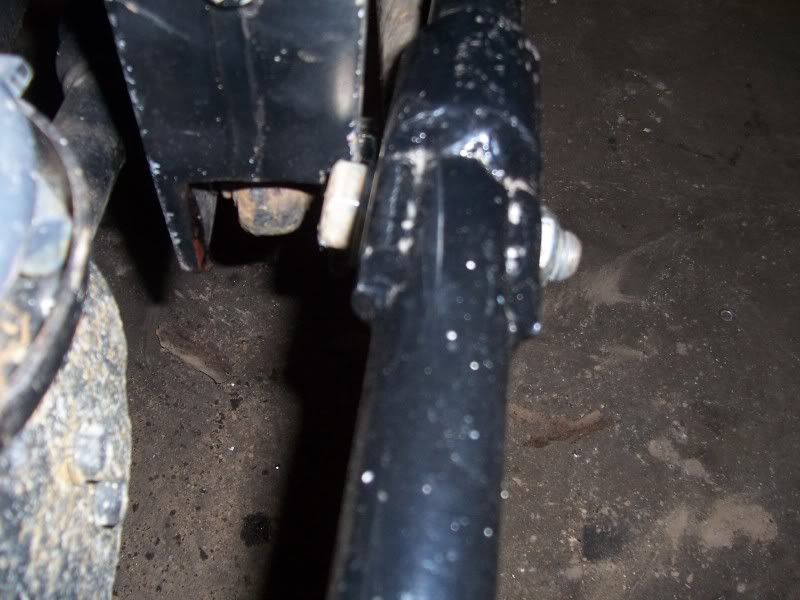

Probably stopped cause I brought some issues up to him. Check my Build thread or my post in the steering section of this forum. I got a set up from him a few weeks back on am having problems with the bolt for my drivers side link and saddle catching on the Drivers side axle pivot bracket. When you turn the one side or the other the links are so long that they push towards the axle. Here is a pic of my problem.
Other than that this thing is vary stout and you won't be sorry. The tube is 1 1/2 .25 wall and the thread size is 3/4 with 3/4 heims. Don't forget that you need right and left hand threaded taps and heims.
how hard does it push into the bracket? If its only slight, you could put steering stops in, that would be an easy remedy.

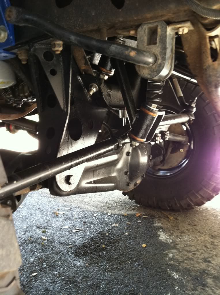

Modified Superlift kit:
A K-link setup (shorter tierods) makes a small compromise at the extremes of travel vs. swingset or crossover steering for a little more simplicity and better durability (not necessarily of a Superlift kit, but of the K-link design in general). Built from DOM and Chevy TREs, I think a K-link has the potential to be more durable than anything else used on a TTB.
Stonecrusher's design is even simpler still (no CL & idler arm) and is the most forgiving of any height mismatch at your beam pivots, though I don't think it would exhibit quite the same durability IMO, though still far better than stock would be.
Like Legoms said, the SL kit is woefully ill-engineered at the factory, but modded it works decent on a crawler/trail rig/DD (just don't hit it's thin tierods against any rocks lol).
When my stonecrusher copied setup hung up, it would lock up so bad that it would deform and temporarily bend the tubing until it slipped over. The bolt, saddle and drop bracket all became rounded over real quick. And if that side of the suspension was compressed, it was real hard to get the tie-rod unhooked from the drop bracket.
Bottom line, on mine it was scary to drive, always wondering if you were going to have to do without steering at all or possibly bust some steering component.
Plus the bump steer was horrendous....made the truck jump half a lane at freeway speeds to the right, and the nose of the truck would waddle left and right as the suspension cycled up and down over wavy terrain.

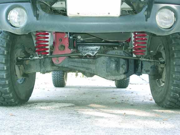

Here are some more pictures of my superrunnner with bigger tie-rods and the chevy rod ends:
The two inner joints are chevy high angle, double pivot draglink ends (DRE's) and the outers are the regular chevy TRE's.
Not the best pictures sorry. Next up is to mod the center link down 2.5", and cut/tap so I can run a replaceable RBV tie-rod end on the pitman arm connection.
As far as heims vs tradition TRE's, TRE's are better for lots of driving on the road (but require reaming of the knuckles) whereas the heims will wear out faster and produce noise when they do (not to mention slop). It is however easier to drill out the wholes than to ream for the chevy taper. Then again its all about trade offs...
Was gonna say, looks like you didn't mod your centerlink yet (tierods are way up there).
That's exactly what I plan to do to mine (the DOM tierods & Chevy TREs). I've bent my d-side tierod twice now (bowed slightly, though not real bad). It's only a matter of time before I break it lol.

On this truck the centerlink is dropped down an even 2". As you can see, it's still not perfect with the 6" lift w/8" coils, but has proven to be acceptable.
^^^^^^^^^^^^^^^^^My steering should look JUST like that, if not a hair flatter (in respect to the tie-rod angles) due to my heavy nose and me dropping the centerlink 2.5". If I'm measuring right, It'll be pretty flat. I can tell already that the bumpsteer has worn my the square edges off my new KM2 in a matter of about 5,000 miles :bawling:

^^^^^^^^Looks as if your pitman arm is perfectly matched to your drop bracket lift height, as is key to proper driving characteristics. Looks good :icon_thumby:
