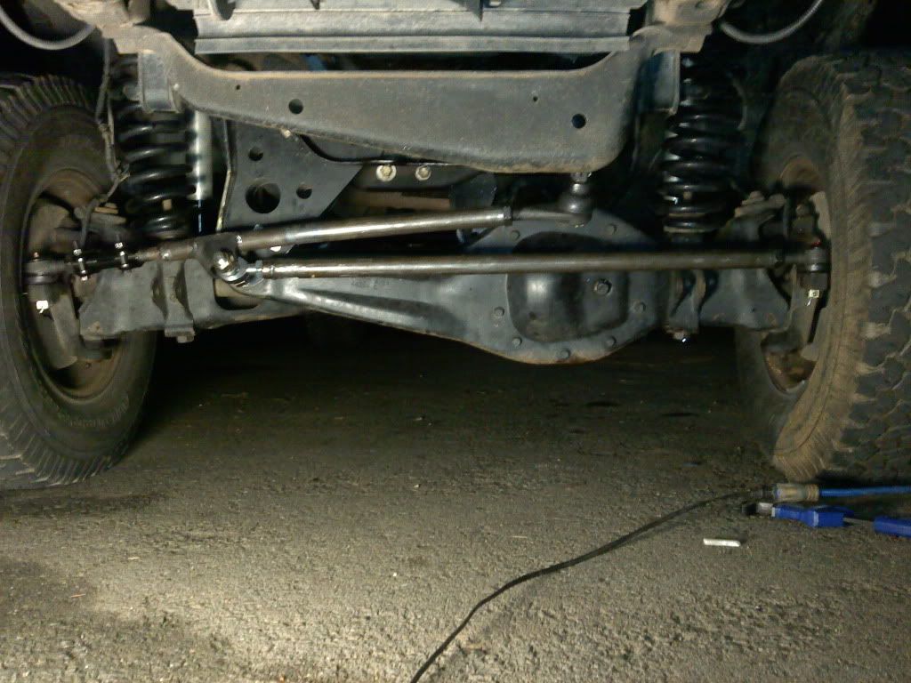

Probably stopped cause I brought some issues up to him. Check my Build thread or my post in the steering section of this forum. I got a set up from him a few weeks back on am having problems with the bolt for my drivers side link and saddle catching on the Drivers side axle pivot bracket. When you turn the one side or the other the links are so long that they push towards the axle. Here is a pic of my problem.

97ranger that looks like the axles are pushedtoo far back.. Might be a radius arm problem if u made your own ext ones. The mounting points will put the linkage at the same position wheter it be stock or not. The bolt will reduce some cleance a tad, but it seems as if the axles are too far back. Which will make the knuckles farther back and the linkage closer to the pivots. Just a guess, sometimes pics are decieving. I found some tie rod adjusters from poly p that I could put on the pass side to align it( the cradle is welded onto it so the turning the rod won't work). Thanks for the suggestions guys. Hopefullu I can get er dun in the next couple of weeks
I think the problem he is having is with the lateral location of the bolt. While you may be right also, there could be some axle location issues, the bolt being further to the right (or left depending how you look at it :D) is interfering with the drop bracket, where the stock setup wouldnt have anything to interfere with.

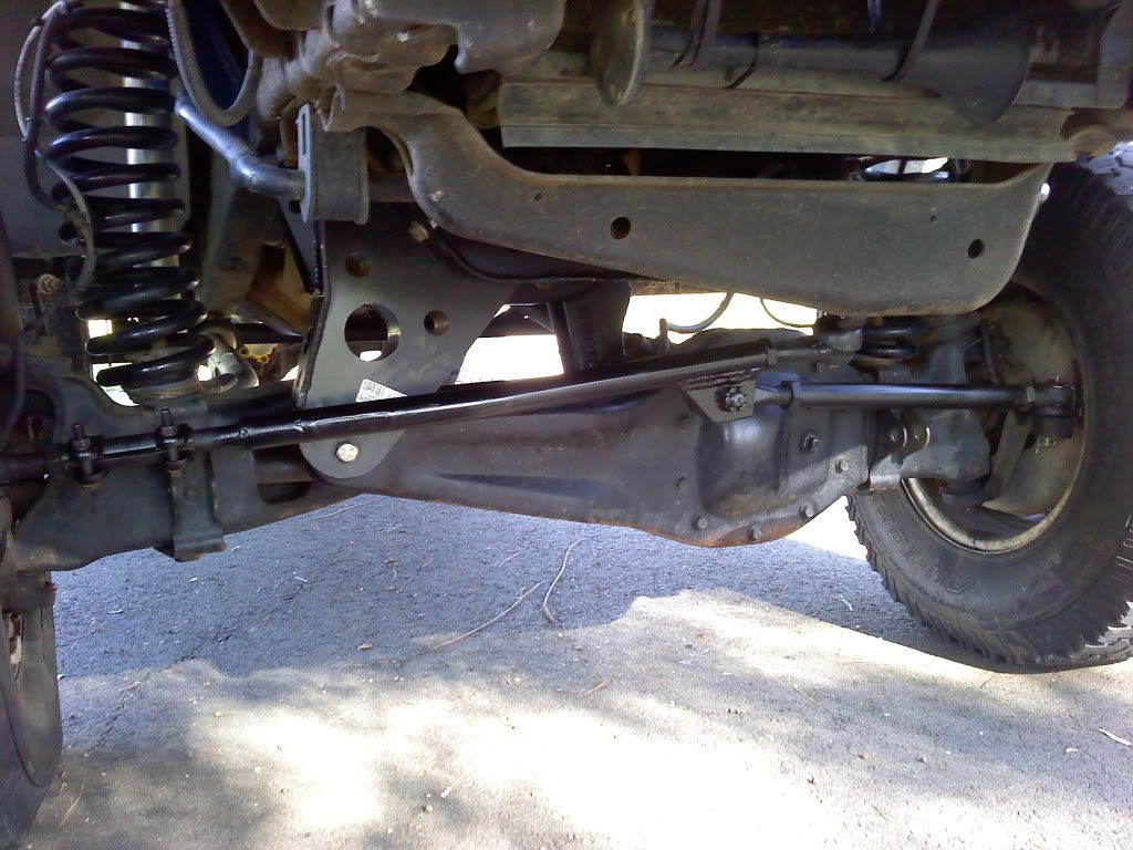

Check my build thread somewhere on the last 8 or so pages. I built a Stonecrusher setup with chevy 1-ton TRE's/DRE's. I've since changed to a Superrunner K-link 1-ton version. I also discuss that the stonecrusher setup is no good for more than about 5" of lift.
I had a local place make me my tierods. They are 1.25 OD, 0.219 wall DOM, tapped on the ends L/R hand threads for the chevy TREs. They ran me about $80 per tie rod and that includes milling wrench flats.
I also had that same problem that 97fordrunner had, and ultimately I had to switch to my 1-ton.ish k-link chevy TRE version that I am using now (aside from the terrible bumpsteer I was getting with 6.5" of TTB lift).
Edit, here are my two previous iterations that didn't work, followed by the K-link which works the BEST. All use the same size tubing and chevy TRE's/DRE's:
First: Stonecrusher copy w/ SJ FA600 pitman arm:
Stonecrusher type steering
Second: Stock style a la 1-ton, w/ SJ FA600 pitman arm:
Third: Current version, BEST w/SJ FA400 pitman arm:
If I were you OP, I'd find a used superlift superrunner kit, mod it and call it good. Much less hassle, replaceable parts, and minimal bumpsteer. Plus you don;t have to drill out your expensive knuckles/drop pitman arm.
