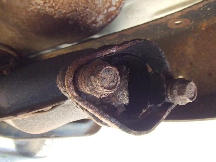

I just crawled up under there and measured whats left of the pipe coming off of the cat. I was using just a normal plastic ruler (it's about to rot off, I promise :icon_twisted:), but it looks like its 2" on the mark.
Now my question is, what am I suppose to do with this:
attachment.php
Looks rather menacing, doesn't it? By the way, i'm liking these new tires as I can easily slide up underneath this truck now. Theres a lot of space under there!
Looks like a trip to YE Olde Muffler Shoppe to me.
