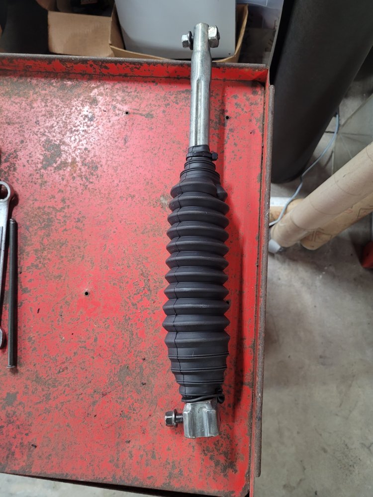

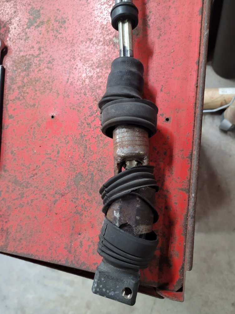

My steering shaft boot was seriously shot on my 2000 Ranger 2wd and, searching the internet, I learned that they did not make a replacement - I watched a video where someone took one that was close enough and made it work but had to do a lot of cutting to make it fit - I found a universal boot, right around 9 inches, and I just wanted to pass this off to say that it worked just fine - after cutting the old boot off and cleaning the shaft, I only had to slice off 1 small section of the smaller side and it stretched over the shaft where it needed - instead of the steel clamps provided, I just used black plastic ties - I got it from Amazon for 10 bucks - I wish I had a simple part number to pass on but just search for "Universal Replacement rack and Pinion Boot Kit Stretch Steering Rack Boot"

That looks great. Just noticed mine looks like the photo on the left.

I saw a video where someone else used a rack boot but he packed grease in the boot but none into the actual u-joints so it really doesn't do much good - I can see where grease is still in my joints so I left that alone - not like it is rotating at full speed LOL!
