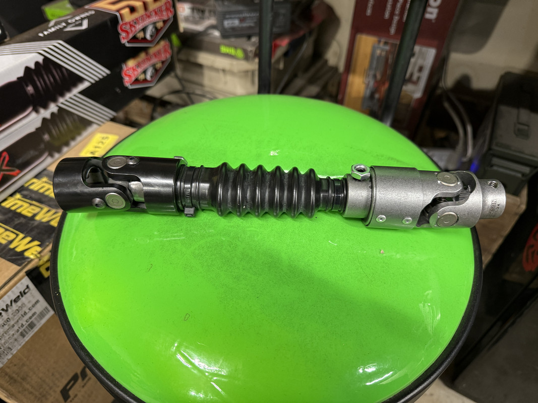

Ok RWB. This is what ended up working for the lower steering shaft I built.
92' Ford Ranger XLT with 2.9 V6.
U-Joints
steering gear input shaft end......3/4 inch - 36 spline X 3/4 inch DD
firewall end............1 inch DD X 1 inch DD
Borgeson part# 450024 telescoping steering shaft
This project was a pain in the neck!
It took me months to decide on a solution for this, in addition to determining the correct spline count.
I finally found this guy at Wild Horses 4X4 online. He had an early 1990's Ranger like me and he was confident that mine was 36 spline. He even borrowed a U-Joint from his employer and tried it on his Ranger at home to test. He was correct.
It took me an entire afternoon to cut down the telescoping shaft a little at a time to make it fit. I knew if I cut off too much, the shaft would be unusable and I would have wasted about $80.00. I also had to drill two additional holes with my drill press. I purchased both U-Joints off Amazon, because it was MUCH cheaper than the name brand. There is a guy named Jeff Grantmeyer at Borgeson who was helpful when I was working on mine.

Yeah. 1993 was a design change year for Ford Ranger. If you go the telescoping steering shaft route, you want to make sure you avoid any binding between moving parts. Some months after I finished mine, someone pointed out that the steering column shaft at the firewall, was rubbing against the U-Joint yoke. So I had to cut away a small amount of metal with my Dremel rotary tool.
Also, the telescoping steering shaft on mine consists of an inner shaft inside a hollow shaft. It is supposed to allow for some horizontal movement of the inner shaft which has a tension spring. So you also don't want any set screws restricting movement of the inner shaft.
I think I missed one of your earlier questions. I don't feel any vibration with the lower steering shaft I assembled.

Finally got this done last weekend. I did end up using a 1” DD X 1”DD & a 3/4” DD x 36 spline anti-vib with the Jegs 3/4” x 1” telescoping shaft. So Paisano definitely saved the day with the 1”x1” info. Thanks everyone for the information, feels a lot better with all that slop out of the shaft!

That steering shaft is cool looking.

While you're waiting on RWB's feedback, I thought it might help to say my U-Joint telescoping steering shaft works very well.
I will never bother with rag disc steering shaft ever again
