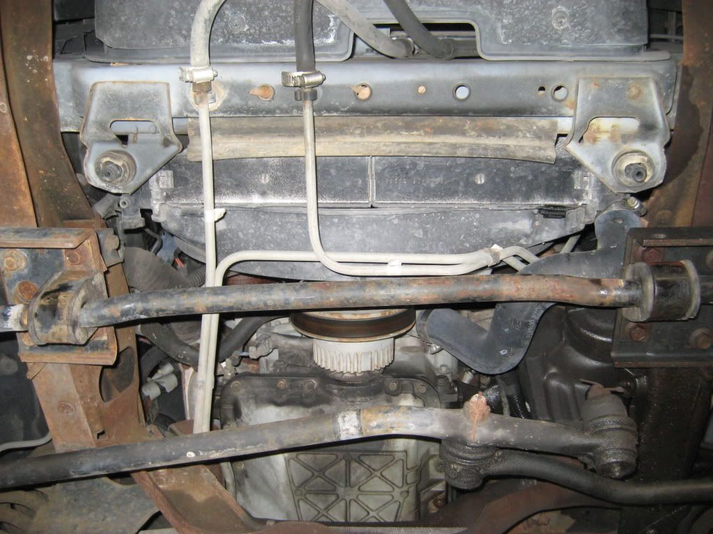

i do have a poping noise that comes when hard turning. it is not a cv joint. i looked and found that one of the brackets for the sway bar was totally bent to shit. i thought it was broken, but i took a wedge and bent it back to normal posisiton. the sway bar seems to not be totally straight and the thing that connects to the swaybar (looks like a tie rod) is not positioned the same as the one at the opposite end.

heres pics :
the okay one
the bent one
the difference
the main thing i'm concerned with is the steering/veering/braking issue and i didn't want to leave out any detail on what is an issue.
