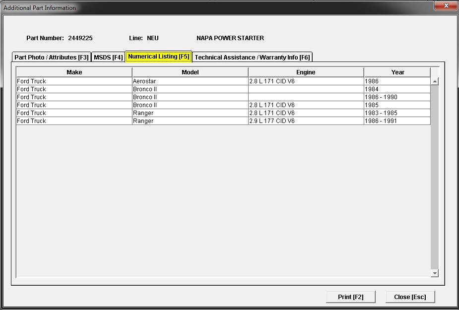

They show the same starter from 1983 - 1991 for both the 2.8L and the 2.9L. The problem I had with my starter was that the threads in the bell housing were stripped out. So I had to drill the holes through, use longer bolts, and grind down some flange nuts to fit on the back of the bolt.
