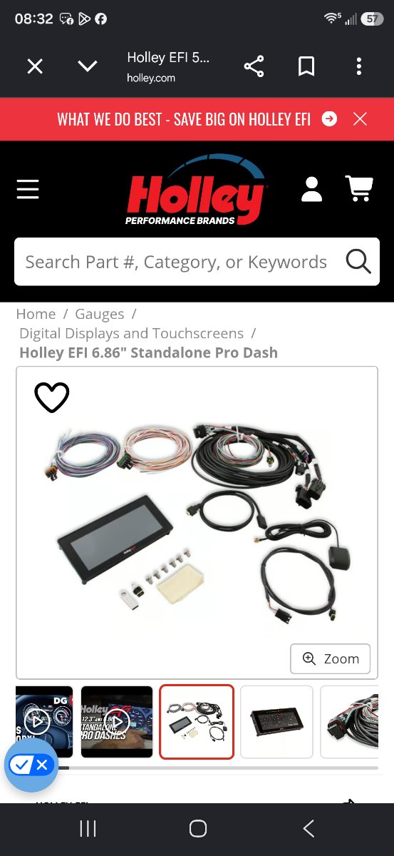

This is what I chose.

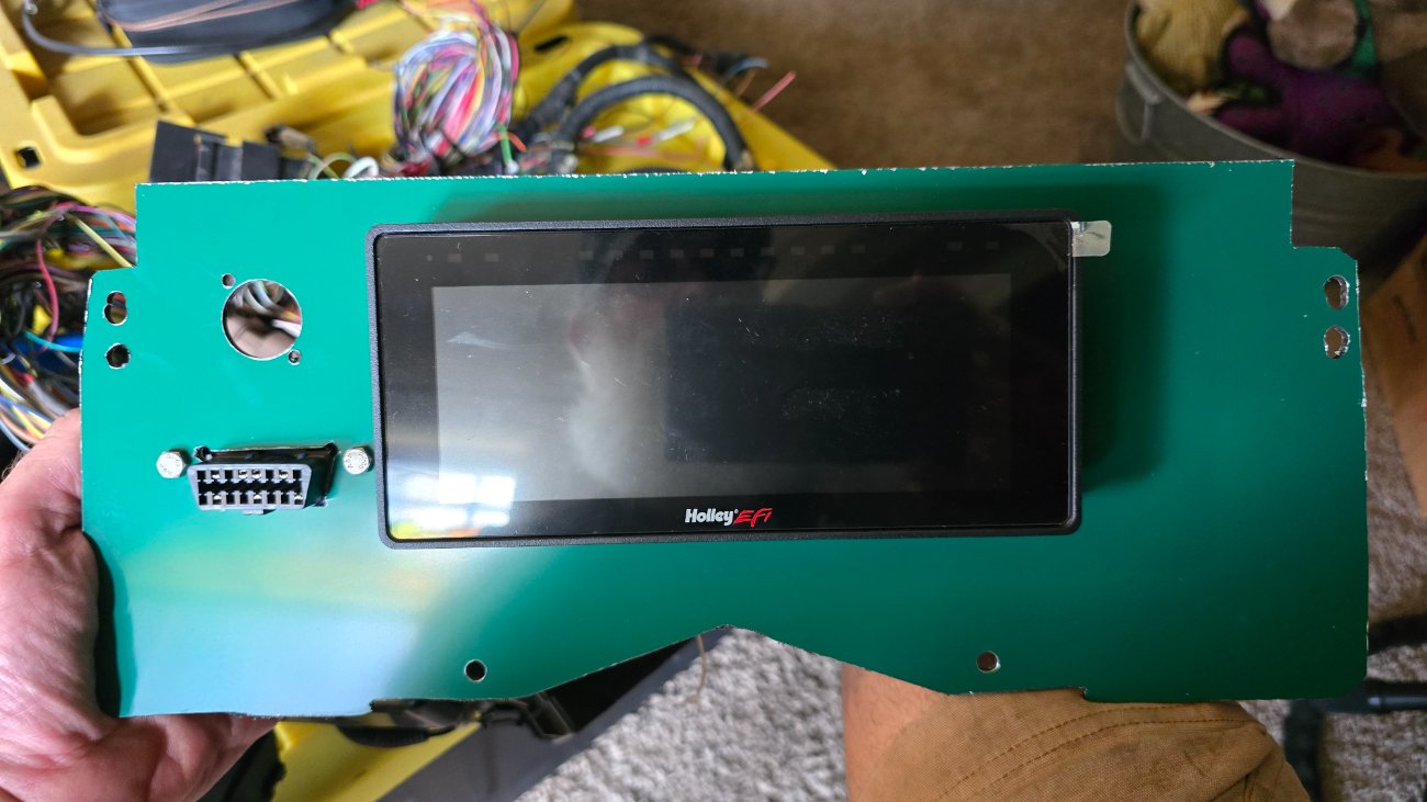

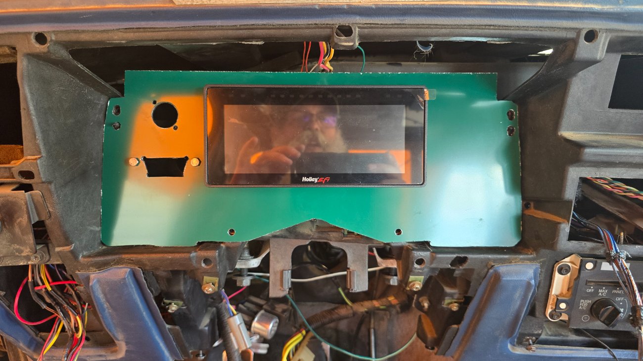

I made a flat panel to hold the holley dash, OBDII port and usb ports connected to the Holley dash.

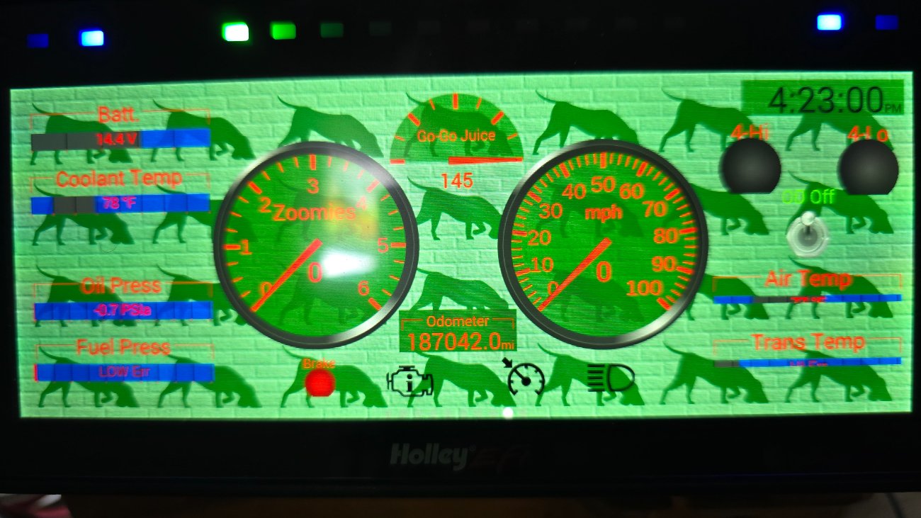

You can even add custom background images. I'm not going to use this one. The Holley dash comes with a bunch of background images or "skins" you can choose from. Even skins that look like famous sports car dashes.
