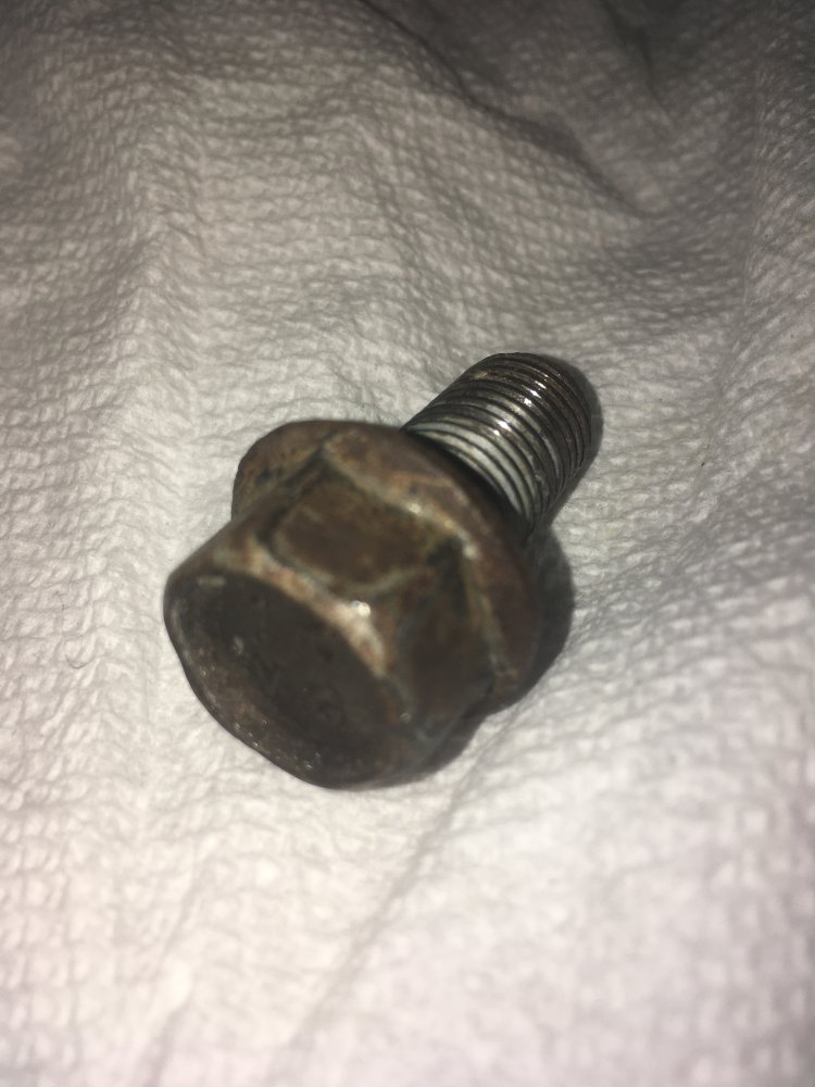

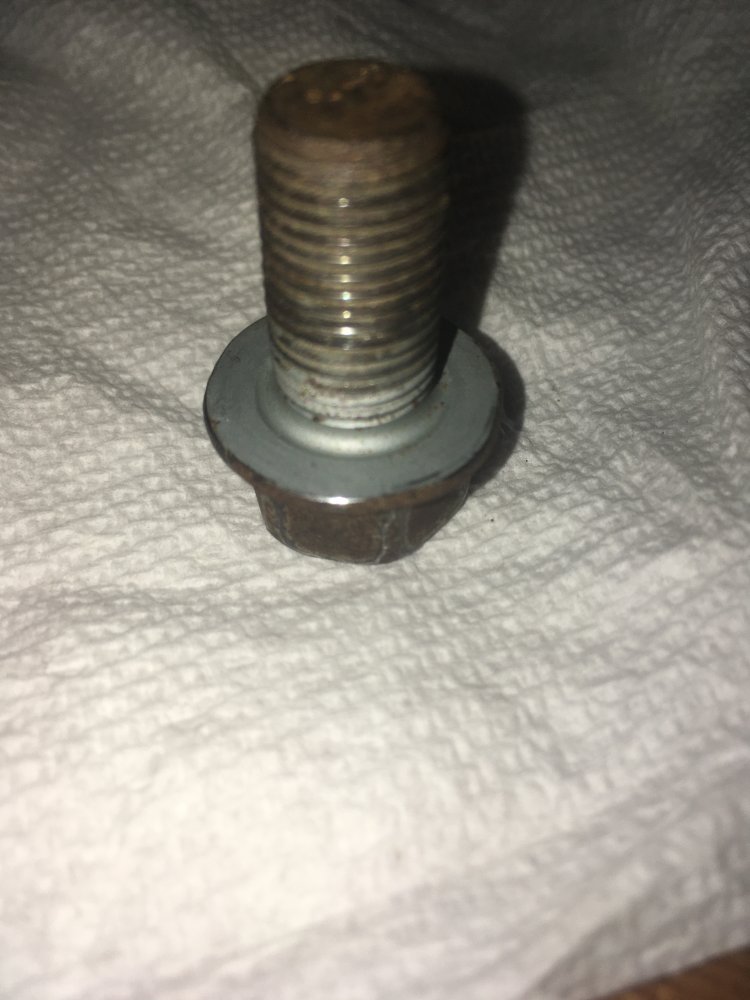

Stainless is super soft, but Body mounts don’t get they much regularly applied force on them. Probably would be fine, but I wouldn’t use ss for them anyway.
paint the bolts before installing. Use ricks patented method of thinned out rustolem, then full strength rustolem after everything is installed.
should get you another 20 years out of ‘em.
@Roert42 (clearly a man of great intelligence, discerning analytic qualities and a good judge of character) has the correct and simplest solution. Coat everything with thinned out Rustoleum, put it together and tighten it all up, and then bathe the exposed parts with full strength rustoleum before the thin stuff cures.
A few more points. If you use a high nickel bolt, grade 5 or better, they last a little bit longer akin to cast iron for the same reasons.
I think someone said etch the bolts. The cleaner the microscopic surface, the better the rustoleum will adhere and penetrate. I always keep a jug of muriatic acid for such things. Soak them overnight, rinse them with cold water, and then rinse them with a very mild vinegar solution to return the pH to balanced. Dry them with a heat gun, or let them sun dry over a good bit of time and then slap them together.
