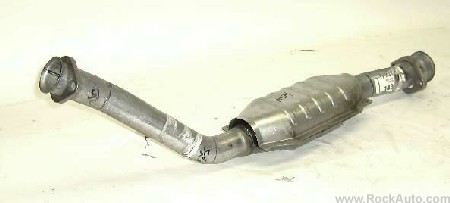

If it's a older style engine, looks like you will need a pipe with a flare, much like a brake line. Here's a picture I found of it. Can you flare a pipe? The exhaust shop may be able to flare it, but they may not like messing with stainless.
It's for a 2.3 in a '96.
So something like the above link should work correct? I just measured the pipe that comes off the header and it was a hair over 2".. 2.15 or there abouts.
