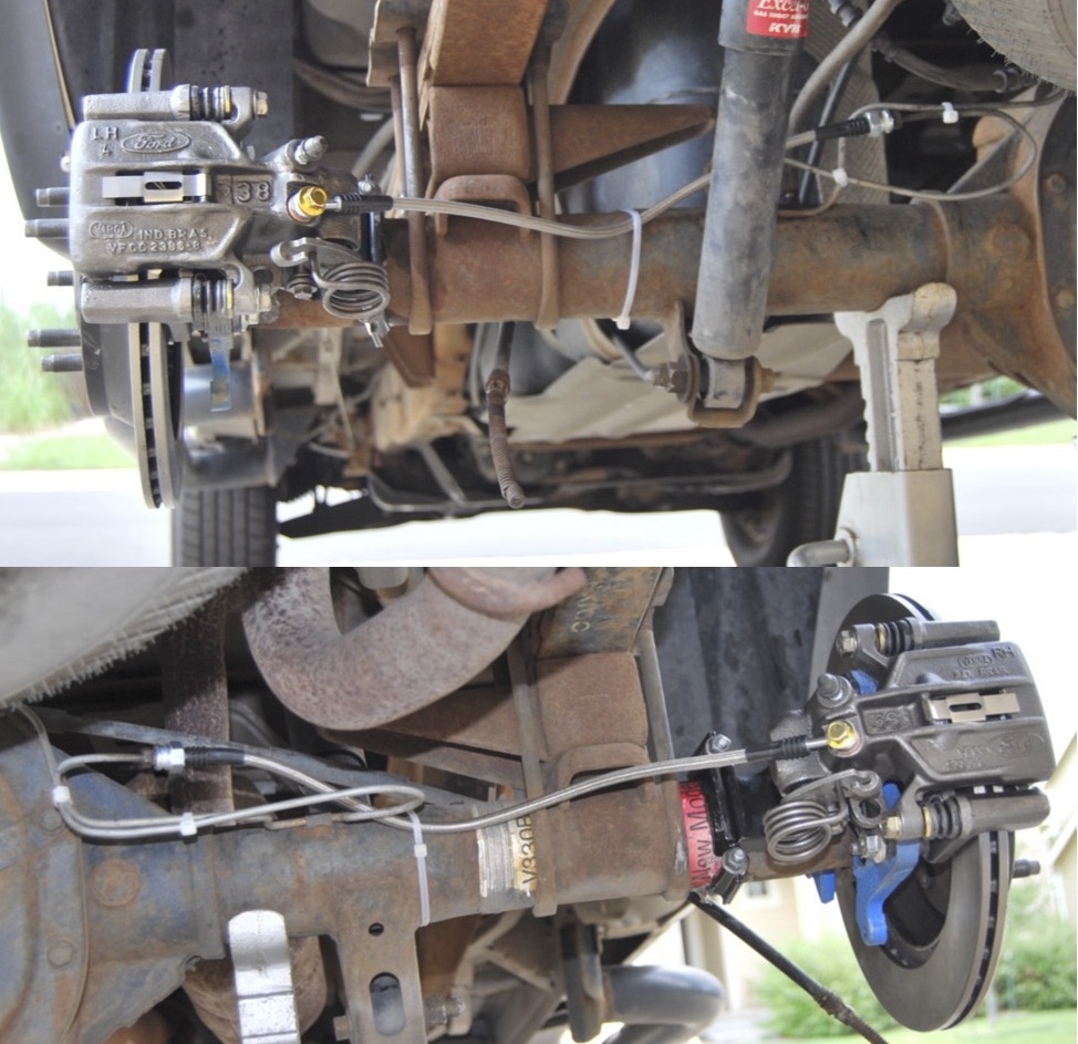

Try SpeedwayMotors.com. That's where I found these when I did the Mustang rear disk brake upgrade to my '02 Ranger. Part of the problem may be that the Ranger, at least my '02 uses inch rather than metric brake line fittings.
