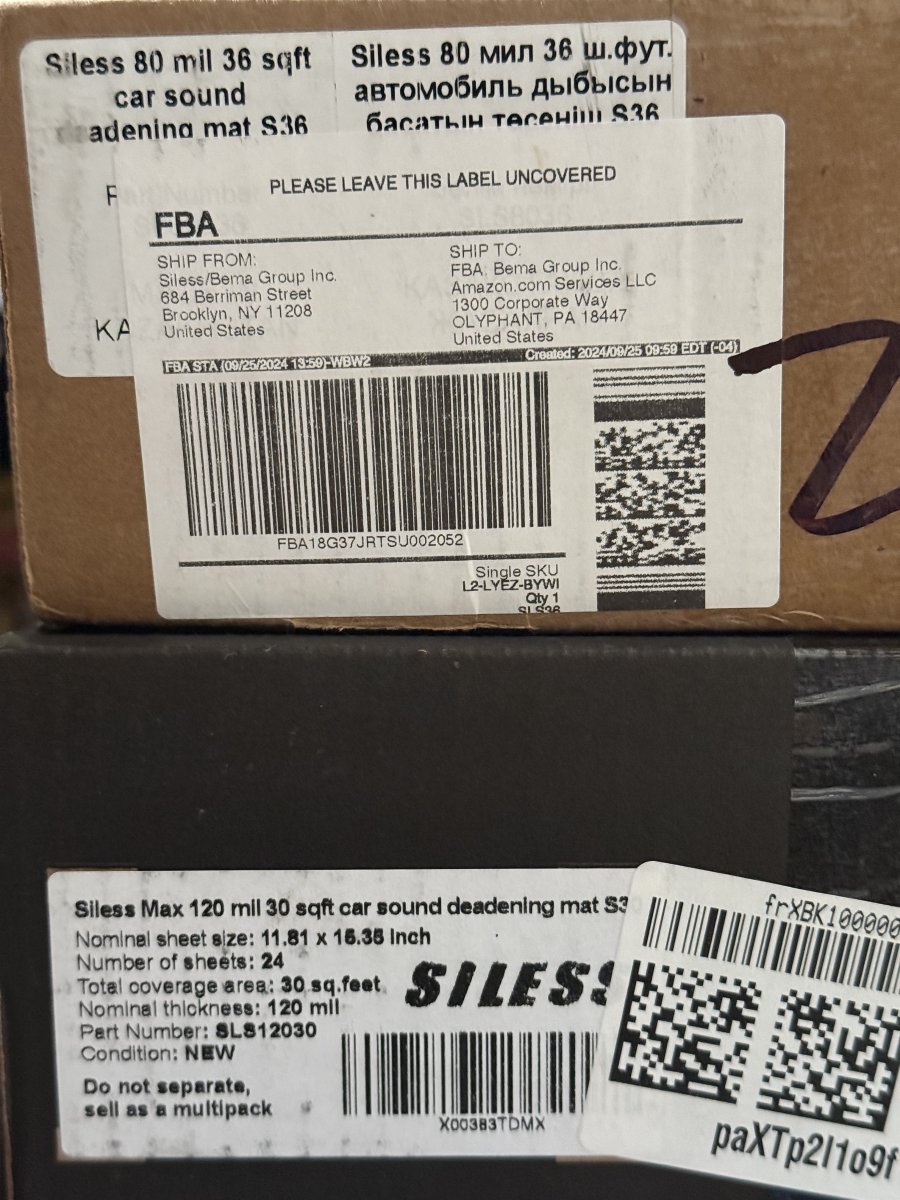

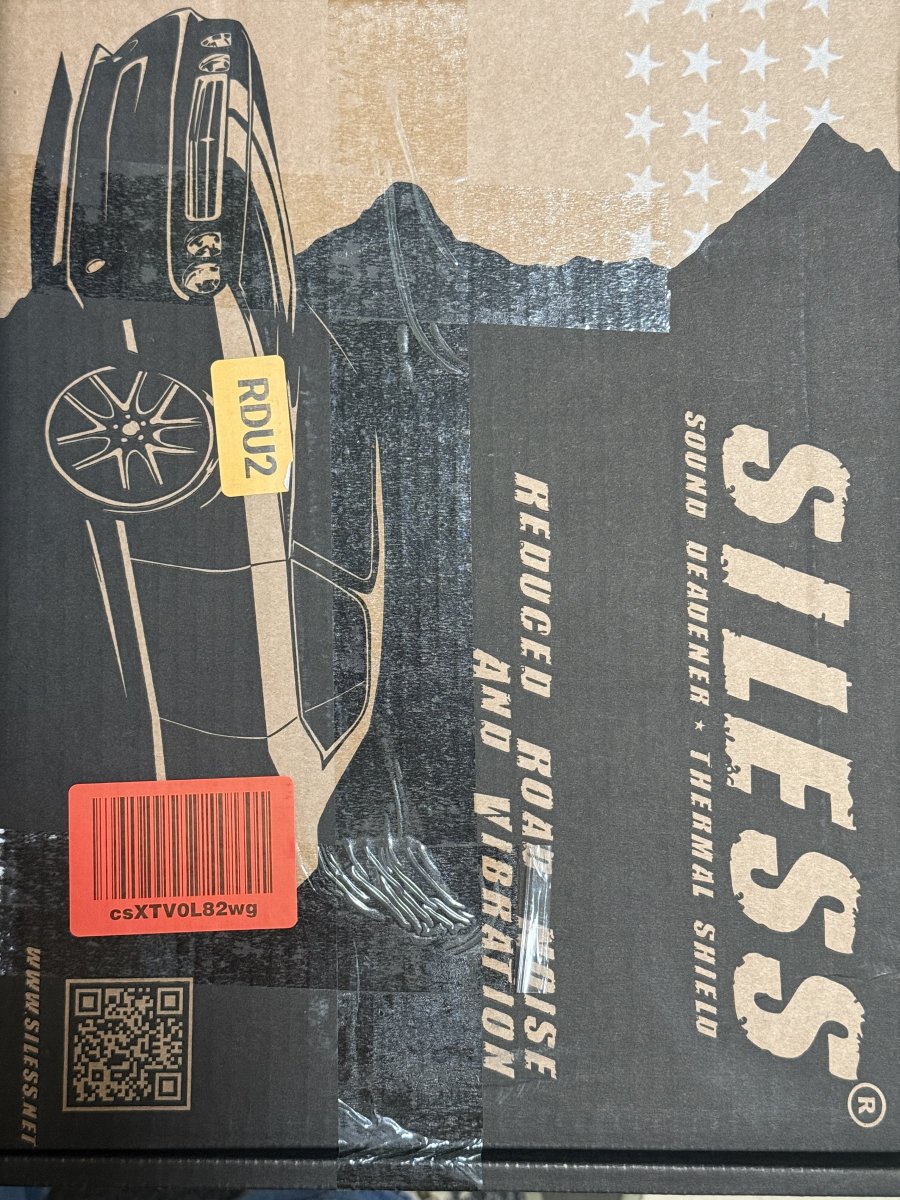

I bought a couple boxes of Siless sound mat, one 80mil (2mm), the other 120mil (3mm).
Sound deadening material
Since I've never done any "dynamat" work with a Ranger before, does anyone have any tips? I am planning on replacing my front and rear speakers along with the headliner at some point. Basically, soon I'll have access to all the nooks and crannies in my'98 SuperCab.
If anyone has any experiences or tips they'd like to share, I'd appreciate it. Thanks, everyone!

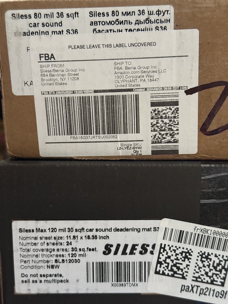

David
'98 SuperCab
