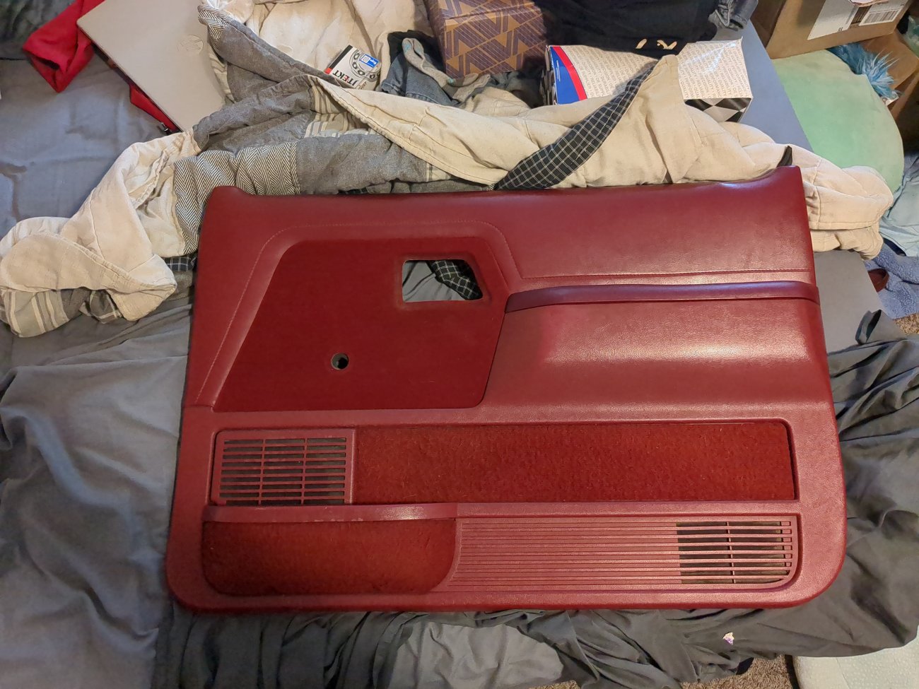

Obligatory picture of the door panels (at least one of them)
