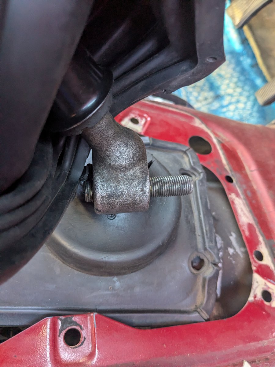

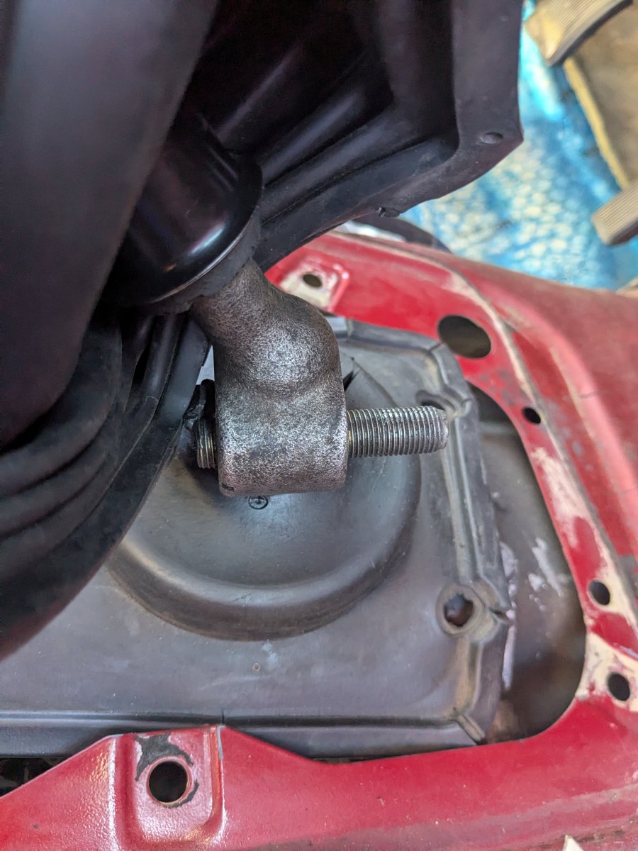

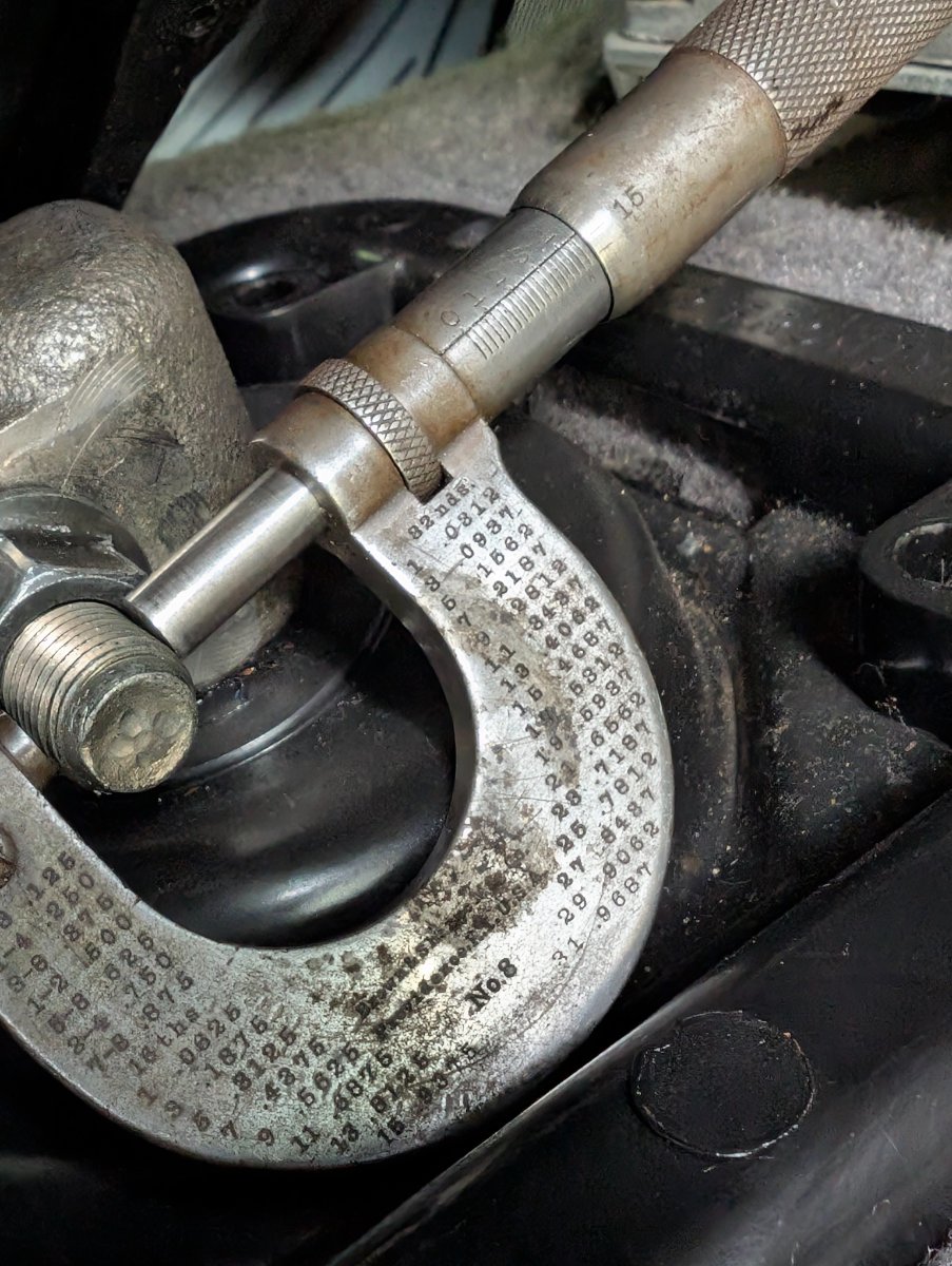

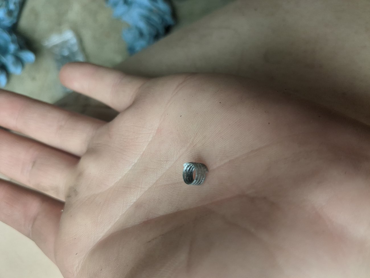

Is there a possibly someone knows the thread specs for the nut that was kindly missing on my truck?
M50D
Soul crushed and seeking advice on starting problems
TIA
For some reason I can't get it to let me pick what I want to for my like.
I'm sorry I don't know the answer for that one..
I will inquire. It looks like they also do like A/C services and such so asking to physically work on the vehicle seems within reason.
Also because I don't want to spin up a whole thread just for this..
M50D
TIA
I'm pretty sure it will be metric. Measure the diameter. 8 millimeter is M8
Count the threads per centimeter. Then divide that number into 10. Say you count 8 threads peak to peak. Divide 8 into 10 gives you 1.25.
So that imaginary bolt is an M8 x 1.25
I got .466" which is probably 12mm (.472") It looks finer than 12x1.75 and might be 12x1.5. My thread pitch gages are at work but I'll look for a 12x1.75 nut to confirm it won't thread on
