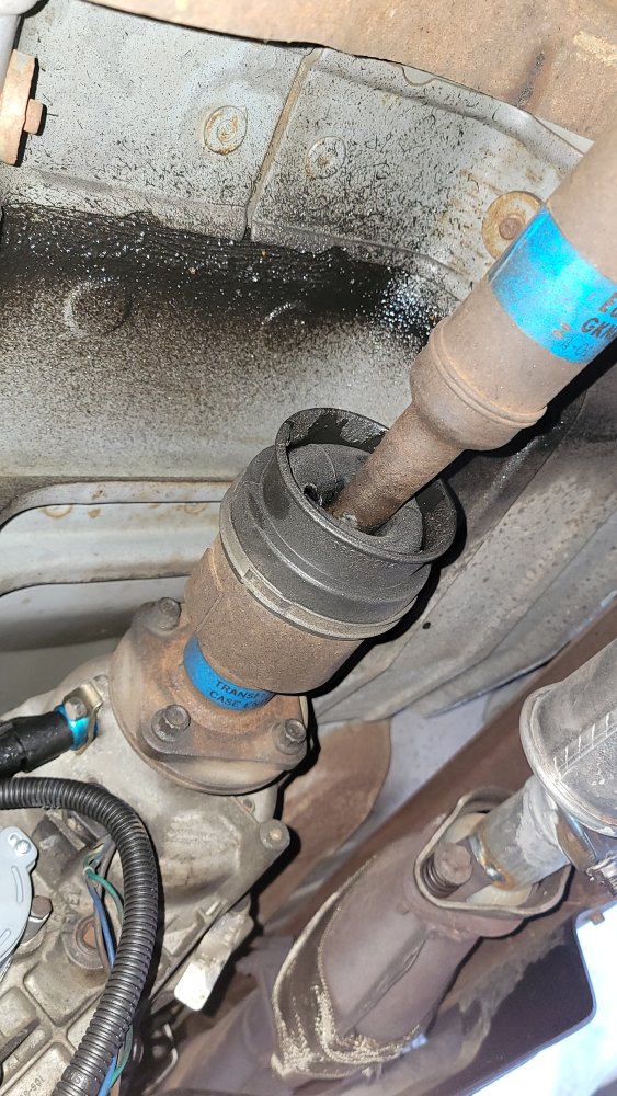

Hey there. 1990 Bii project trying to get to body restore but I'm having 4x4 and apparently transfer case end issue.
If you check the attached photo, it appears that I have a leak at what I assume is the rubber piece and it's spraying my undercarriage something fierce.
Any idea what the part is that I need to fix this thing up?

That looks like a grease boot for the driveline. With the grease spinning out you will need a new boot.

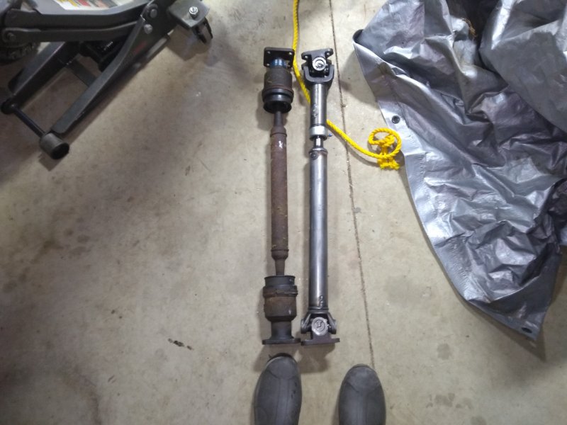

Rock Auto had replacement shafts. I would check there.
You need a flange to flange driveshaft. They have been making replacement shafts for your style for a while now.
Measure your current one, as long as the length is the same the one you linked will work.
I bought mine from Jeffs I think, cant remeber. I took out the cv shaft and put the u-joint one in in about 10 minutes.

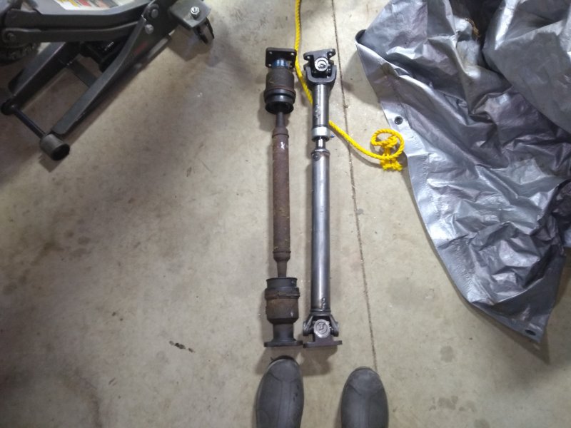

I bought mine from Jeffs I think, cant remeber. I took out the cv shaft and put the u-joint one in in about 10 minutes.View attachment 73320

Oh yeah, mu cv shaft shuttered under load. New shaft worked wonders. Plus consider that every busing in that truck probably shot. Leaf spring bushings, sway bar bushings, bidy mounts, etc.
