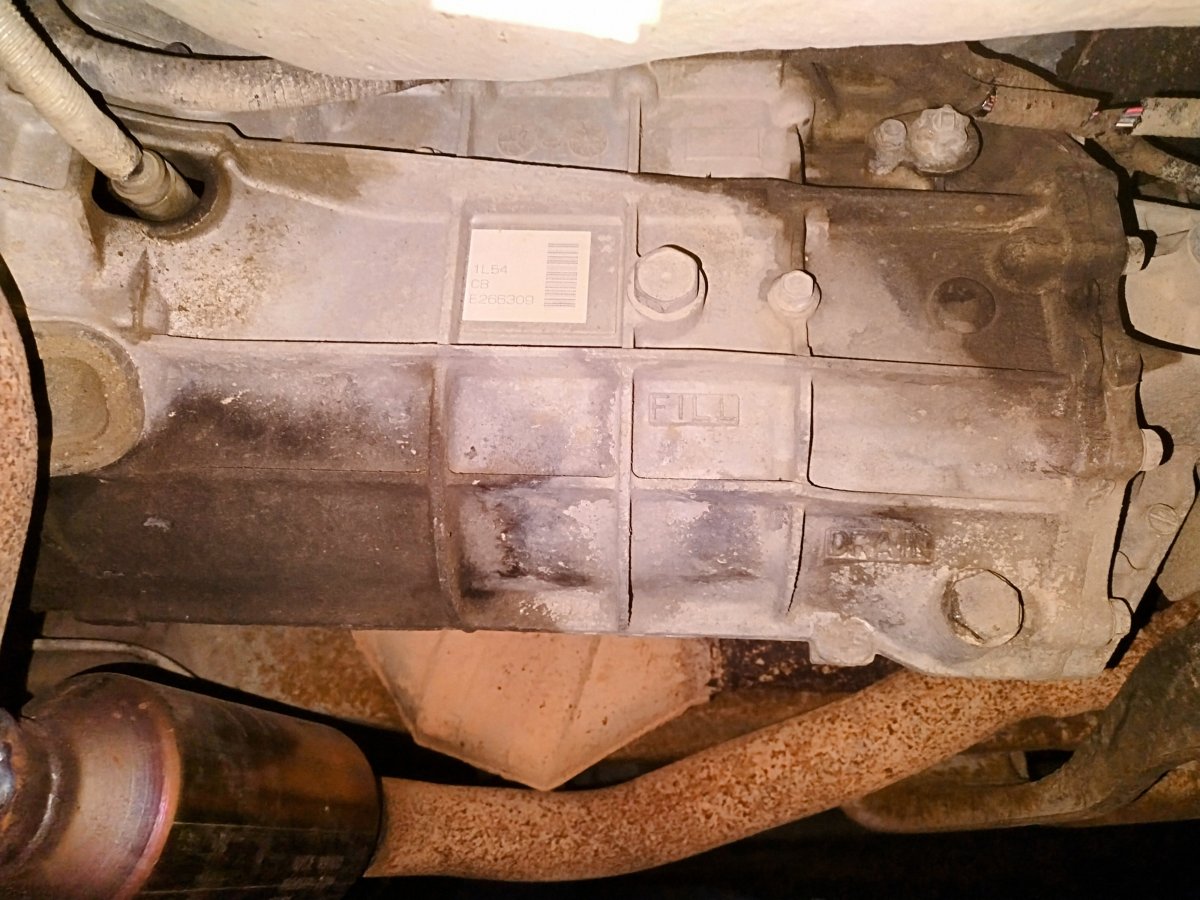

Okay here are some pictures of what I'll be messing with, first one of the bottles there's two pictures of my transmission it seems to be weeping on opposite ends, no dripping or spotting anywhere I park or drive so that's 👍

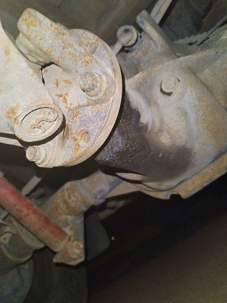

There is also something new I found, one of the pictures is right at the end of the driveshaft right before the rear differential? Or maybe it's the torque converter not sure but it's also weeping, again no spots.

Your leak at the rear axle looks like the pinion seal leaking. Unless it's dripping or getting all over the place, you can let that one go for awhile. Just be sure to check the fluid level every 5-10K miles or so.
Back of the transmission is likely the rubber shifter rail plugs. Easy to change, but access might be difficult. Left for too long though may lead to enough fluid loss and the trans getting ruined (this one usually doesn't show a drip since the fluid loss only occurs while driving). Suggest you inspect those right away.
(some info here).
Up by the engine could be a few different things: engine rear main seal, input shaft seal, clutch slave cylinder. A good mechanic should be able to identify which kind of fluid it is (indicating which of those are leaking).
(some info here).
