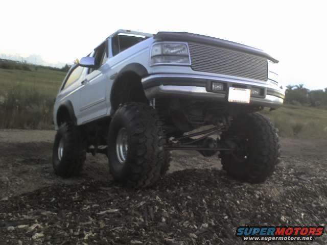

I used a dana 44 waggy axle. I think it is perfect. It is a few inches wider then stock and the pumpkin is over far enough that you clear the engine cross member. Allows for less lift and still a good amount of up travel.
So.....here's a wrapped up version of my truck, with bumpers/sliders, fiberglass fenders and hood etc to come...
