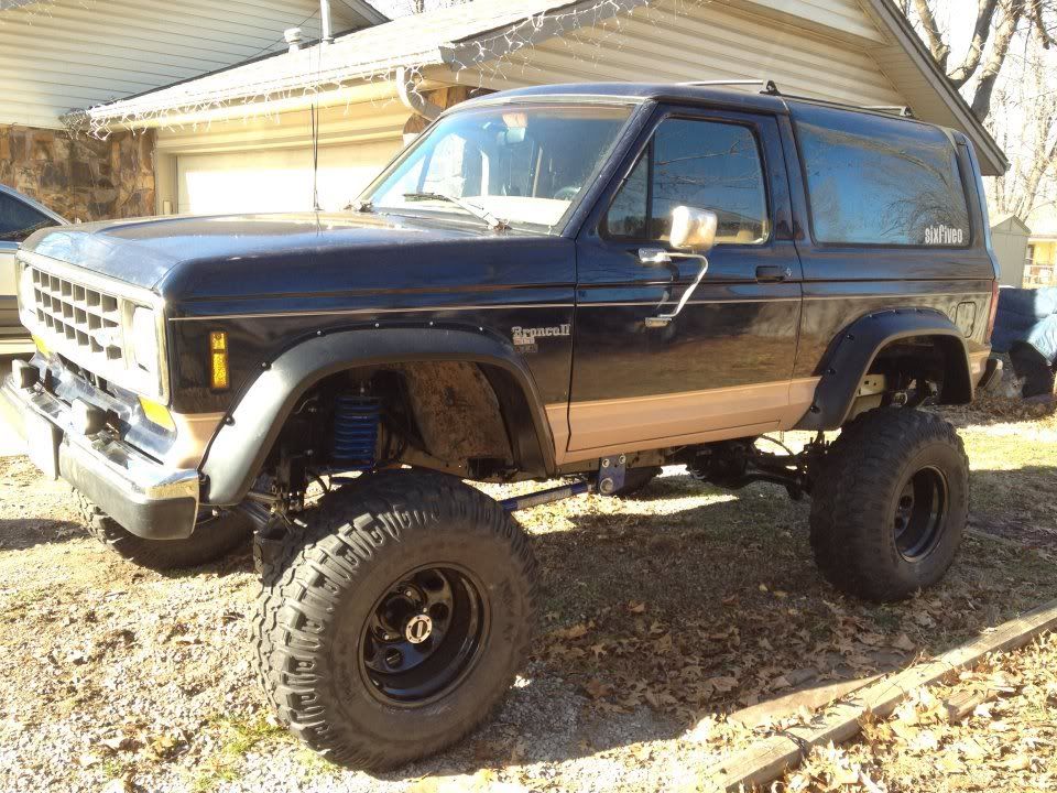

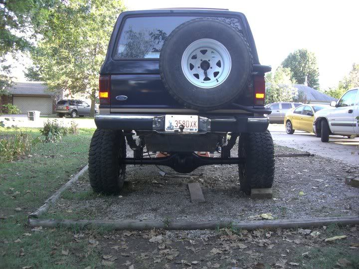

44/60 -- waggy width in front, J-20 in the rear. 5:13 gears, ARB front, lincoln-locked rear.
Front axle is located about 8" forward in the frame w/relocated steering box and 1.5" .250 wall DOM drag link, crossover, and track bar w/1 ton TRE.
I'll get the latest round of pics uploaded. Quite a bit of progress since I snapped these. Truck is just about ready to roll. :icon_bounceblue:
