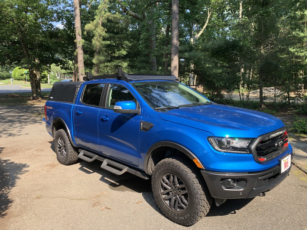

Snoranger’s 2023 Ranger Lariat Tremor
hell yeah....

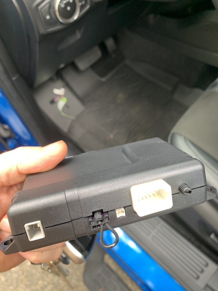

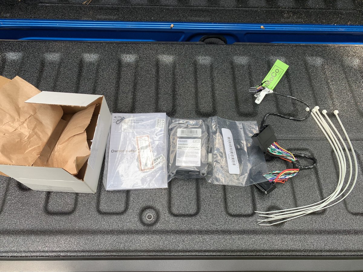

The one option I’ve used on all my trucks has always been remote start. The 500a package doesn’t come with it, but there’s no reason to worry. It’s one of the easiest things I have ever installed.
Here’s what’s in the box:
Module
Wiring
Zip ties
Other useless junk
Step 1:
Unplug the gateway module (OBDII connector) and plug the new harness in between the module and the truck wiring.
Step 2:
Plug the remote start jumper and the pigtail off the newly installed harness into the module.
Step 3:
Program the module.
This involves turning the key on and off, opening and closing the door, and starting then shutting the engine off. The instructions tell you exactly what to do… it’s not difficult.
Step 4:
Test the remote start. On the key fob, press the lock button, unlock button, then the lock button again… your truck should now start.
Step 5:

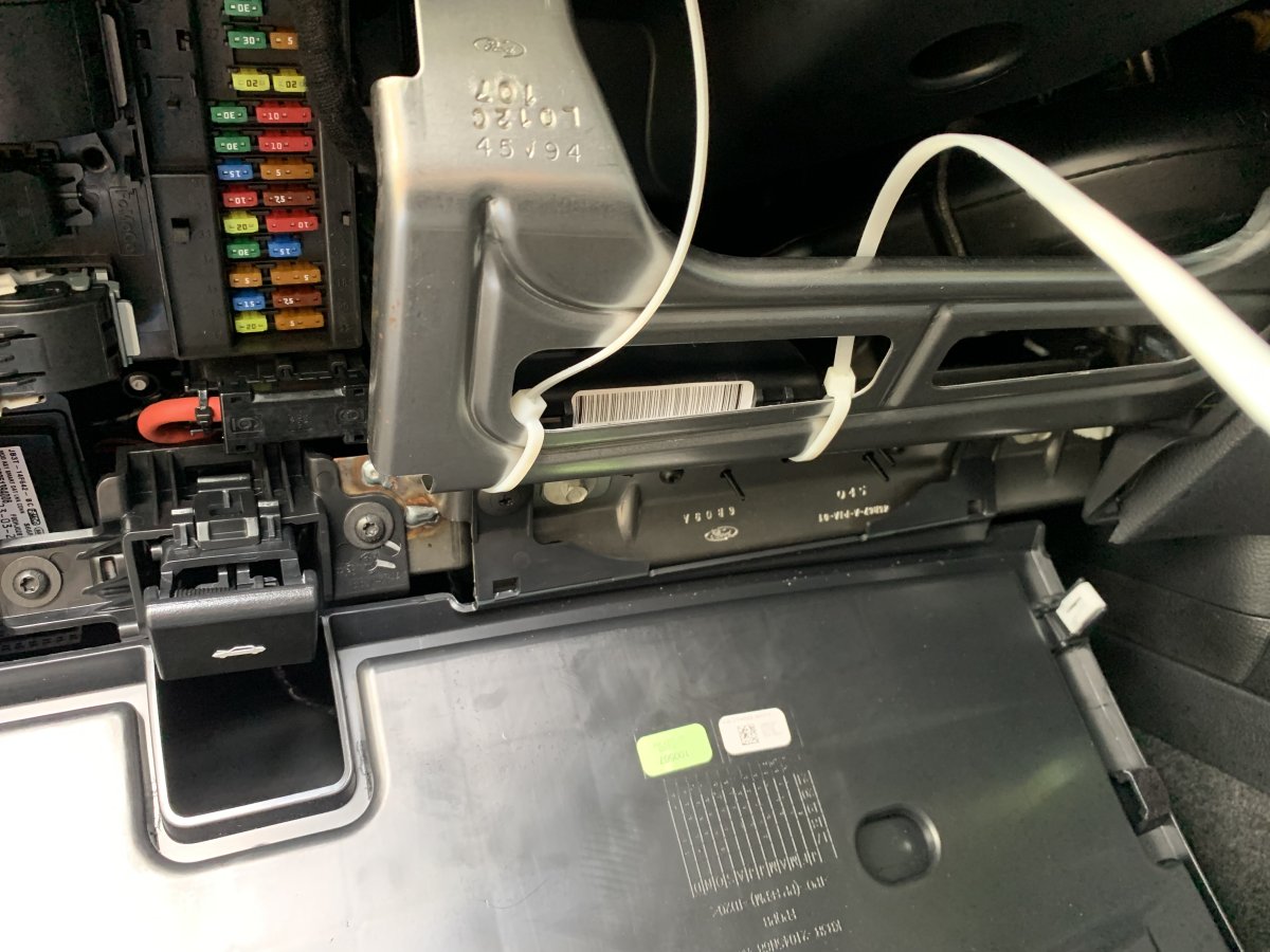

Mount the module up under the dash with some of the zip ties.
Step 6:
Install instruction key tag.
It took longer to go to the garage and get a pair of cutters to cut the zip ties, then it did to install and program it.

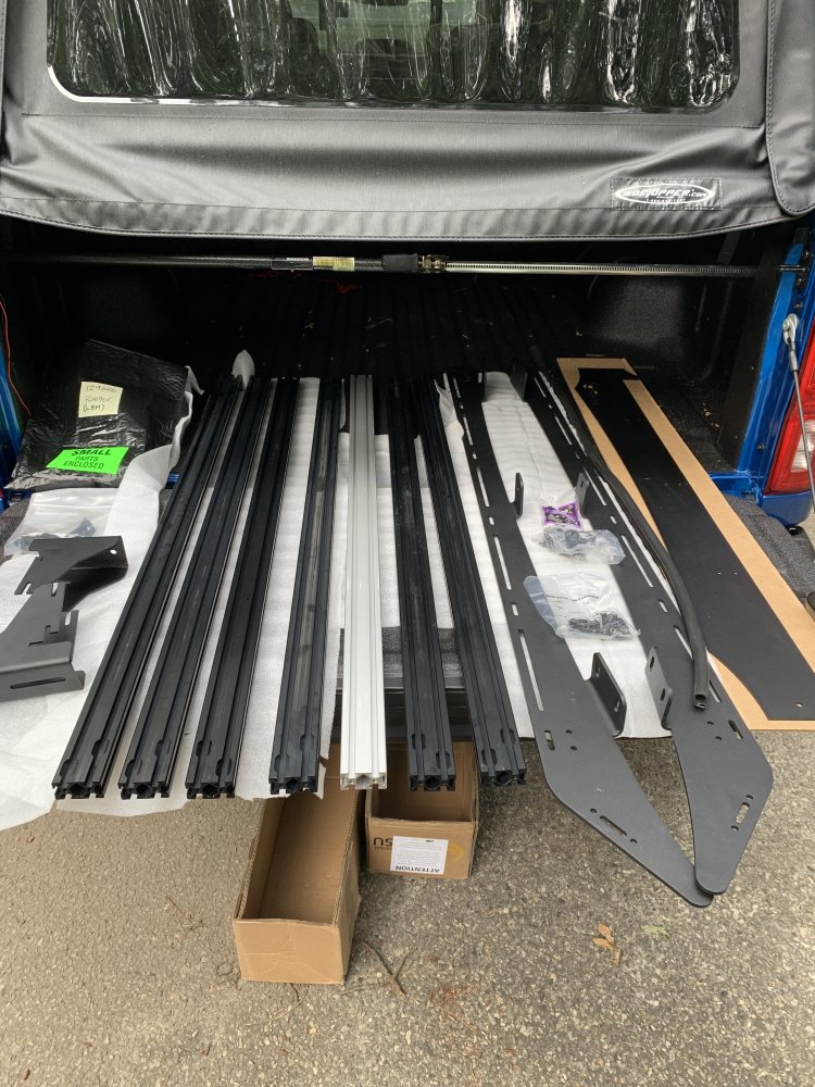

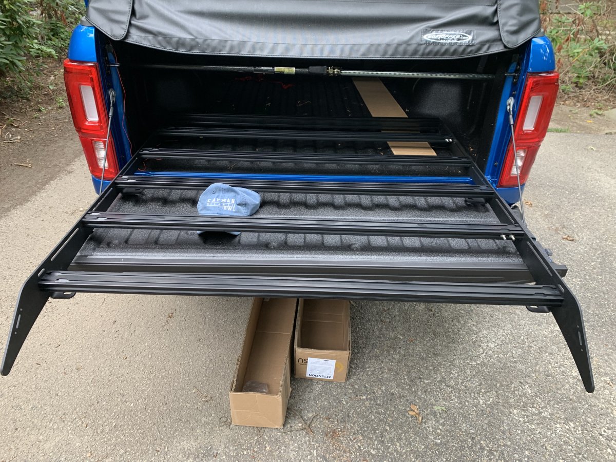

I went to install my Prinsu roof rack today. I tried to beat the storm the supposed to hit this afternoon, but that wasn’t going to happen. So I got as much done as I could before the rain hit. I figured it would be wise to NOT drill holes in my roof when there’s a thunderstorm in the distance.
So I built the rack, but didn’t install it yet.
Here’s all the parts set out and inspected for damage. The 2 brackets on the front left aren’t part of the normal rack, they’re an additional bracket I bought to mount my Smittybilt awning.
I’m still waiting for the 2 lighted handles to come in… I should see them around the middle of the week.
I figured since I already wasn’t following the directions I would start with the front air damn. For some reason that crossbeam is silver, not black… whatever.

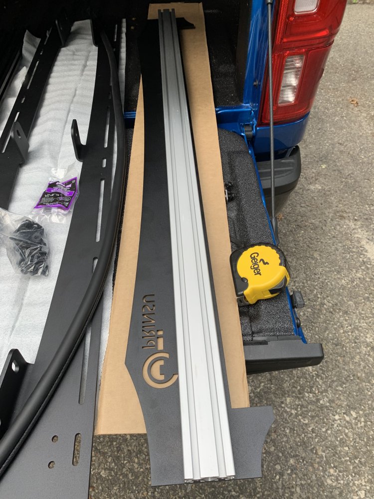

Next step is to attach all the crossmembers to the side plates.
This is the point where I stopped because of the weather. I’ll have to finish up later.

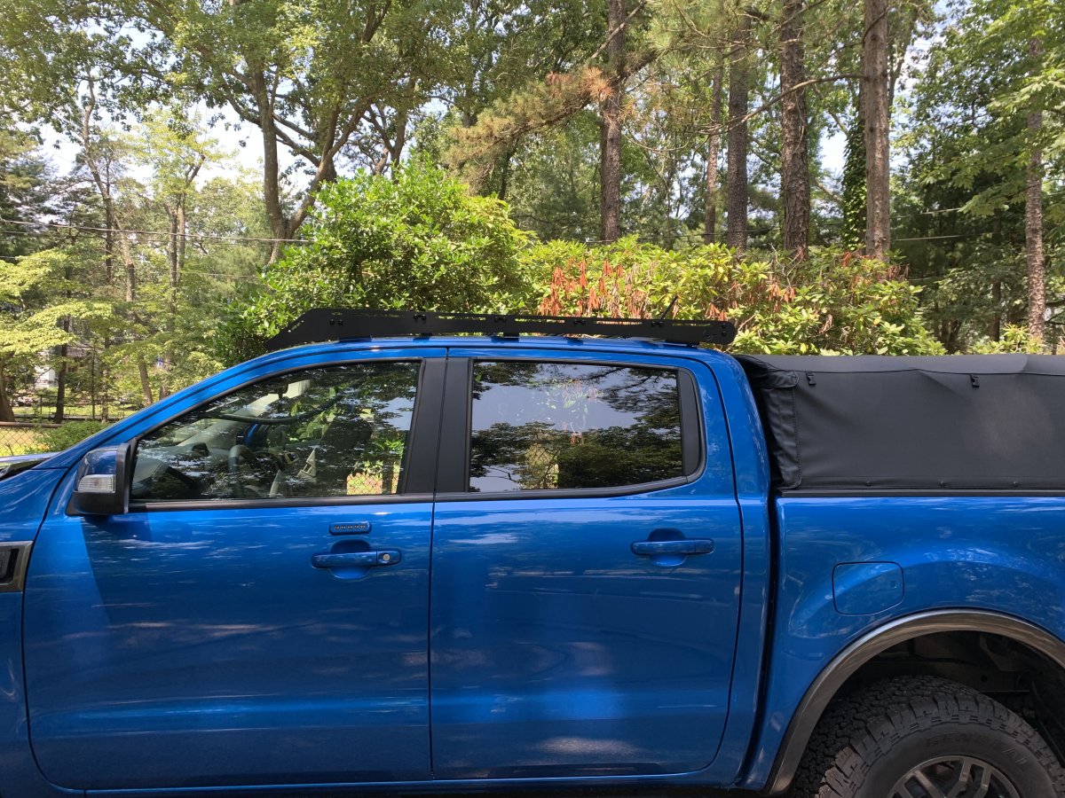

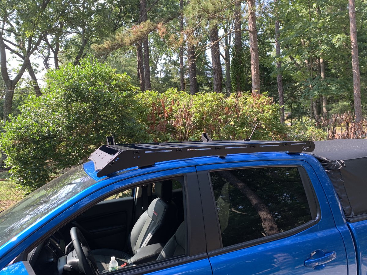

Since I had the day off, and it was 95 degrees, I stupidly decided today was a good day to install my roof rack.
Here’s a pic of the awning brackets.

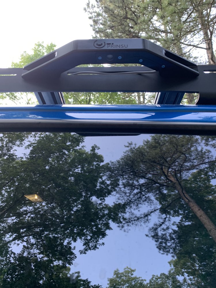

The lighted handles for the drivers side should be here tomorrow.

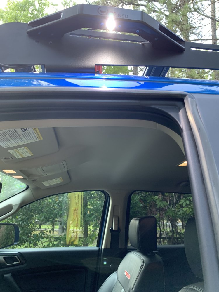

I like the rack, but I will never install one of these again. It was a pain in the ass. I had to drop the headliner to remove the drip rail trim. Then drill 10 holes in the roof to install nutserts.
The directions (online only, no paper copy in the box) kinda suck, I probably should do a write up but I didn’t take any pics.

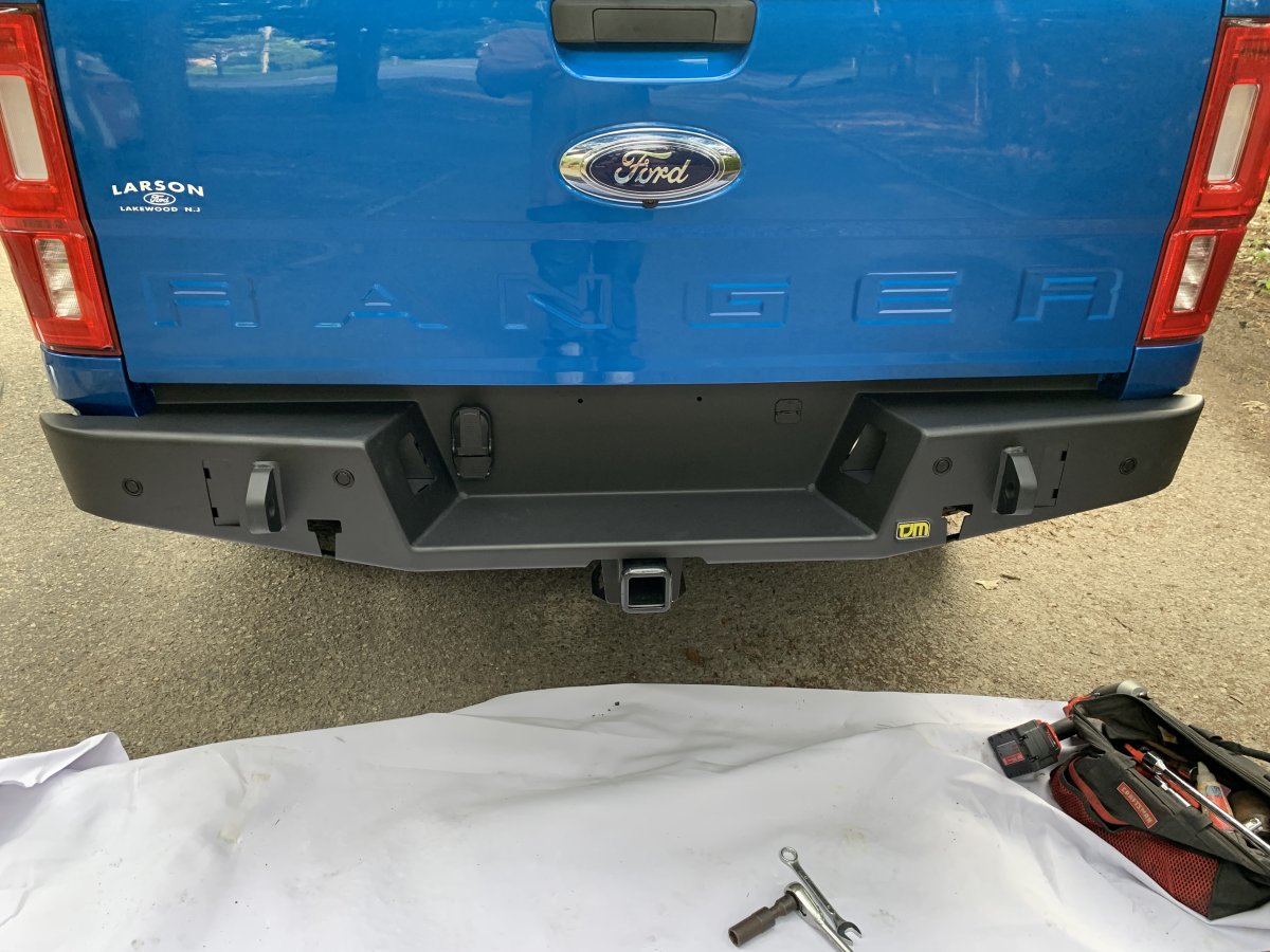

The first sign of quality is the packaging, and these are packed and wrapped to survive anything the delivery guy can throw at it. I only opened the rear bumper so far (I used the box for the front one as a workbench), but it’s fully wrapped in foam rubber and surrounded by styrofoam.

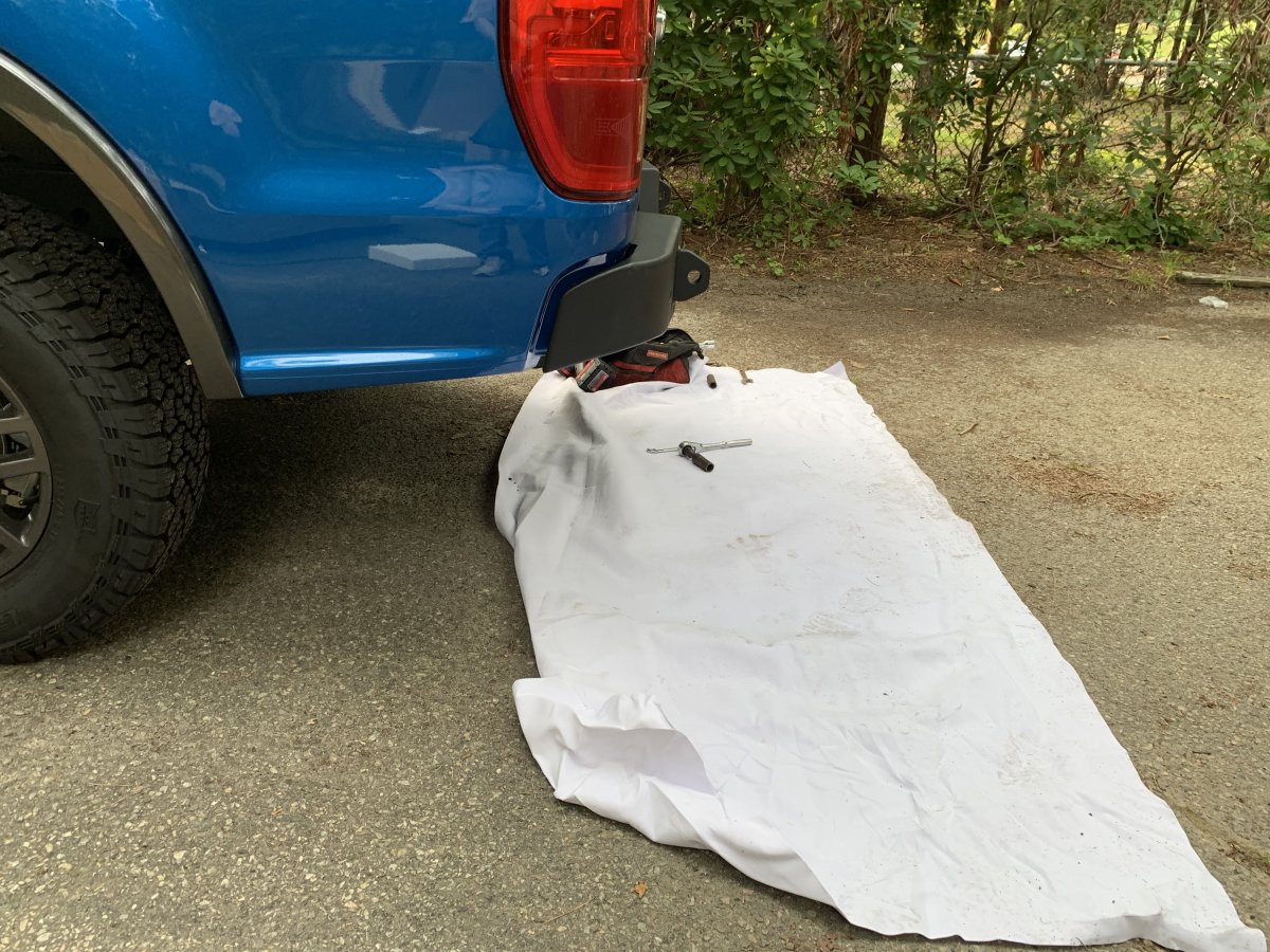

I don’t have any pics of the install, but you basically remove the old bumper, completely disassemble it, cut a few brackets off the trailer hitch (which is part of the OEM bumper), then install all that stuff on the new bumper before you install and adjust it.
I’ve owned TjM products before, and this is the same quality and fit I expected from them. Other than the issue I had ordering, I’d recommend them to anyone.

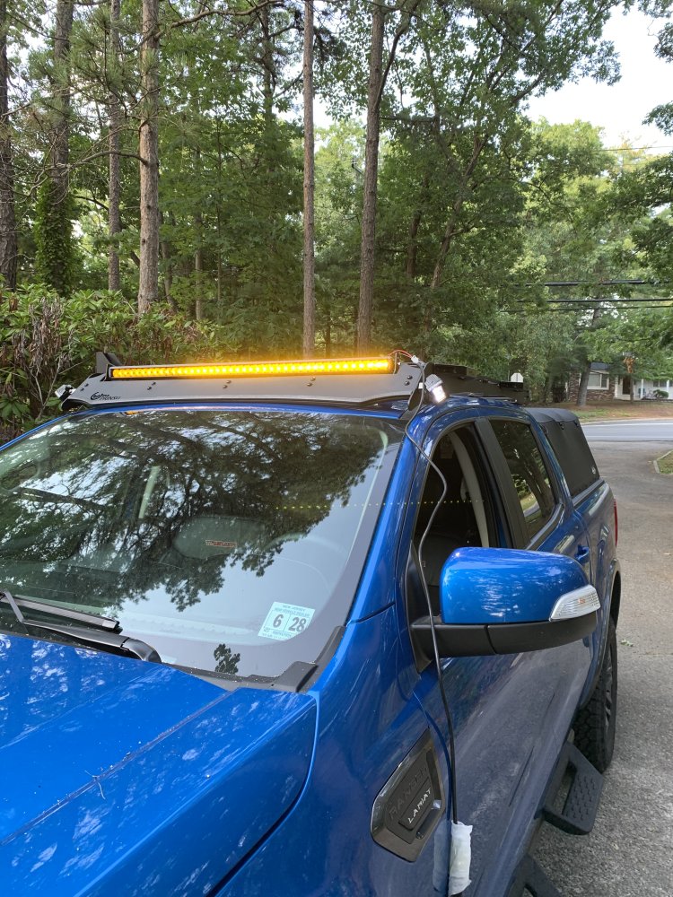

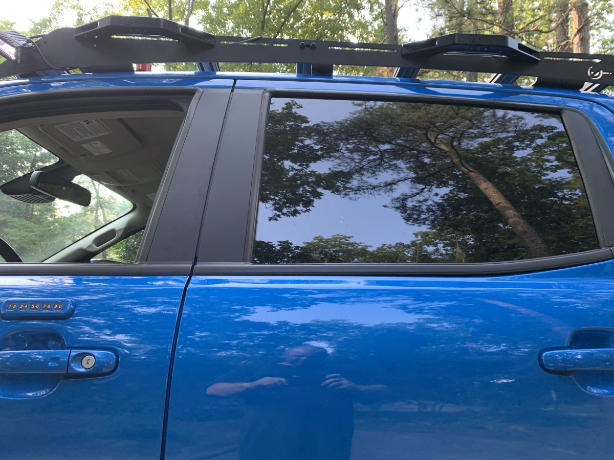

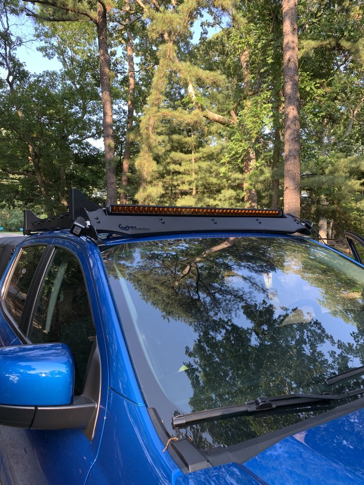

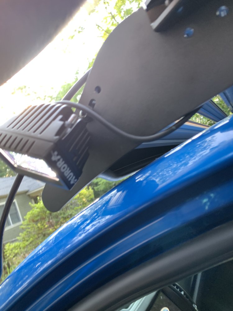

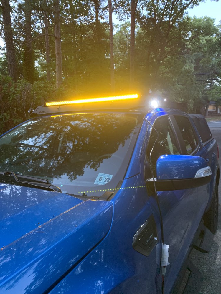

I installed the 40” single row amber light bar, a pair of scene lights, and the drivers side handles.
Here’s a pic of the lights on as the sun was setting.
I still have to run the wiring, I just rigged it up for testing and adjusting. The light bar and scene lights are good… the rear handle light started smoking when I hooked up power. That needs to get exchanged.

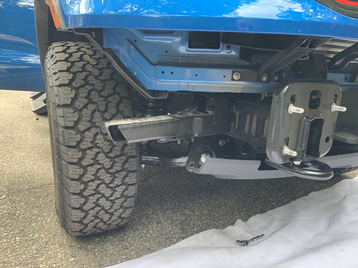

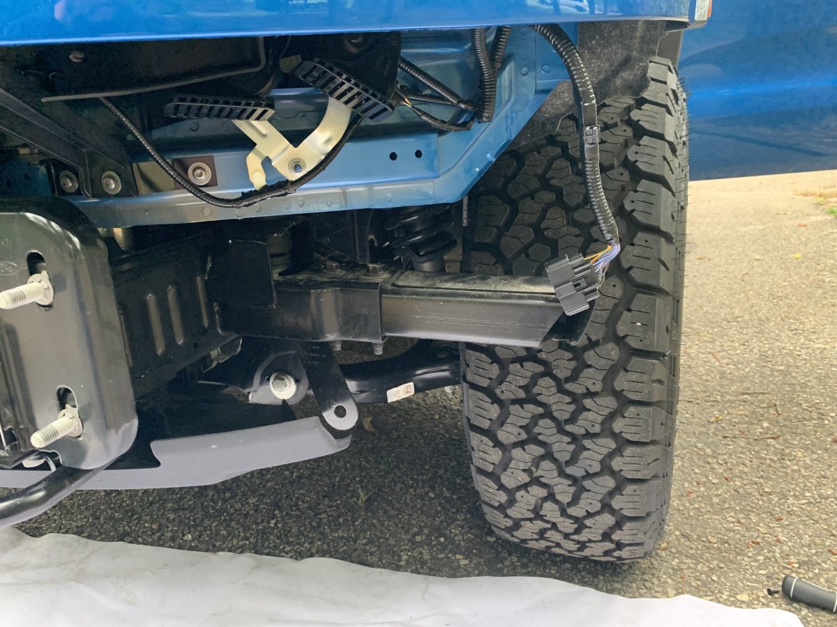

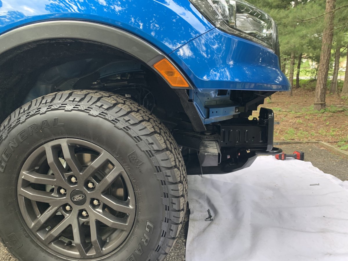

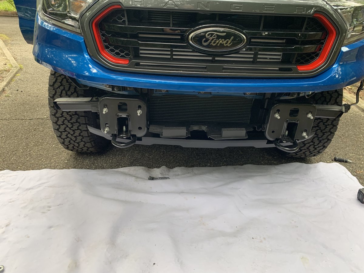

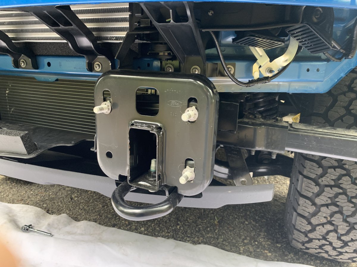

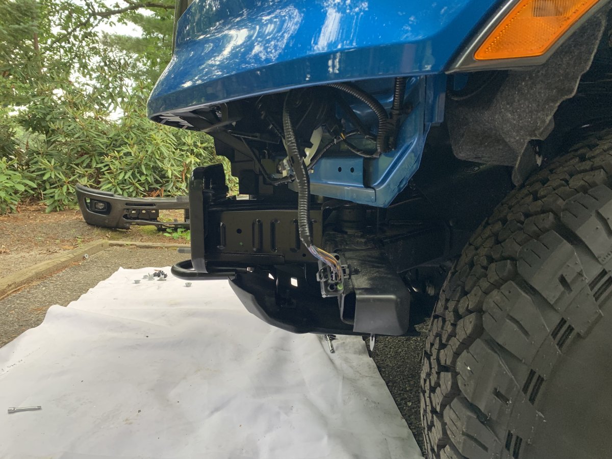

I started the install on the front bumper after work. I got the old one off and started assembling the new one.
In case anyone is thinking about building their own bumper (@Jim Oaks I’m talking to you) I took some pics of the truck without a bumper.
