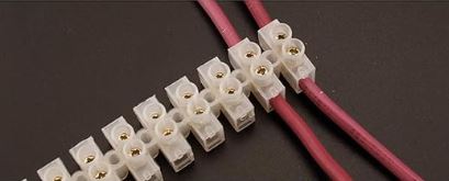

If it's just temporary, I'd probably tin the end of the wire and use a terminal block

Temp, but I'll still likely be driving around with it for a few months. Connectors are going to right near the cup holder area, so I think I want something a little more protected than that. Doesn't need to be weather proof, but that's just a little too exposed IMO.

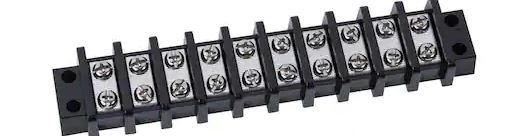

There's also this style, Dual Row Type H Screw Terminal Block
"If it's just temporary, I'd probably tin the end of the wire and use a terminal block"
Those are handy. But not so great for wires as small.as he is talking about. Though the connection can be made better and more robust by crimping ferrules in the tiny stranded wires. Ferrules keep the strands together and offer more mechanical protection when the terminal block screw is tightened. Soldering the ends of the wires does the same thing.
