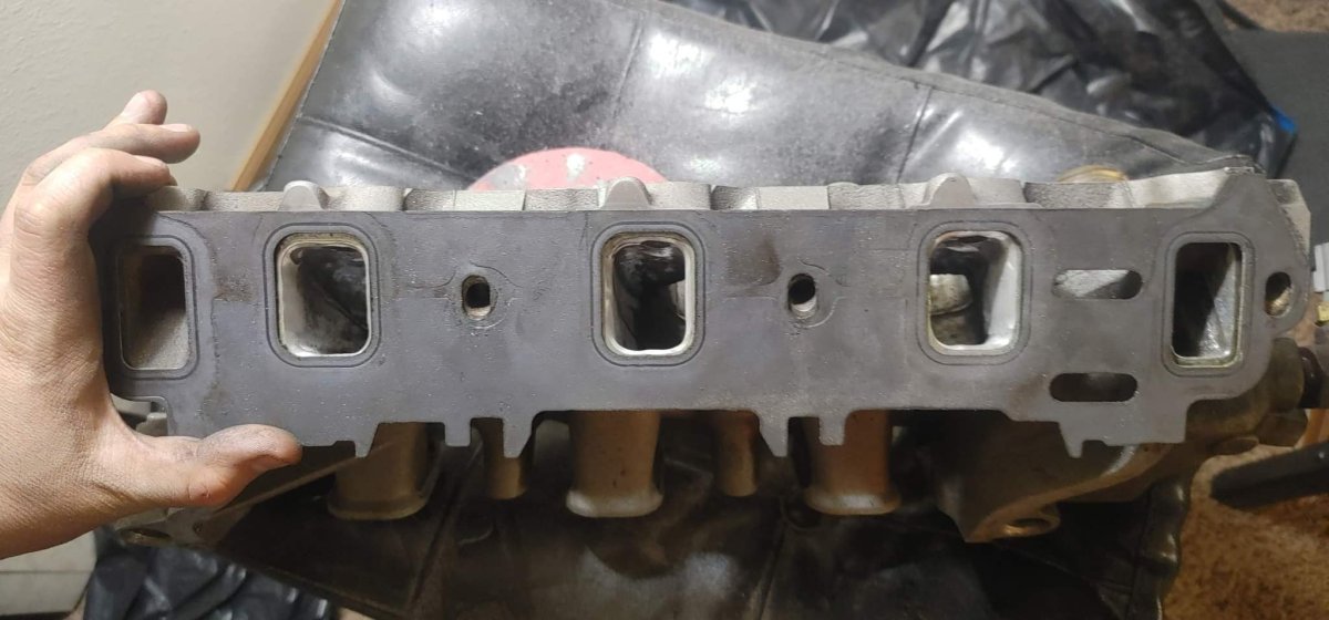

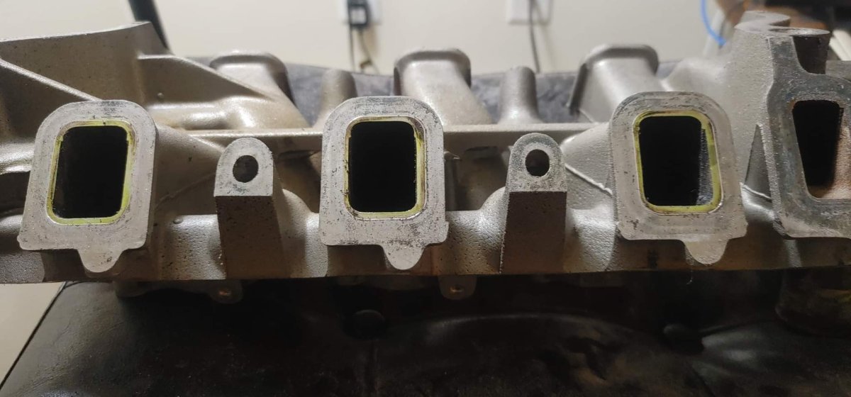

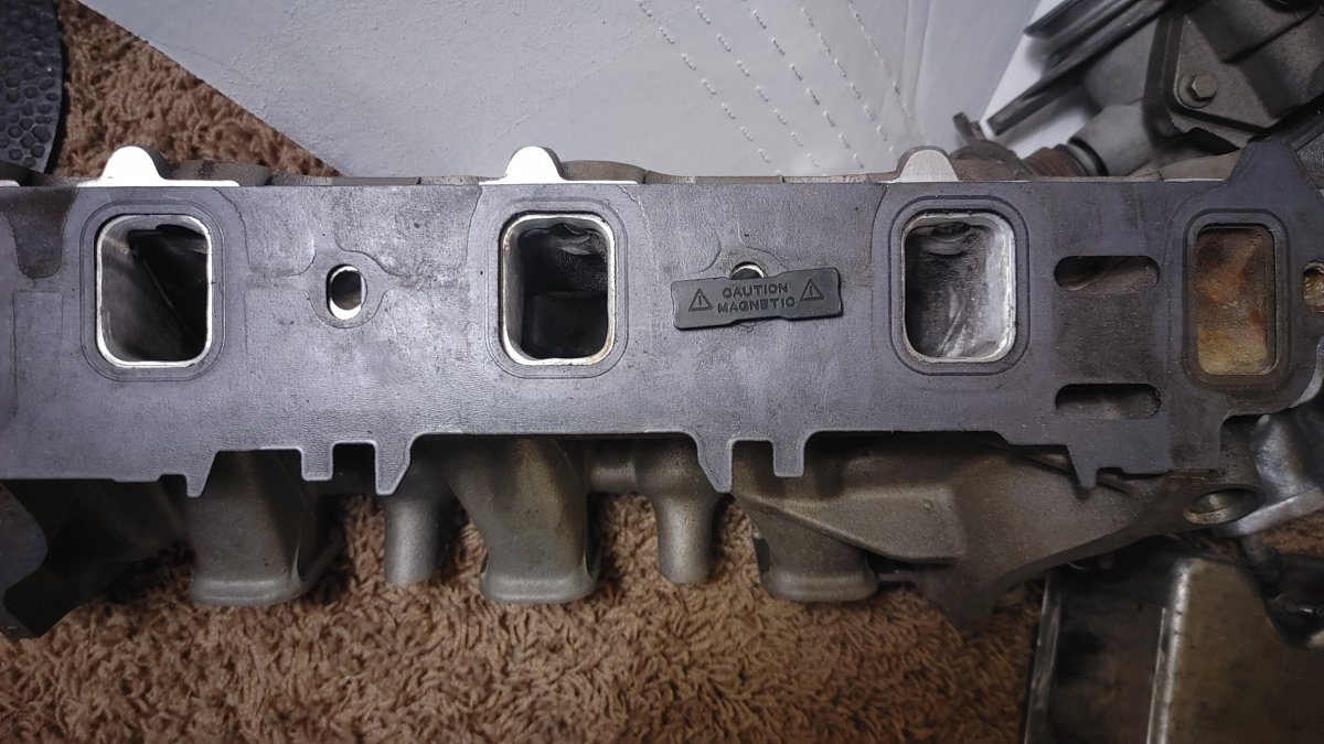

Placed the gasket on top with the bolts through centering it the best I could, etched the inside of the gasket and Marked the inside area with a highlighter
74656
Die grinder, sand paper rolls, sip of beer with aluminum dust in it, rinse and repeat, Kept placing the gasket on perpetually to check my work and this was the end result!
74663
Between gasket matching the head and manifold, 65mm TB mod, 1.7 rocker arms and the slightly raised compression I'm hoping to squeeze an extra 15-25HP out of it

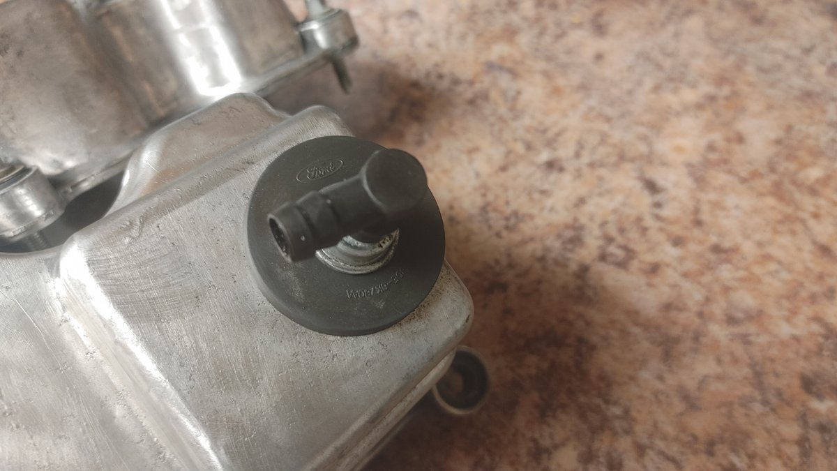

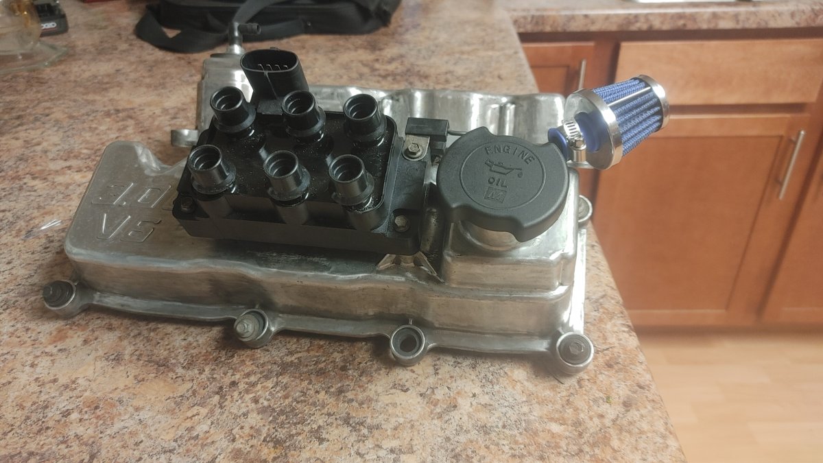

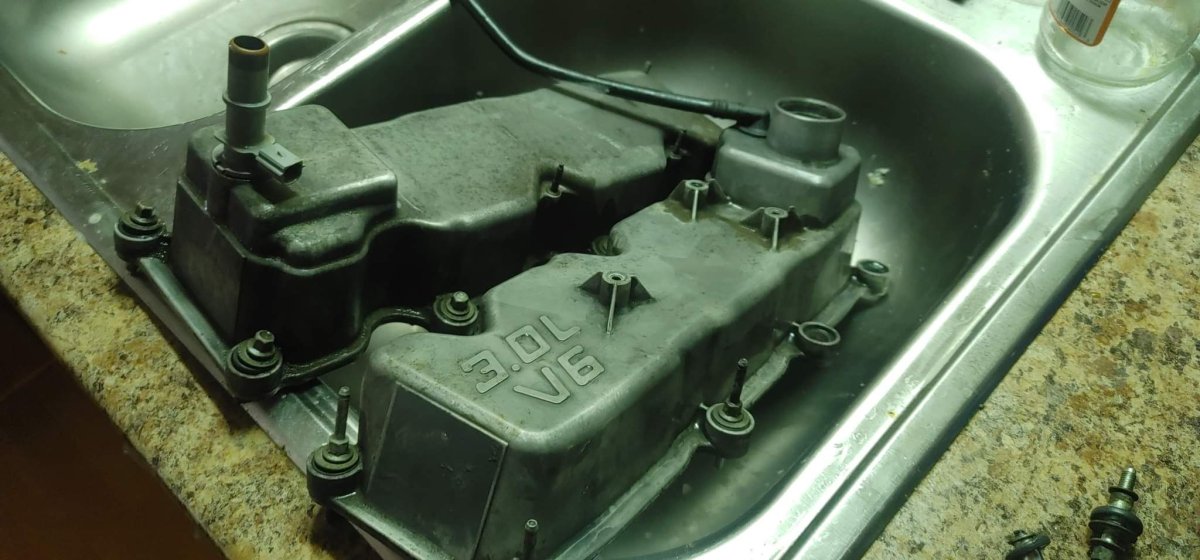

Polished the valve covers and got to work adapting the Taurus PCV system to work with my factory 3.0. Deleted the hose that goes to the rubber intake tube by the oil cap and put a pod filter on it. The 2 coil pack bolts nearest the cap work well enough to hold the pack on. Ground the mount fins a little bit and boom! OE bracket deleted, I'm sure I'll end up making custom plug wires.
74701

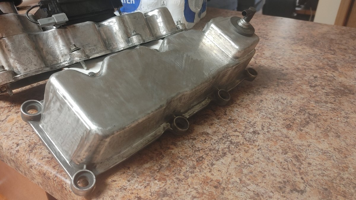

The passenger side was more difficult
74702

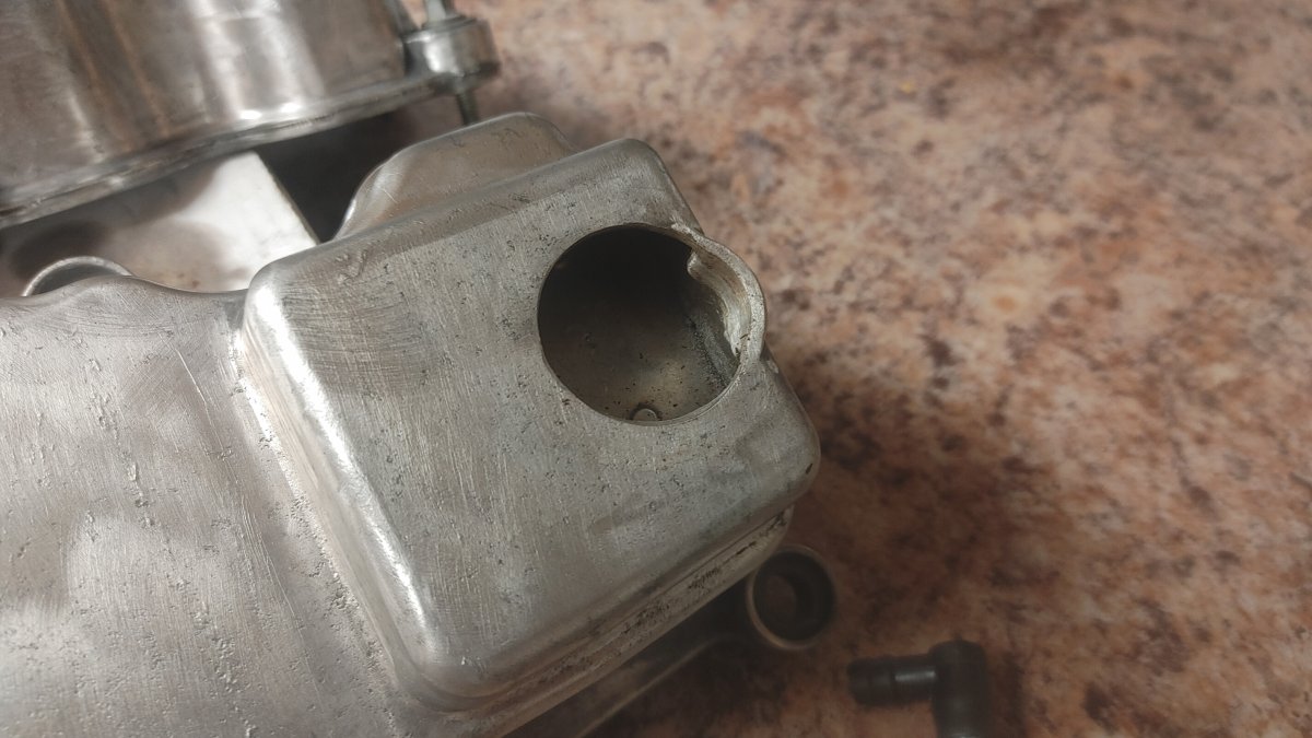

If you reference the first picture you'll note there's a PCV with a sensor wire on this side which our rangers don't have. I started by removing the baffle. I used the old valve cover as a stencil, punched the center and drilled a pilot hole. With a combination of my step drill bit and my Dremel with a sanding wheel attachment this was the result!
74703
theres a good amount of support for the old PCV you'll have to cut out but in the end I got all the way up to the 1 3/8th" step on my bit but didn't punch it all the way through and it fit snug!
74704
should be pretty damn close to factory.
You do have some remnants of a baffle covering the PCV valve? If you do not cover the PCV valve over with a baffle the engine will use oil. Been there, done that.
I have an 02 long runner intake for my 97 that ive ported & got an 01 mustang (60mm?) t-body, ported mass air, 1.8 roller rockers, underdrive pulleys, e fan, 2-1/4" exhaust with flowmaster muffler. 8.8 rear with 4.10 gears Ported heads & headers are next on the list. And then possibly an auto to 5 speed swap. Id like to get some of those valve covers, what did they come off of?
I should have noted I just removed it temporarily to drill and clean the cover so it has the baffle that valve cover came with!

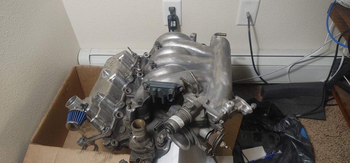

Really happy with how my upper intake turned out! I do not recommend the chemical bath I made to de crust this thing as I was coughing up a lung
74739
Wish the lower was a little brighter, it all blends nice when ya stack it together
