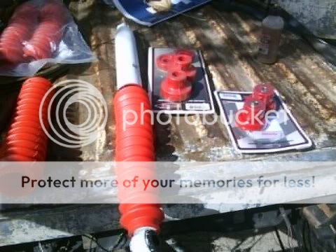

OK today it's time to put the booties on the shocks!!!
I've never had a lifted truck before so the shock covers are new to me.
A little surfing ebay and I also bought a few Bushings for the front end of the truck.
So in the pic is the red Shock boots, I beam pivot bushings and strut rod? bushings.
FrankBoss
looks like axle beam pivot bushings on the right and radius arm bushings on the left

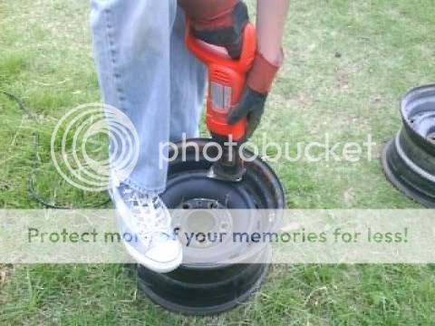

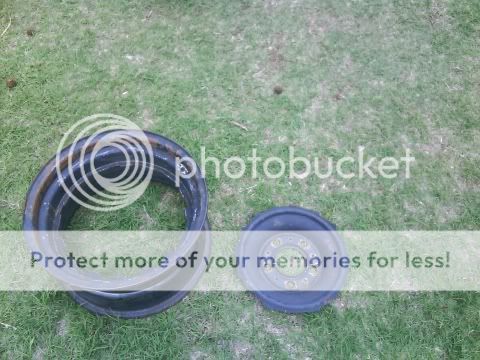

Here the 8 inch wide gm truck wheel. Removing the center so I can get a little more personal with the grinding disc.
See more room to work!
FrankBoss
PS: I had my son (in the photo) cut the center out, I just couldn't do it yet!

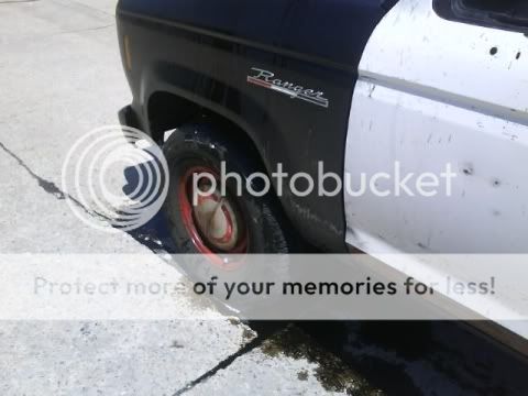

Well when it rains it pours.

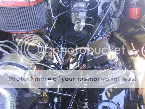

I thought it was raining mud on my windshield but it was oil...
That doesn't look like much but when I pulled over a block from where it started this is what I saw. And it was growing!
So it was nice to be far from home with limited tools a bum arm.
So I might need a motor soon.

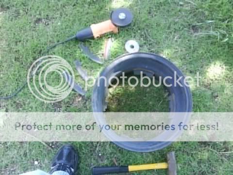

But once I got home I had to cool off.. the best way to do that is to cut sh*t up!
the rims have 4 bead of weld on them so I cut between them to make the work area even larger.

What blew up to make it spray oil everywhere????
Hopefully it's just a oil line or something simple, but look on the bright side, with all the oil every where, it's going to help with stopping rust.and it makes every thing look shinny for a little while.
Robert
yep broke the oil line lost 4 quarts and wiped a few lobes...Ah well...

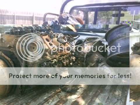

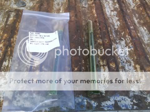

Picked up a couple 3/4 x10 bolts to lift the front 2 inches today.
A seal for the cam replacement and a few cam followers.
I need to locate some more body parts and another wheel.

OK! as I get the strength I'm cutting out these little pieces. So far this is very time consuming, cutting and trying not to gouge the rim hoop.
After all of these are removed I'll gently grind and file the weld beads down.
