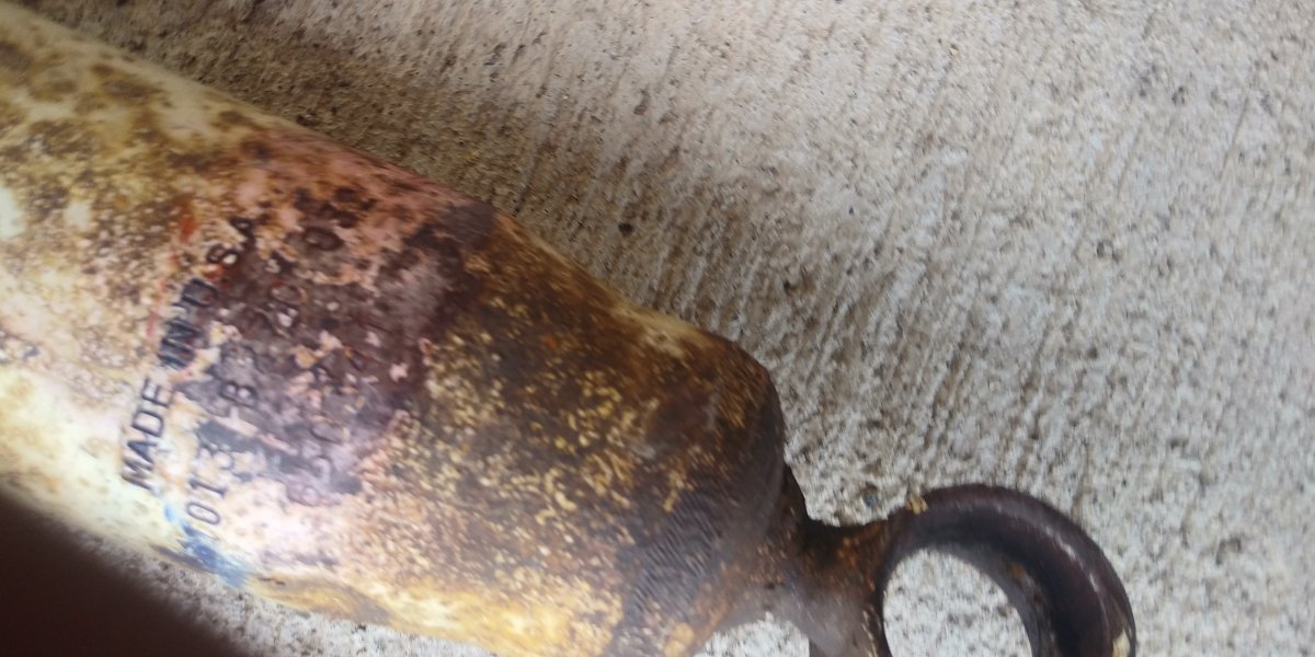

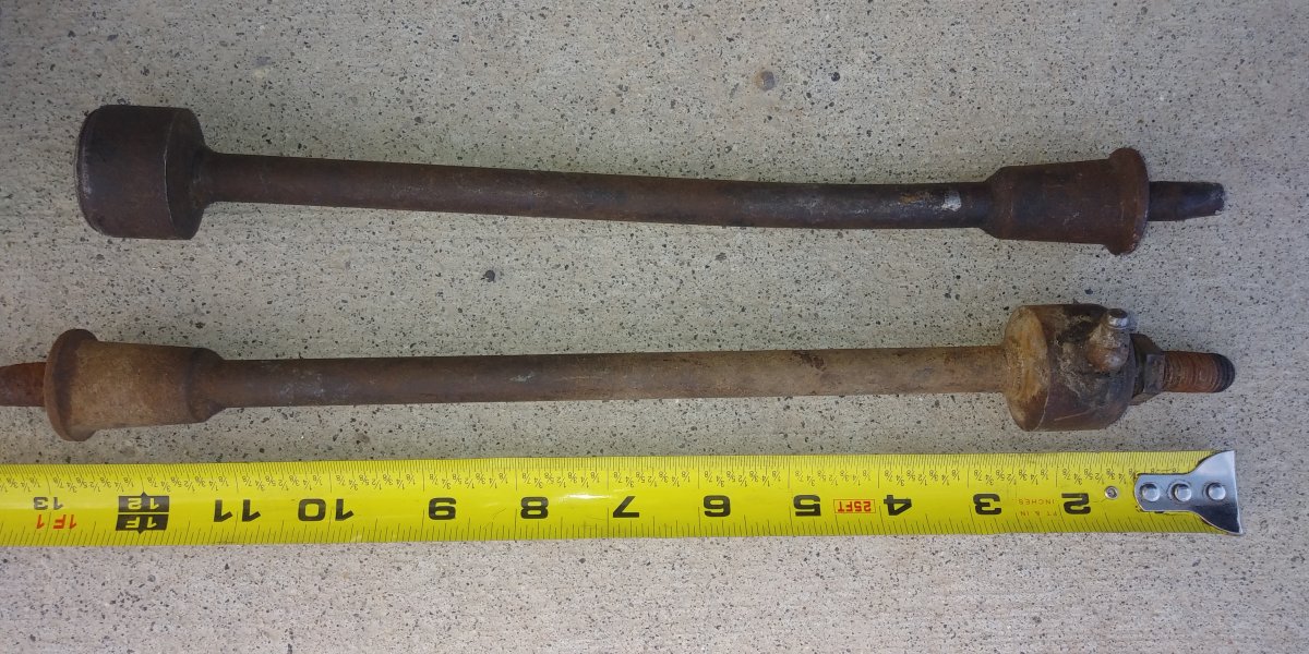

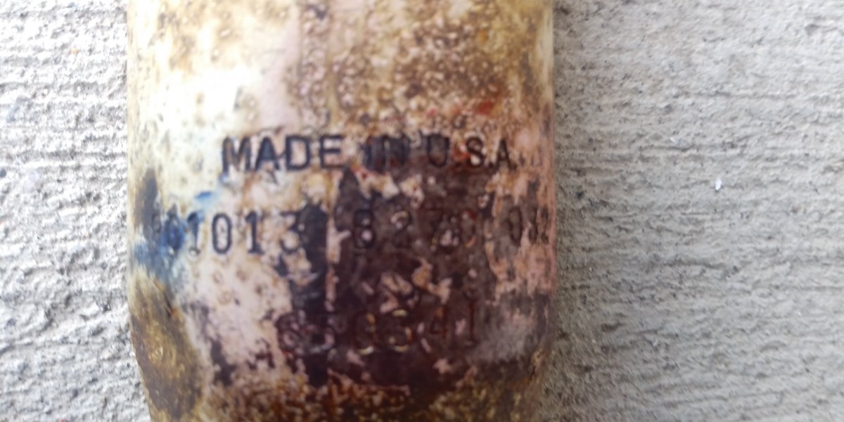

Shocks ??? I need sway baShocks ???r links old one trashed 10" any help appreciated homemade ones work but don't know how long
  • Shocks ???
Is the truck lifted?
I attach pics y the #:!÷ don't they post..
I see the pics but they are just pics of shocks? That doesn't tell me if its lifted, if the suspension is stock any parts store links will work.

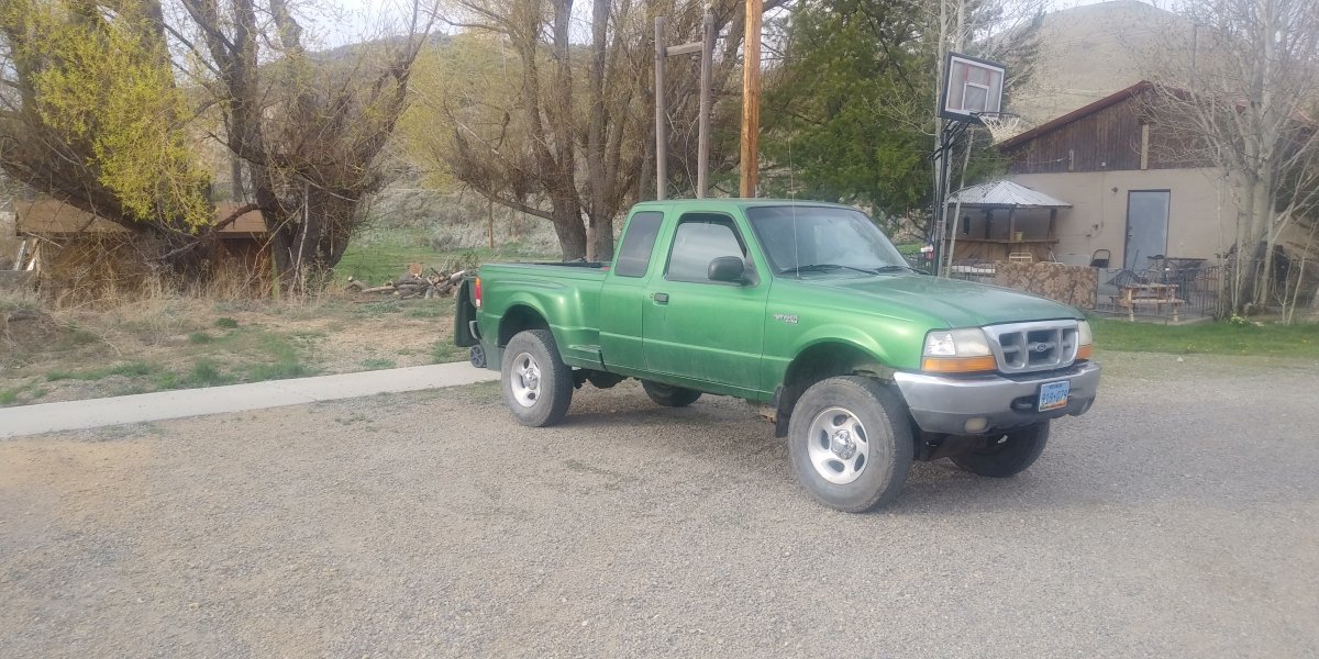

Yes it's lifted don't know how much brand or anything about it. I know it's eating my front tires bad. Im gonna try home alignment. And needs balls joints but having conflicts on what kind. Cuz of the lift. If u look at pic of sway bar I took off its over10"
Shocks ??? I like them. Cuz I can grease them ... Haven't had this l8ng. Don't know much about it thanx for replying

Well double stacked blocks in the rear means its a lifted but done cheaply and poorly. (Not trying to insult you or your truck, double stacking blocks is just a no-no).
The blocks look 3-4" so id asume the front is done the same way, however if its chewing up tires in the front is probably done with coil spacers or cranking the torsion bars and not a proper spindle or crossmember drop.
Chances are you wont be able to align it. Factory parts just dont have that much adjustment. Id wanna look more into the lift and seriously consider removing it.

I'll send some pics after it quits raining. I like your input and I seem very knowledgeable on the subject. If u don't mind that is and what would be the right way of doing a lift on this yr not to much $$ but I'll look at all u send.. If u can
They didn't make a bunch of different height lifts for the torsion bar suspension. I want to say it's probably a 4 inch lift.
Examine the brackets that drop the lower arms and axle. Then start looking on the internet until you find the kit that looks like yours.
You can also measure your shocks at full extend... compare that to stock length shocks. The difference is roughly the lift valve.
