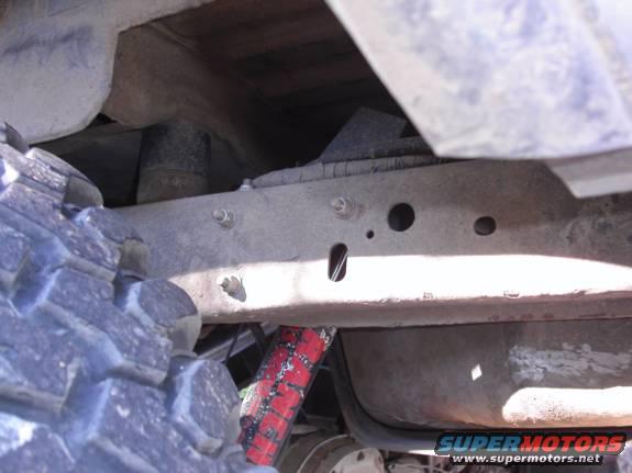

Unfortunately this is the only pic I seem to have showing anything of the modified shock mount (and not a very good one at that)
I can get a better pic tomorrow if needed...
I was going to fab up some entirely new mounts from scratch, but so far these have been working for me.

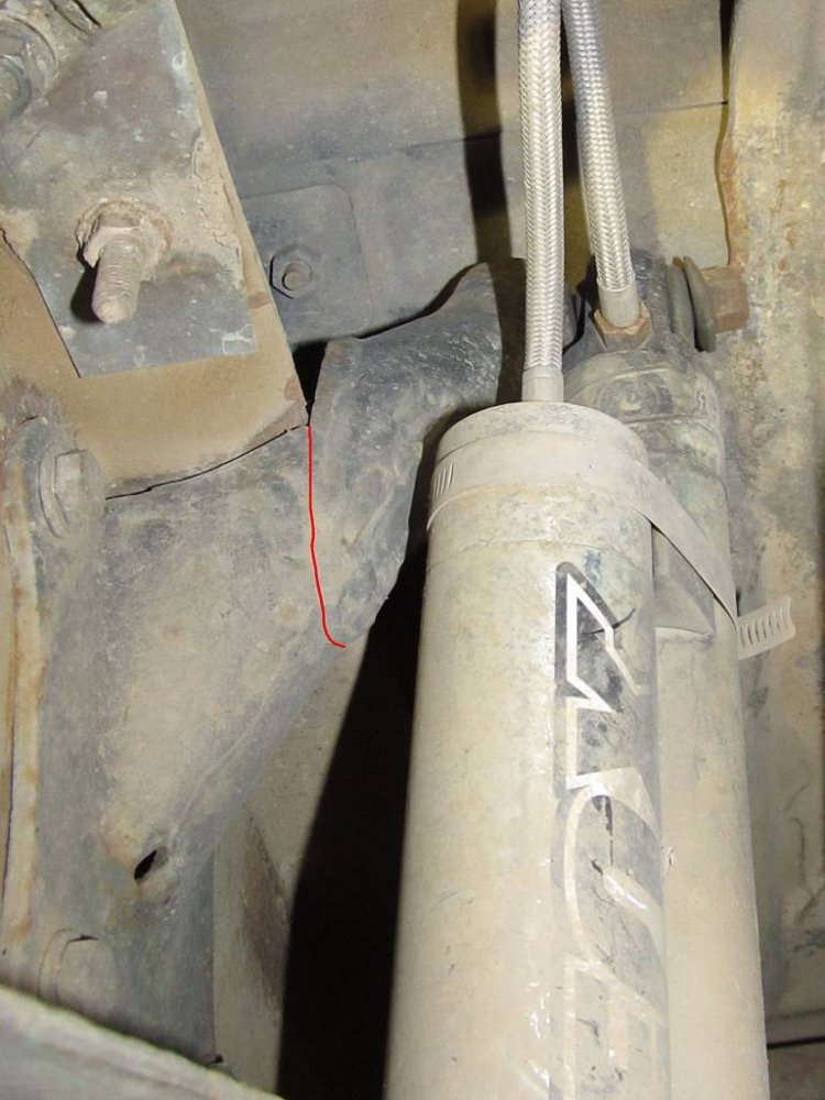

If you could get a pic of the mount id appreciate it.
It's pretty tight under there, but here's as good a pic I could do...
I cut the original mount (red line), welded a 3/8" thick plate onto it, then welded the top part of the mount to the top of the 3/8" plate (grinding it down a bit to account for the thickness of the plate). Finally I welded a gusset (made of 1/8" plate) to the front to strengthen it. It's raised approximately 2½".
Ty that looks about the best easy mod to move the mount
That would likely only work with a body lift unless you are trying to move forward or backward some too... at least on my '90 the upper mounts are fairly close to the bed...
