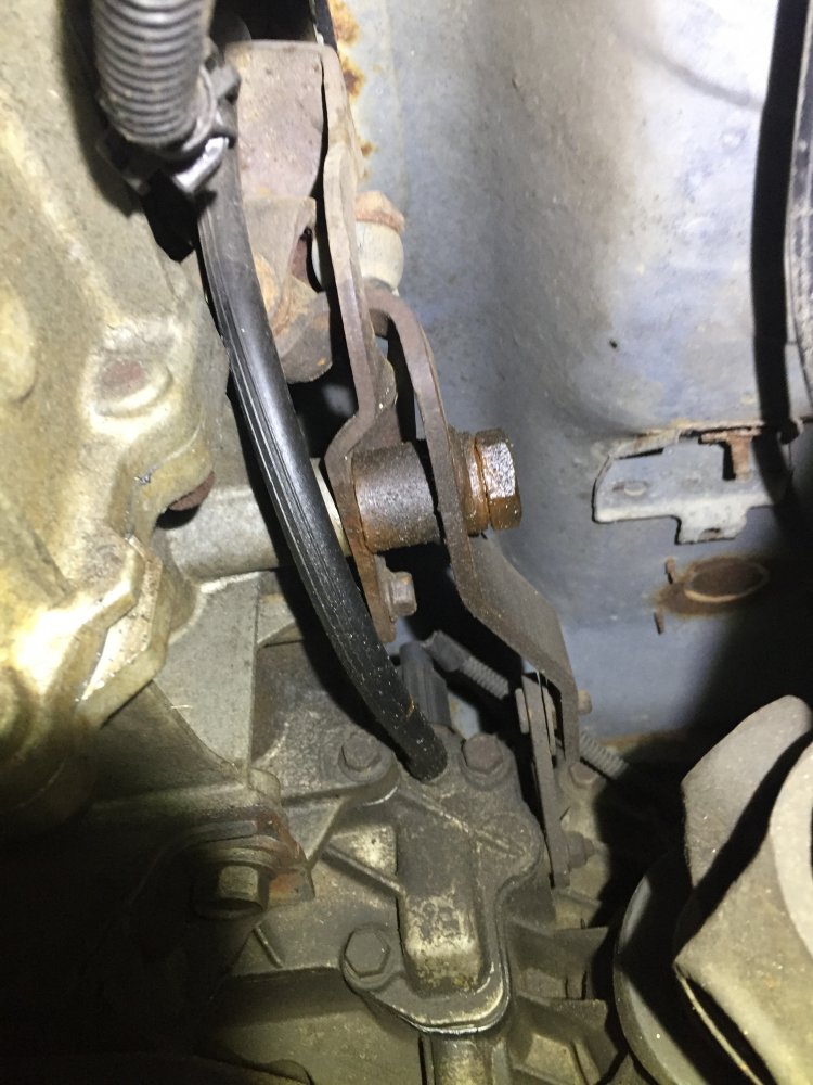

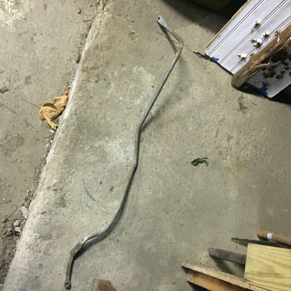

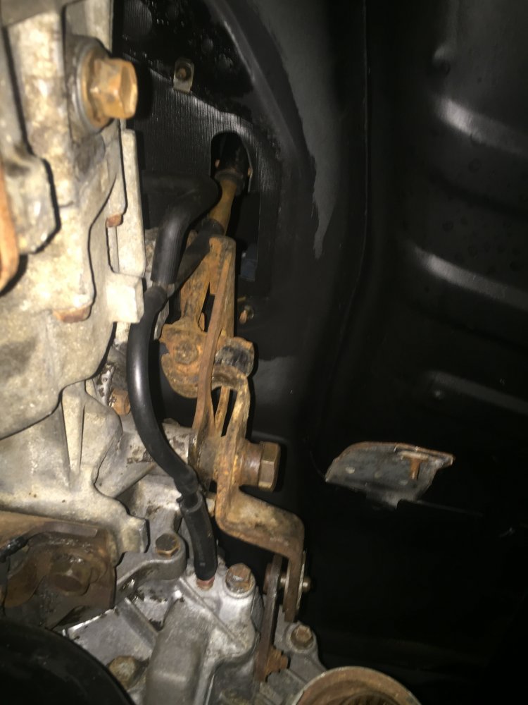

We ( @85_Ranger4x4 )went over this a on another tread a week or two ago. I’m open to learning so here we go. I see there are at least two different shapes. One being 90degree dog legged and the other being just offset. The question being are they interchangeable. I have one of each in the barn all on vehicles they came with.
89 original FM146 swapped to a M5OD. Shifter from the FM146
85 A4LD
85 FM145
Both the 146 and A4LD are the offset type the FM145 is doglegged.
Enlighten me.
89 original FM146 swapped to a M5OD. Shifter from the FM146 View attachment 67957
85 A4LDView attachment 67958
85 FM145View attachment 67959
Enlighten me.

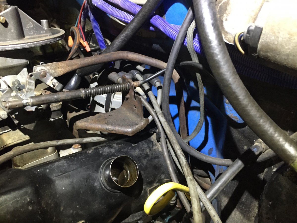

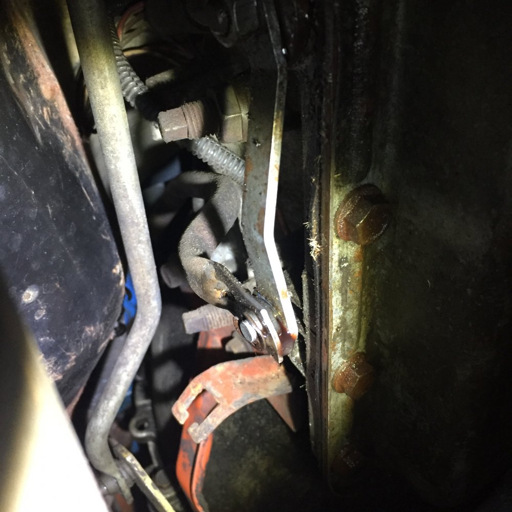

Slightly off topic, can you tell me what your kickdown linkage looks like on the 85 A4LD?
Kinda hard to describe but I can get a picture. Looking for over all or ends?
Over all, basically is it a rod that connects to the carb and has some bends in it, or is it a cable through a bracket?
It’s a rod. I’ll try to get you a picture.

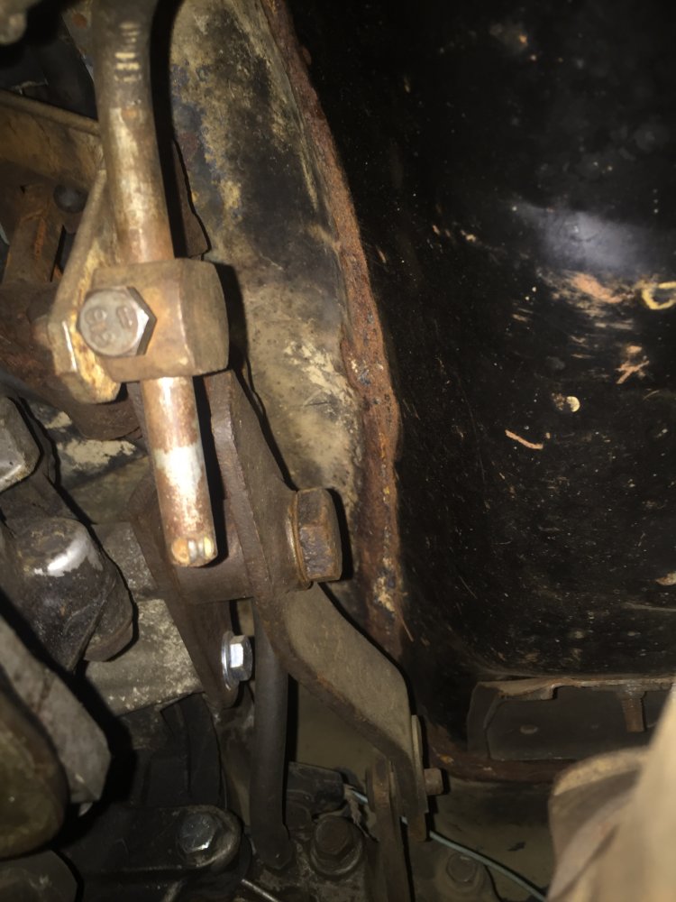

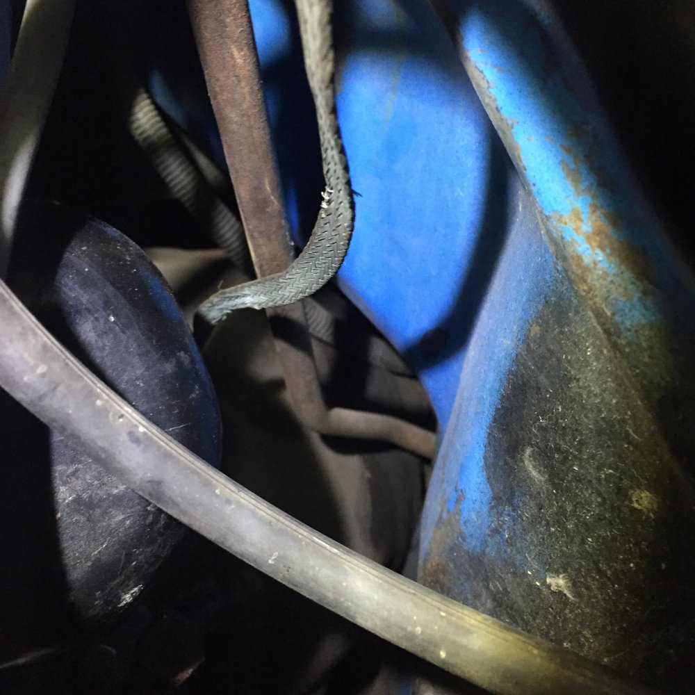

A couple pix on the truck and I have a spare so an over all too. Do you need one?
