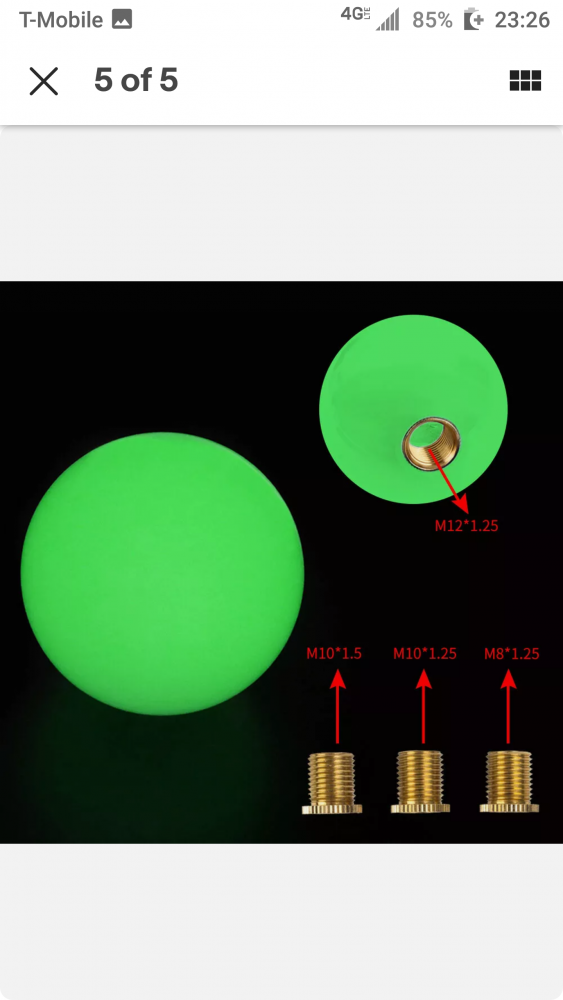

I don't know the value off hand but I know that I bought this shifter extension to correct for my body lift and this ball. Unfortunately to use either, I needed to grind down (reduce it's diameter) the knurled area on my shifter lever to use the 12mm x 1.25mm die to add threads.
The threads on my extension are 12mm x 1.25mm and this ball kit supplied that value also.
The shift lever is easy to remove and it was simple to change the end dimension and add threads. You will need something to grind/cut with and a die to thread it.
