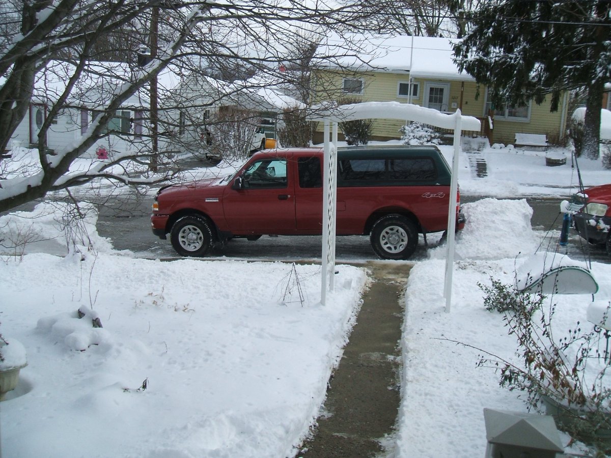

I'm finally getting around to making a "build thread" for this thing. While not as creative or illustrious as some of the other projects people have done on here, I need to put things all in one place instead of spread around all over the forum. I've been avoiding doing one because, quite frankly, making a build thread or a thread that details a maintenance procedure with pictures takes a lot of work and taking the time to take the pictures. So, here goes...
Here's how the truck started, bone stock, just after I bought it.
Sgtsandman's 2011 XLT
I added a bug guard and window visors not long after along with a block heater. Ignore the red cap, that came later but this is as close of a picture I have that best shows the bug shield and visors.
