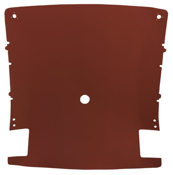

Just ended up inheriting a 1990 Ranger XLT 2WD standard cab 7' bed (Mountain States Edition). The headliner is trashed but otherwise it is in better shape than the '07 that is replacing it. It's really in incredibly good shape for a 34 year old vehicle. It's stock - no upgrades to cruise/tilt steering/etc.
The driver seat has one small wear spot on the back (typical entry/exit friction wear) and one small cigarette burn on the bottom. I would like to put new headliner in it, but it seems LMC, etc all the places I have hunted don't carry that old - the only result showing up for a recover it yourself kit, so that's that...
(1st result in that is too new - 93+, 2nd result is the only product I have found - fabric and spray adhesive)

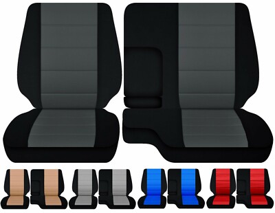

...as far as the seats I thought I would throw covers on and be done, well until I found out the 60/40 split bench seat cover world is basically unicorn hunting.
I found these 2:
durafit has a $40 restocking fee if you return it, so that is basically un-returnable in my books.

I haven't pulled the trigger on anything yet, but the $90 ebay covers are probably what I am going to do. More than what I wanted to spend on that one item. The local junk yard is cheap cheap (I am west of the Mississippi and junkyards are like half the price of back east), but all the rangers are red interior or rolled and completely trashed or or... I found a couple explorers (98 and 99) that weren't entirely trash and got the overhead center map light/compass/sunglass cubby unit and wiring harness for it+lighted visors, but it had grey visors and cigarette burns... I could get a matching tan passenger visor (explorer dual/split piece lighted) tomorrow, but all the drivers visors have issues of one sort or another. I even see a 6' bed 1st generation with dual fuel tanks out there in the yard, unfortunately it has a few rust pinholes over the fenders.
To answer the question of how trashed the headliner is, the fabric separated, and someone took the little screw in buttons and perforated the board 20+ times to hold it up. The front edge of the liner (exposed to sun) has sun rotted out and is hanging in tatters. I hope the board is salvageable to recover.
Those ebay covers are actually not bad! I have had two sets now in two different trucks and they do hold up. The only issue is they fade. My first set was red/black and they faded in less than a year. The second set, which I still have now, is all black. I've had them for about 2 1/2 years and they are still holding up.
That was exactly one of the things I was hoping for, someone who has used the models I found and can provide feedback if they are worth anything. Question if you would, do/did you park in a garage or out in the sun when you had a set fade out in 1 year?
