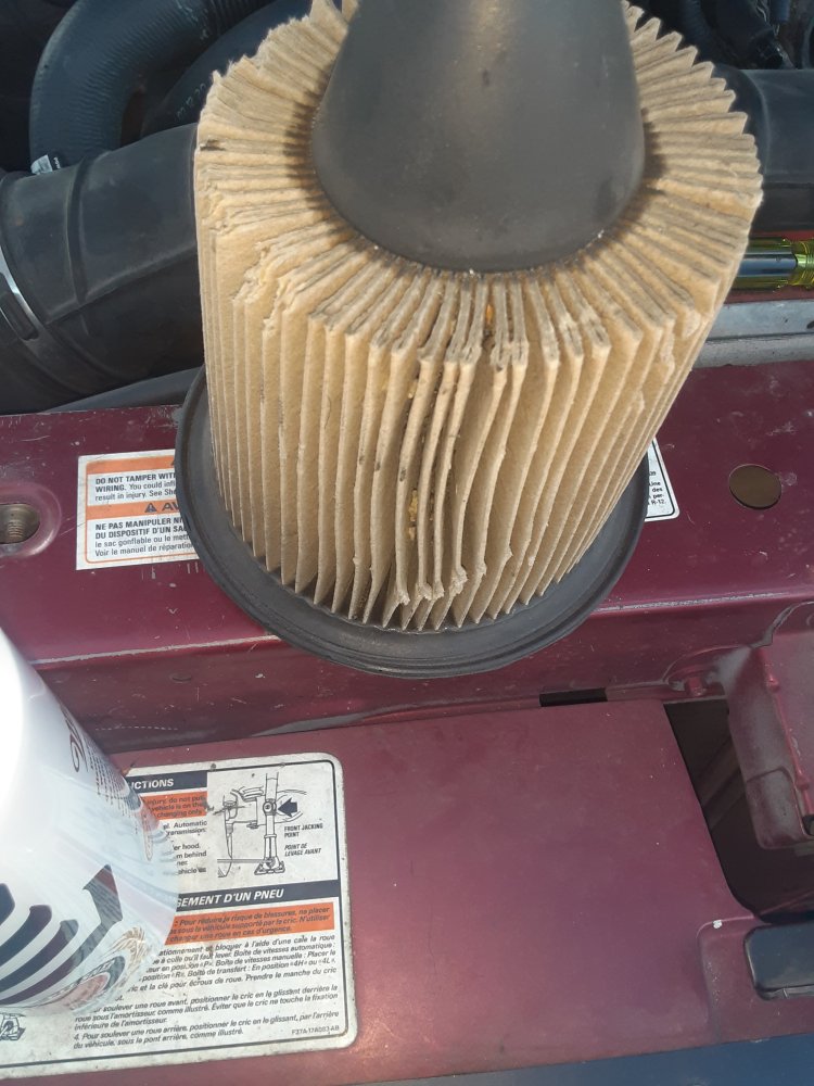

About to seafoam my Ranger and found a bottle cap, a hose clamp and wire clamp in my air filter bay..
Forgot to get a new filter was going to get a WIX filter.
This is what was in there. Bothered that it's what I have to put back in.
It's all eaten up from being forced in?
At least they are the "right" side of the filter. Can't get in the engine.
Your guess about the filter condition sounds like a reasonable explanation.

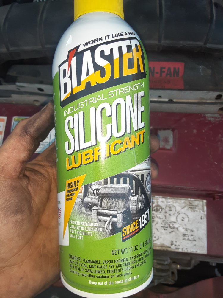

Saw a video where some guy "Car Wizard"
Sprayed a Crest brand silicone lubricant on some electrical connectors like harnesses to get them to click and seat correctly. Is this the same thing?
This connector wont seat correctly.
As long as you just apply it to the connector seal. Sure. The seal is probably what is binding up anyway.
The connectors have locking tabs that need to click in place for the connector to fully seat. Be real careful handling connectors; the plastic gets brittle with age and breaks easy.
Use the silicone spray that you got, it will likely help you click the connector in place. Just go easy.
And, get a new air filter as soon as you can. But I know that you already know that, right? See, you're learning quickly! (y)
