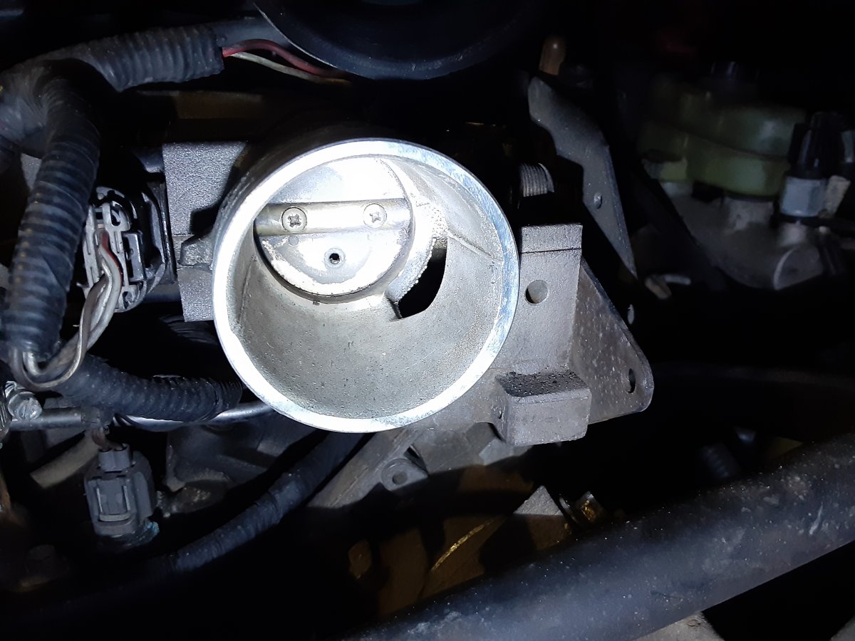

I couldn't find a spot where the throttle body couldd be removed...
So I slipped the spray nozzle directly into the throttle body? It didn't seem to leak.
This was the throttle body before treatment.
It's dark so I need to wait for tomorrow for the after pictures.
I only sprayed the throttle body. Waiting on a day where I can fill the tank to do the fuel treatment and when I can afford oil and an oil pan so I can dump it into the.... "crank case"?? I forgot to take pictures of the smoke but yeah it let out a lot and now it seems smoother. It was letting out a lot of contaminants.

That's the throttle body. Being built into the intake like that is not common. The thing sitting on the top right is your Idle Air Control Valve (IAC). That can get clogged up over time. If you have the tools to unbolt that, take it off and hose it down with throttle body cleaner.

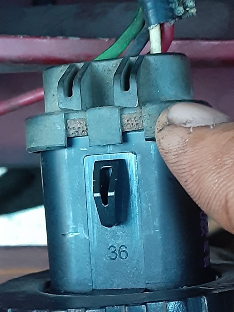

Is that a headlight connector that's taped up? It looks like somebody's replaced a headlight bulb in the past, and broke the connector's locking tabs, requiring the tape to hold it tight.
If so, that's a good example of why these old plastic connectors need to be handled with care when you're working with them.
I was actually the one who taped it. The third day I drove the truck the right headlight went out.

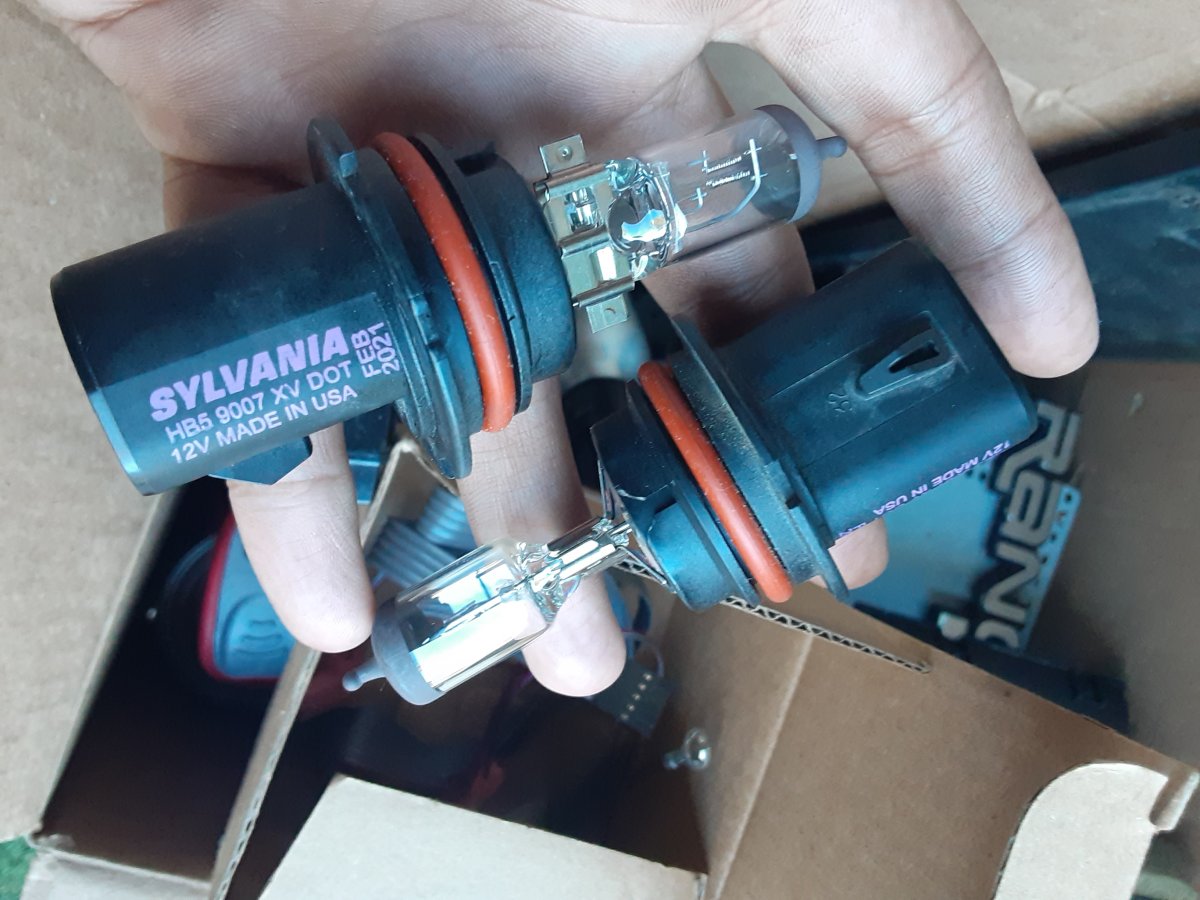

These are the ones it had:
So I bought new ones(same model) but when I went to replace them it just so happened the light hadn't went out it just wasn't seated. I kept the new lights and replaced them anyway but it still wouldn't seat and I didn't have the silicone spray yet so I hit it up with tape but today I'm realizing... either the clips to hold them in place are broken or these weren't the correct lights to begin with.
They fit and work but theres no click. It's fine up until the point where some sort of plastic tab would exist for that larger mound to fit into but nothing.

Yep, the locking tabs are broken off of the headlight connector, so it won't "snap" and lock onto the bulb. Don't tell anybody, but some of my trucks use the same electrical tape holding method as you did; good fix.

I hope you wiped those bulbs off with some rubbing alcohol in order to remove the skin oil left behind on the glass. If not, the oil will create hot spots and cause the bulbs to fail prematurely.
Whoa! What? Ok I'll pop'em out and literally do it right now. Back outside for me.

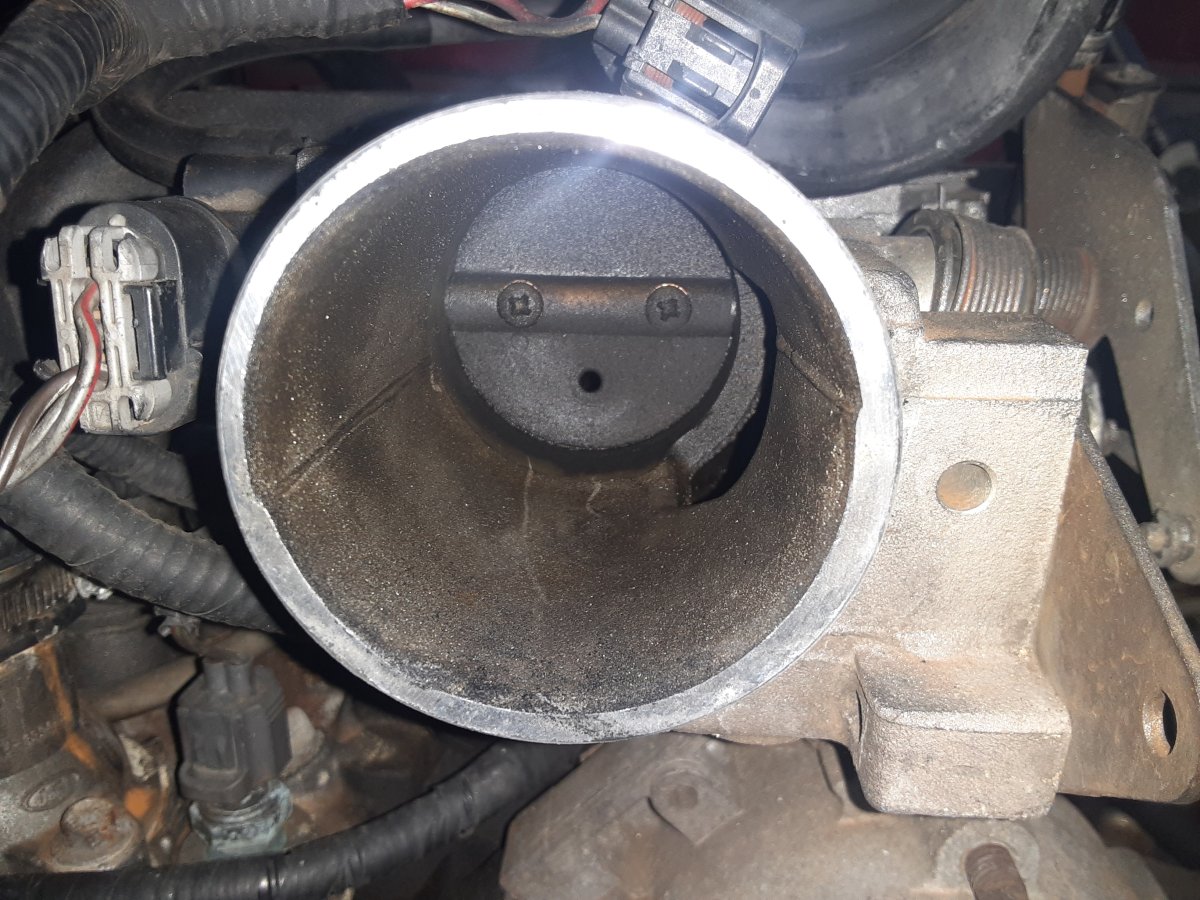

Ok so. This is the throttle body after seafoam treatment.
This is it with me throwing a little TLC at it.
Is there a such thing as too aggresive with cleaning?

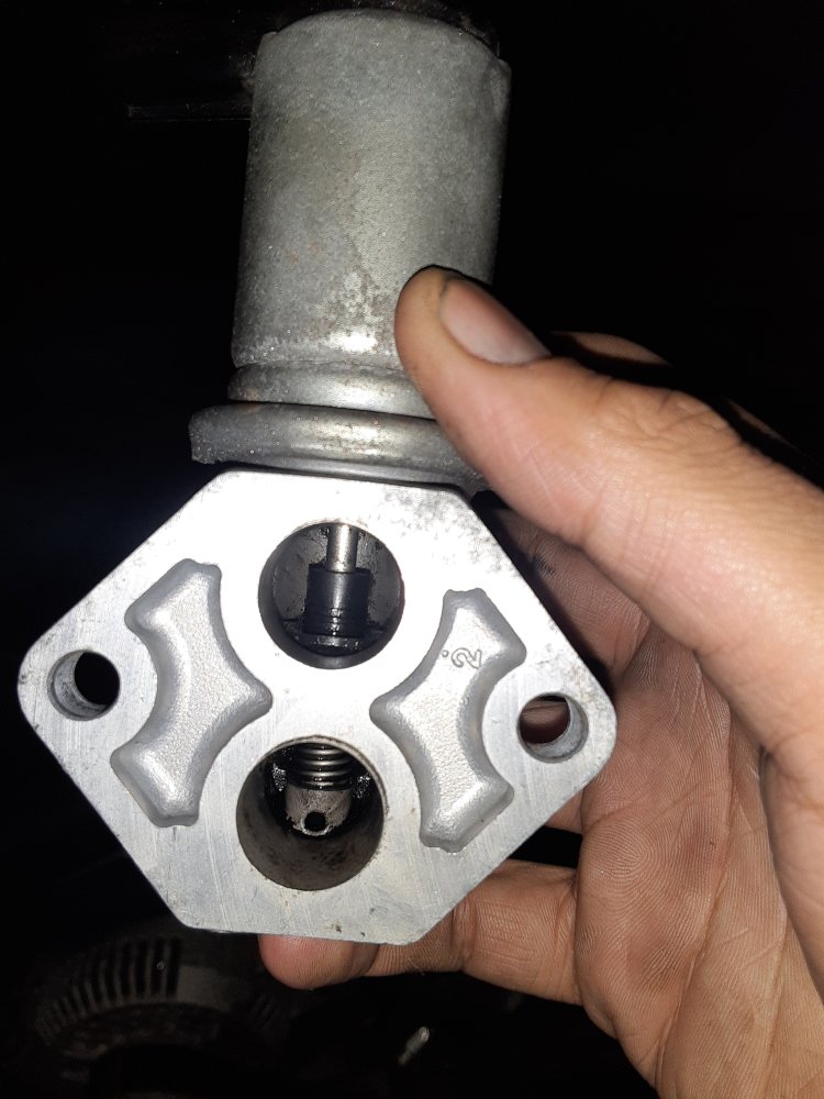

And here's the IAC, sorry I forgot to take before pictures.

Because of how hot headlight bulbs get, you definitely don’t want to touch the glass with your hands and clean them with rubbing alcohol if you do. Those old bulbs were the Xtravison Sylvania’s, decent bulbs. I prefer the Silverstars, little bit brighter. 9007 is the bulb type and those have both high and low filaments in them, so if you don’t have high beams, you have a problem somewhere. As mentioned, the clips on the plugs for the headlights are broken. That extra wire plug appears to be something aftermarket, that’s not a standard Ford harness and plug.
