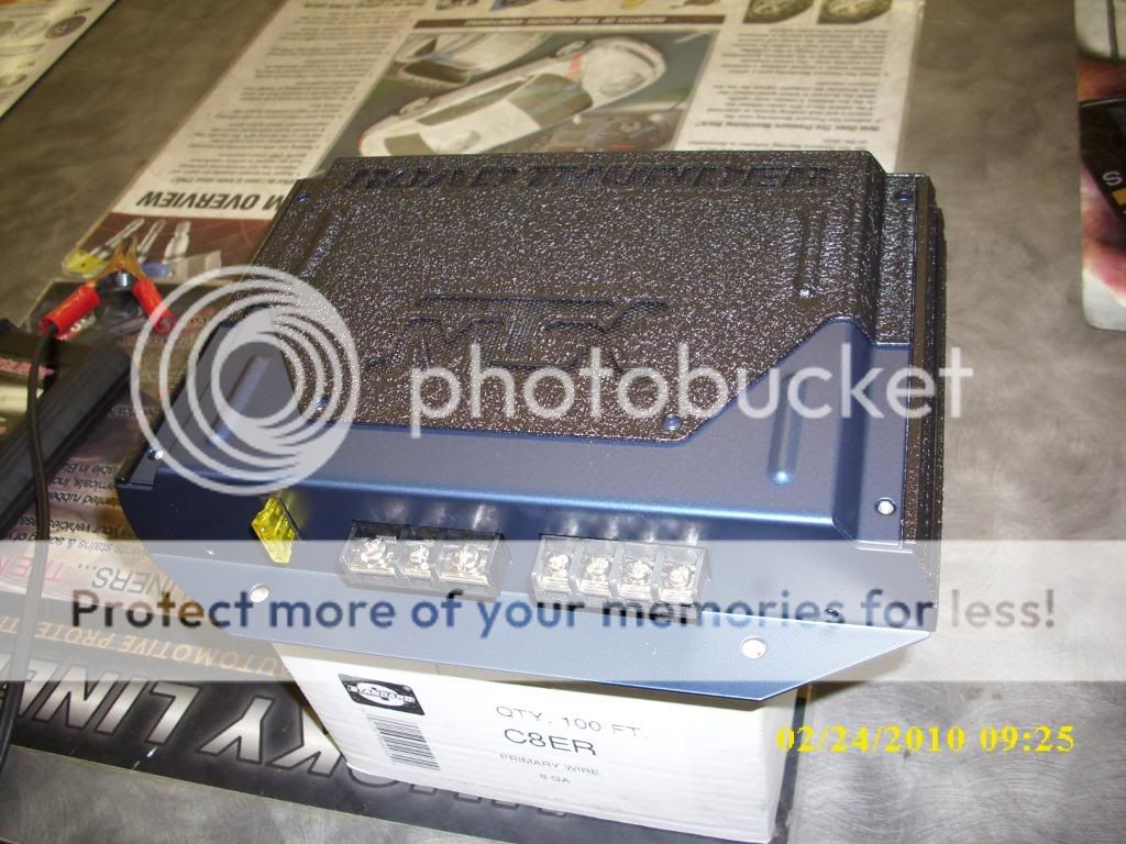

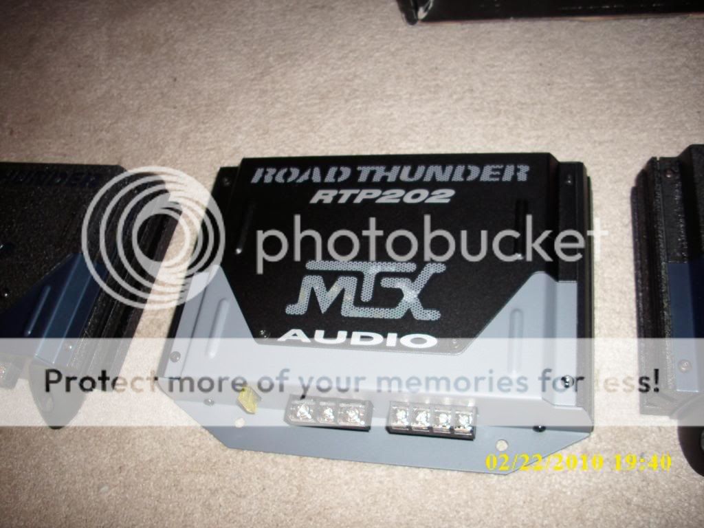

heres the RTP 202 painted to match the other RT 202s
?s about wiring my system

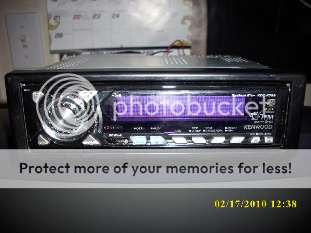

and heres the picture of the wiring if i used the kdc x759 (still have to send it in for repair)

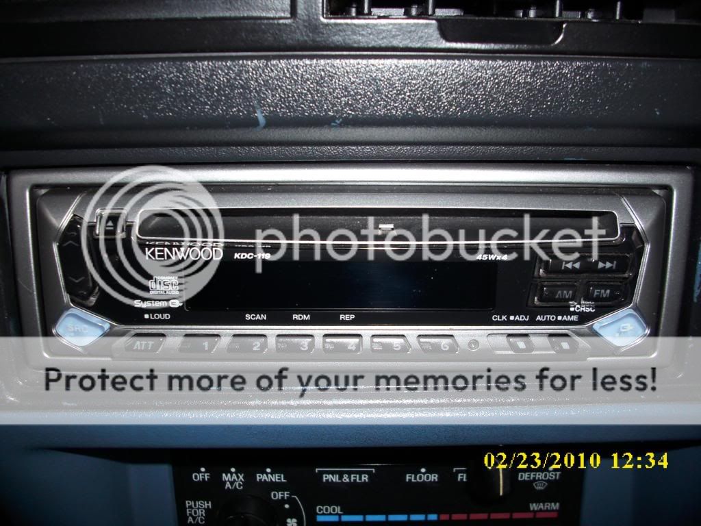

im leaning towards using the KDC119 HU because its already in there, i will still have to buy 3 rca cables any ways, and its less stuff to run that way (i guess its only 2 cables less that i have to run under the flooring, so i may just buy 2 more long lengths and put them in there incase they CAN fix that KDCX759 unit, then i can just plug it in when im ready and everything else should still work with minimal RCA cable changing.

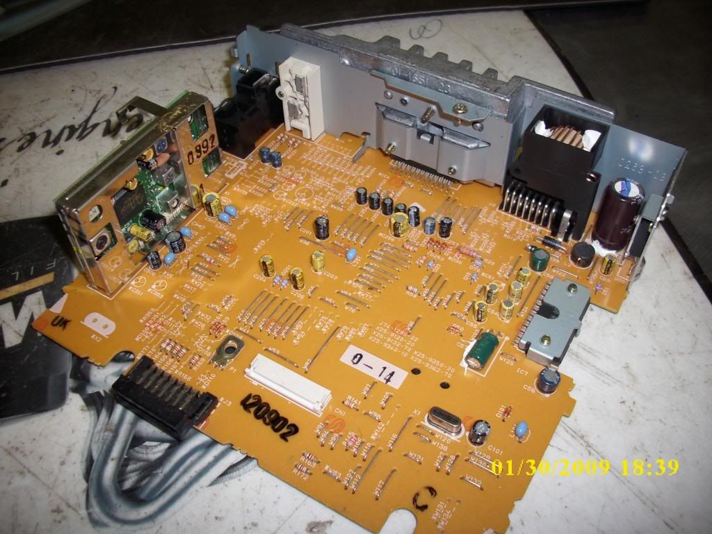

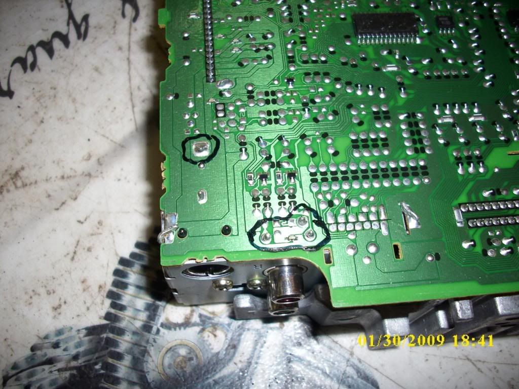

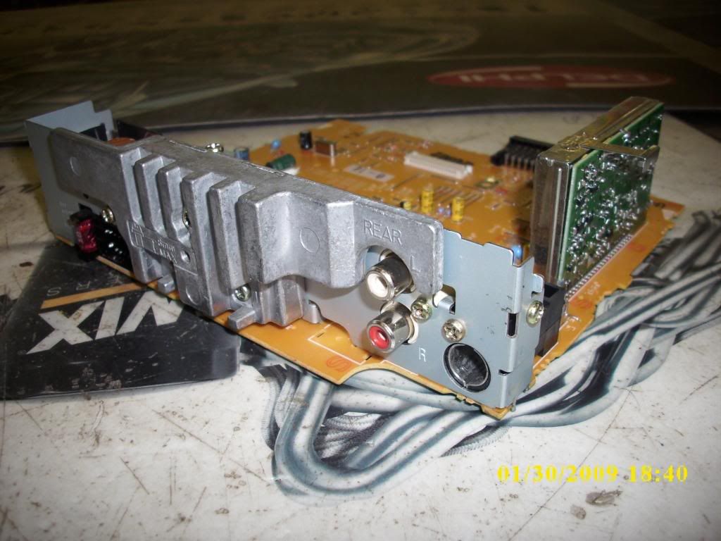

the only gamble in going with the KDC119 is that i had to repair it after my friend traded me for an old pioneer i had. when the kenwood was in his chevy it didnt sit in the dash all the way so he kept pushing it in and eventually lost his out put signal. i took it apart and found that the solder connections had broken off the board, so i resoldered them, but have not tested them since installing it my truck.
