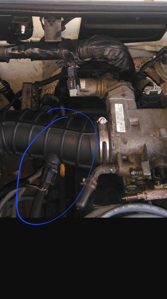

is that the sensor inside the air intake system closest to the throttle body?
  • rought idle for the first few seconds after starting, goes away after a minute or so.
Yep. That'd be the one. It's the one called out by the P0113 code.

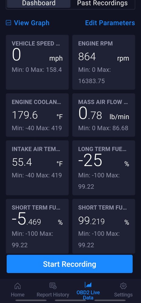

so I got the new sensor and that helped the starting issue but I checked fuel trim with my OBD reader and short-term fuel trim is jumping around from anywhere between negative 10 to positive 20 where my long-term fuel trim is negative 25 constantly still shifting rough I'm not sure where to go from here
short-term fuel trim sensor 2 is sitting at 99 and doesn't fluctuate at all where short-term fuel trim sensor one and long-term fuel trim sensor both fluctuate
