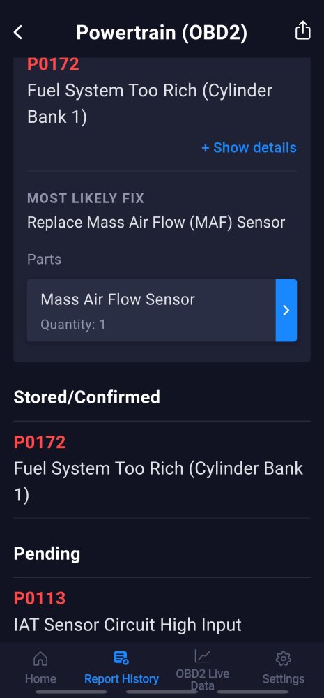

I have a 97 2.3 ranger with 179,240 miles, has been a great and strong running truck but recently started bumbling around while shifting and when you first start it in the morning it sounds really rough, can even kind of hear it rhh rhh rhh up and down in idle and after about a minute it goes away. I cleaned maf and replaced PVC also sprayed carb cleaner around the air intake but I can't figure it out for the life of me any help is appreciated!!

these are codes it's throwing now, was saying too lean before I cleaned maf and replaced pcv now it's saying too rich

Can you test the IAT sensor?
