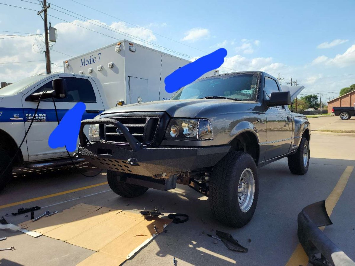

Alright forgot to post a update. I ended up taking a old nut and screwed it up on the LCA shock mounts and hammered them all back into place. Ended up getting these guys and they work for stock suspension, and they fit like a glove. The ride is still a little stiff but that's what I expect with the coils. But maaan is the ride way smoother than the old shocks. Still feeling them out but it's getting better. Next step is skid plate order, replace the UCA camber bolts/plates so I can get an alignment and new shoes. Was able to get the bumper on during my 48hr shift. Looking like every other truck but it's mine. I appreciate all the help fellers.
