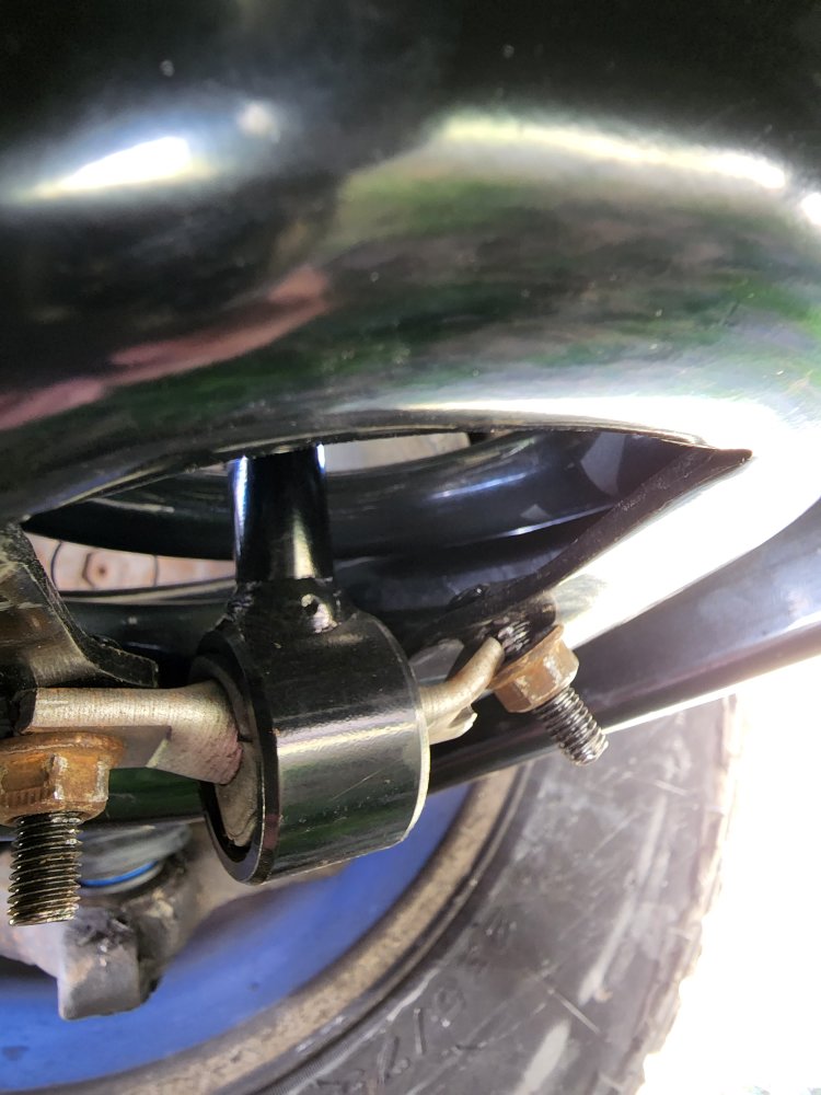

After a brief inspection this is what I found.

That's the bottom of the shock? Looks like it's too long and bottomed out. I wonder how it would ride without the shocks in place. Of course it will be bouncy, but I wonder if you could tell if the ride was softer? That might confirm the shocks were running out of travel and that is what hammered that mounting bolt.
Oof yeah not what I expected. Shock definitely looks like it's too long, and limiting uptravel.
Hopefully that stud can be straightened out.

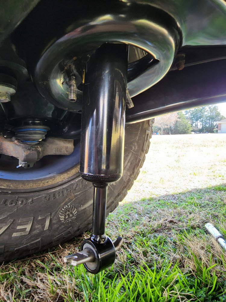

I popped the bottom off and it fully extended. The shock description said for 1 - 3in lifts and the coil was a 2in. So smooth brain answer thought it would work with this.

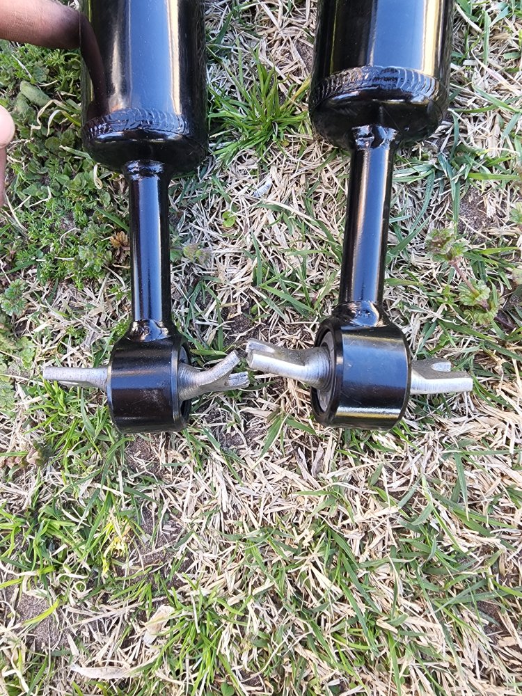

That's full extension. The other side isn't busted up but definitely fraying out like it will eventually bust like the other side.
Do you have the old shocks kicking around somewhere?
Those look to be 4wd sla shocks
Negative. Had the old ones chunked. About to get some Ranchos ordered. About to figure out the bolt situation. Seems like the top may be welded to the LCAs.
