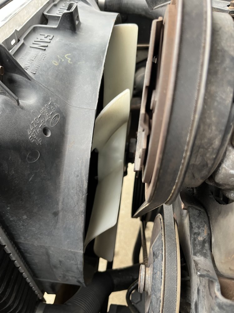

This past summer we replaced the radiator, thermostat, fan and fan clutch. The radiator was really bad even after flushing it like 6 times. It had started overheating, we think because the fan clutch went bad. The fan blade was cracking near the base so we got a new OEM one. My dad said it was expensive but better than having it come apart and ruin the new radiator. No more overheating. Also the A/C was not working. We recharged it and so far so good. I had a flickering alternator light that would go out when I got going over 35mph. Never had any problems starting or the lights being weak. We replaced the alternator and it solved the problem. My dad was relieved it was not a complicated wiring issue.

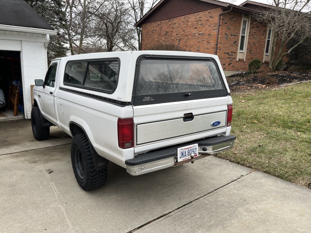

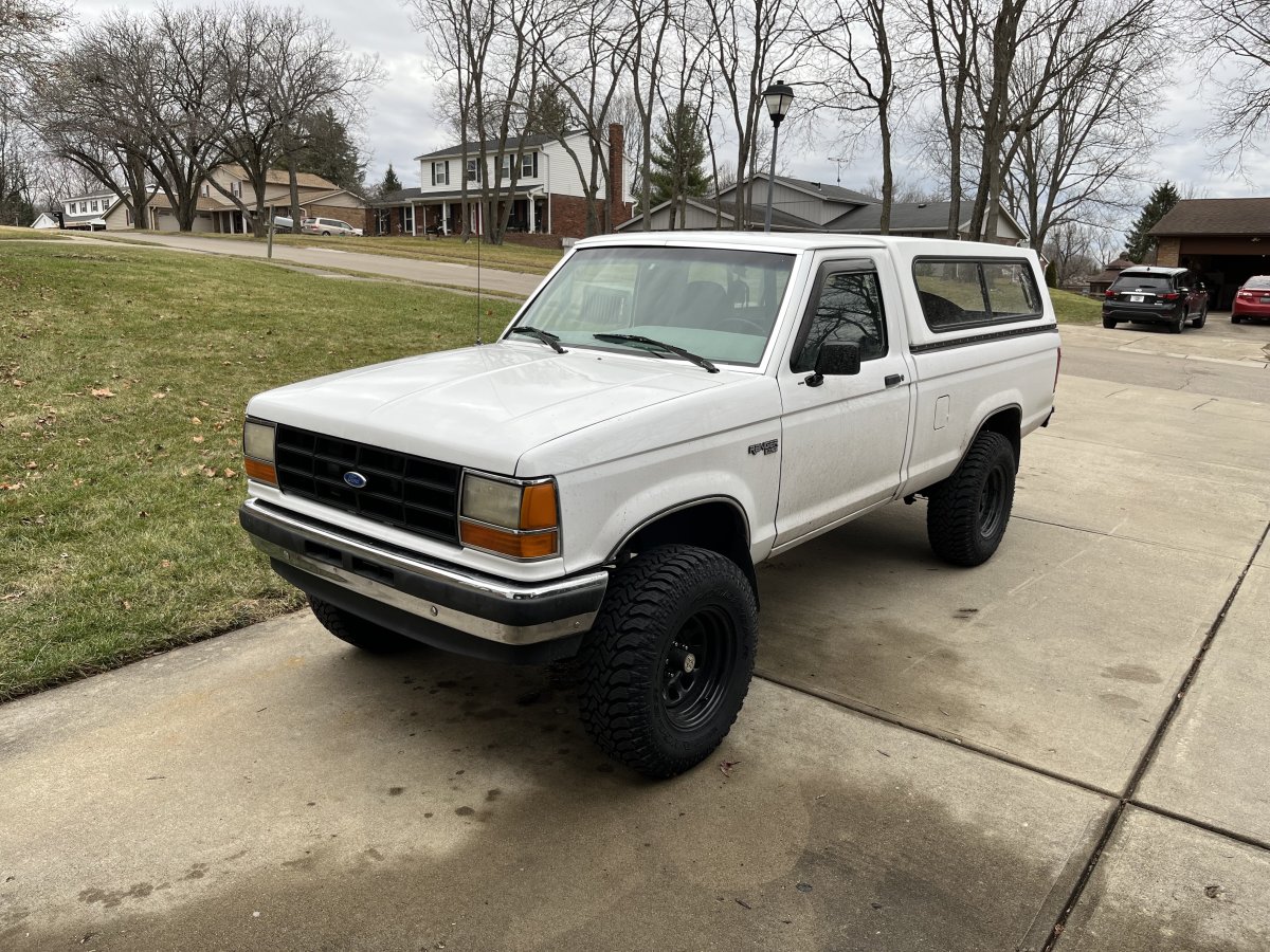

Originally it had Federal R/T 31x10.5 r15LT tires on it. They are still good but weren’t great on the street especially in the rain. Today I used my Christmas money towards a new set of Goodyear Wrangler Authority A/T 31x10.5x r15 LT. It drives much smoother on the road now. I’ll keep you posted on how they do on our winter roads.
I put a black grille on it today. The original one had broken clips. I”m going for a partial blacked out look.

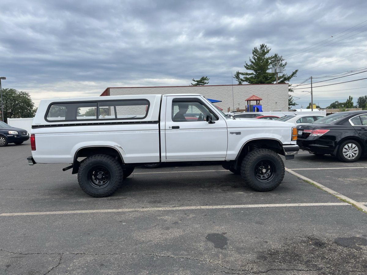

Photos are from the day I got my license.

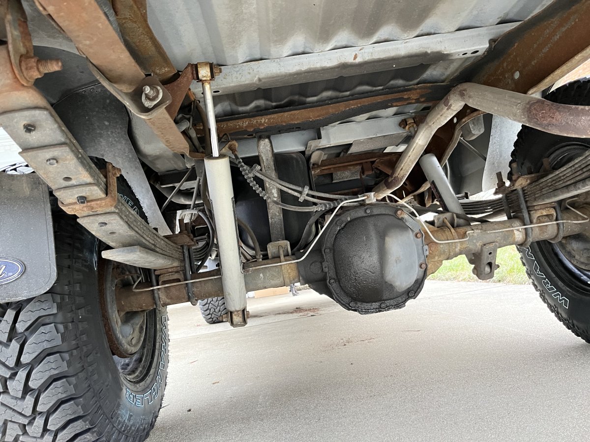

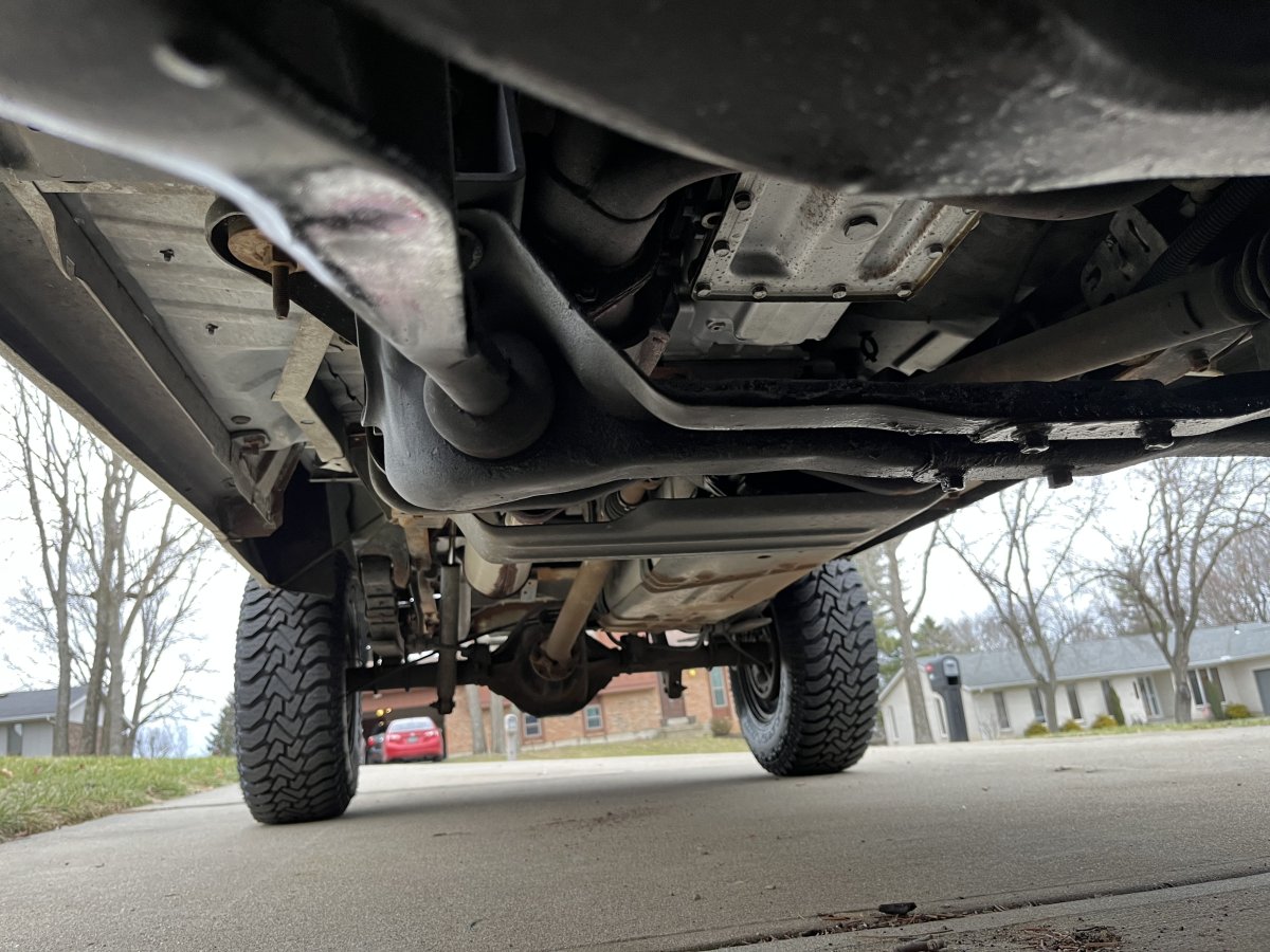

The bumpers look normal with no gaps. That's usually what happens with a body lift.
3.55 gear with those big tires. How does it do in overdrive?
I took pictures of underneath. See below.
It is not the best. Does not have much power in 5th, but I don’t drive on the freeway much. I asked in another post about gear ratios and would like to switch to 4.10.

Installed a new grille today also. The clips on the other one were broken and it was loose At the bottom. Also just some all around photos.

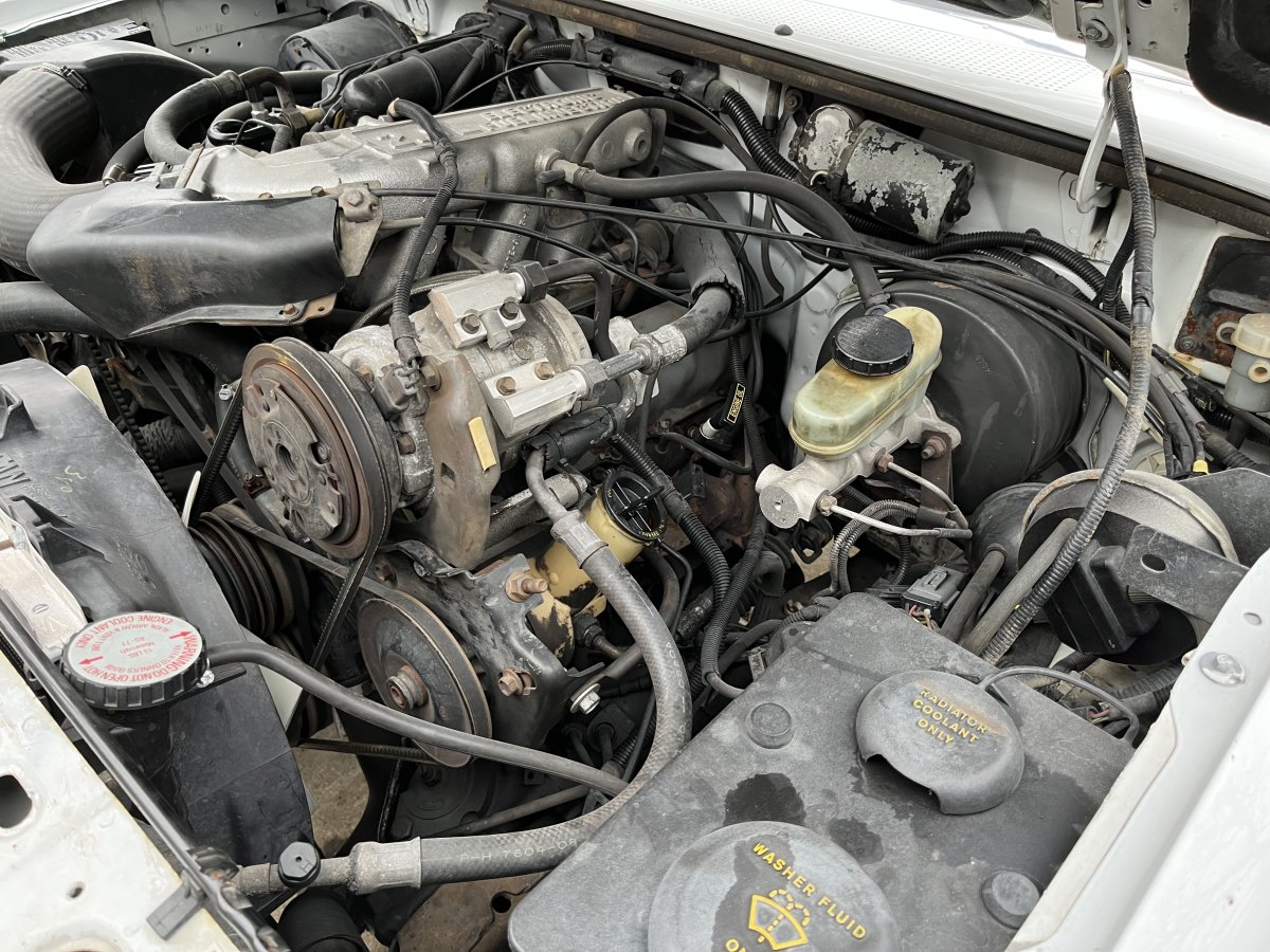

Engine and undercarriage photos.

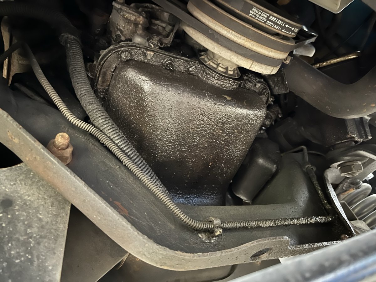

Have an oil leak too. It is not terrible. I have to add some every 3 weeks or so. It seems to be in the oil pan gasket. I read you have to take motor out to do that so that will have to wait a bit. Also read on the forum that I could try tightening the bolts, only 5ftlbs, and see if that helps. Will try that first. Need to clean it off good before I do that. Engine has about 127,000 on it.

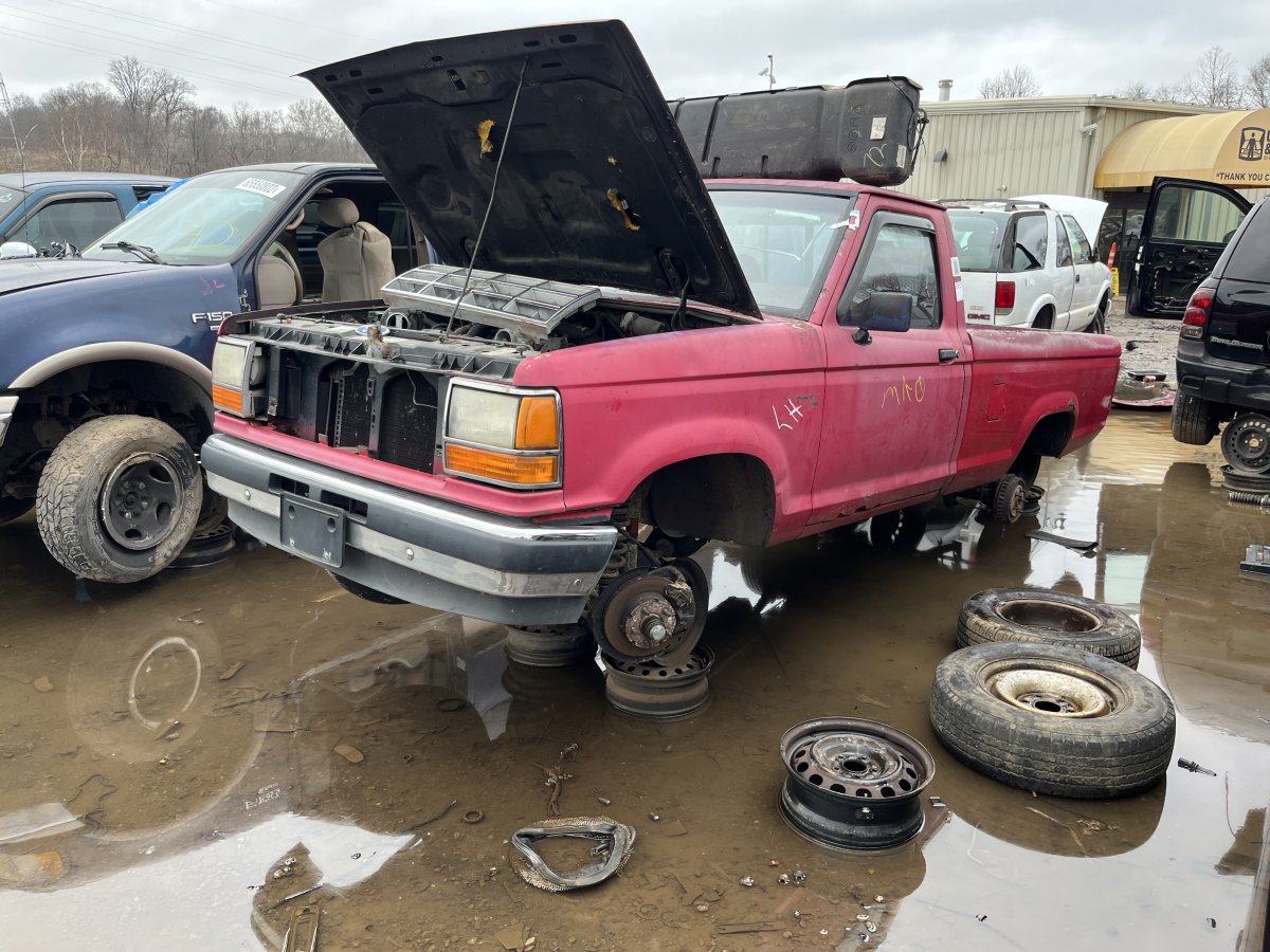

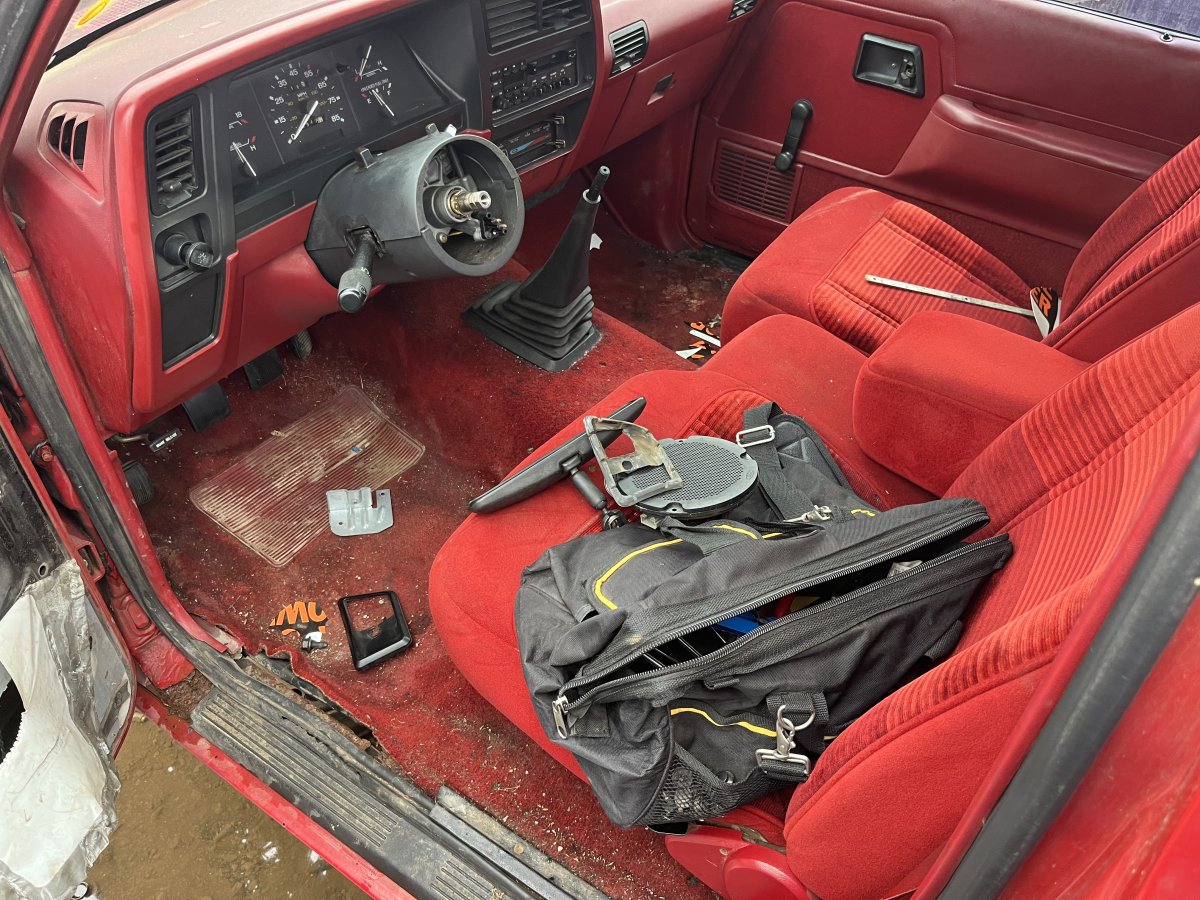

Went to the pull and pay junkyard today with my. They had a 92 listed. Looked like a 4 cyl 2wd. Badges were missing but I think it was an XLT. Unfortunately it was in the middle of a big puddle. Got a rear view mirror, door speaker, owners manual & document holder, bed mat, window crank handle and shift boot. Also took apart the door to see how to fix my passenger inside handle. Going back tomorrow for the front bumper.

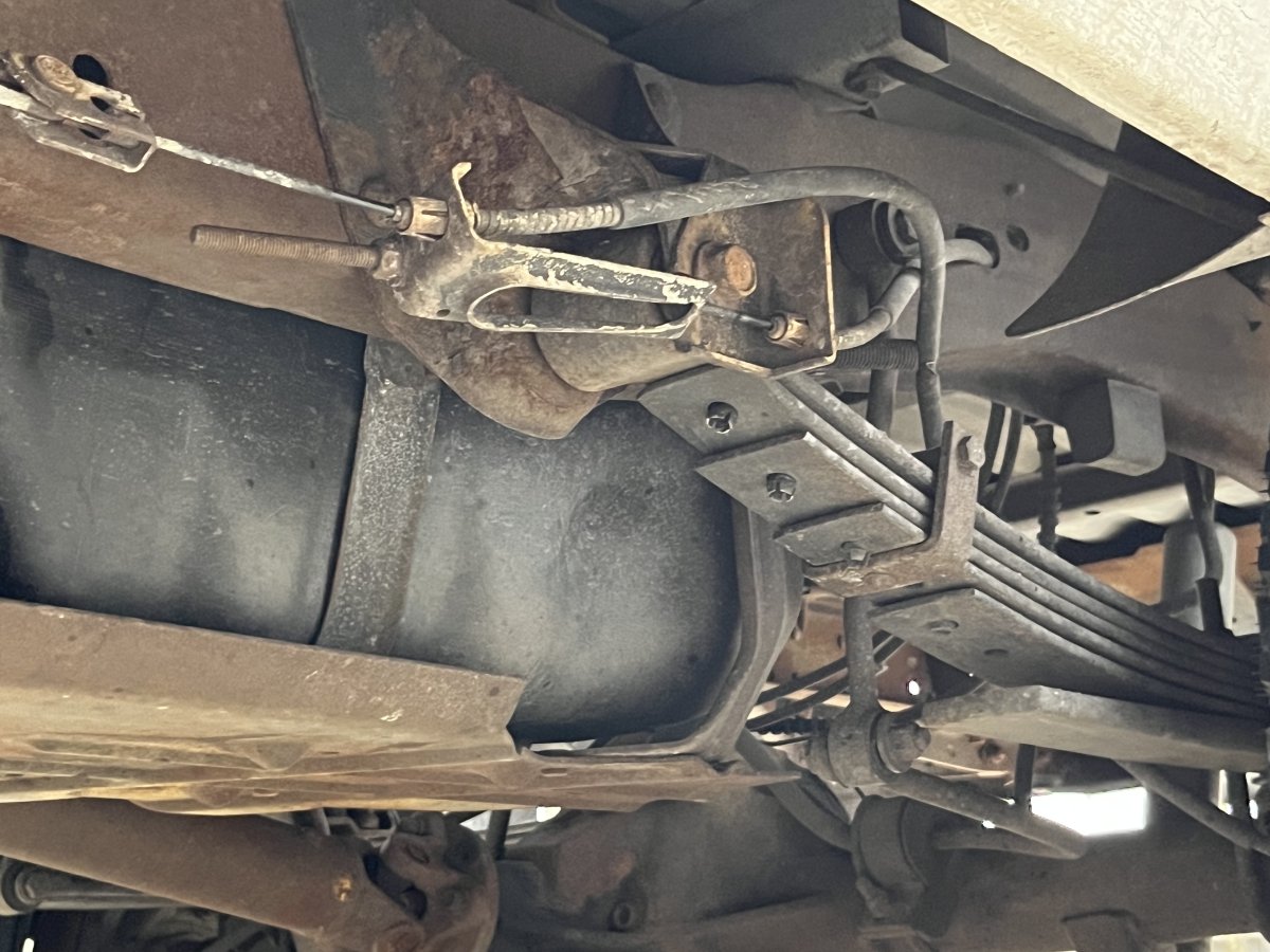

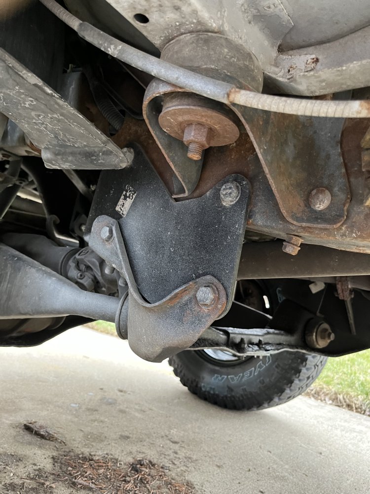

It kinda looks like the lift they put on has the drop plate for the passenger side axle beam instead of a separate bracket, be careful with that, they're known to pop holes in the top of the differential...
My dad said he thought the lift did not look very heavy duty. Is what you are talking about in this picture?
No, that side is fine (not ideal, there's better and there's worse options...), it's the one for the other suspension beam pivot, go to THIS PAGE and look at that, there are ways to help with issues possibly caused with the drop plate which we can help with if needed...
