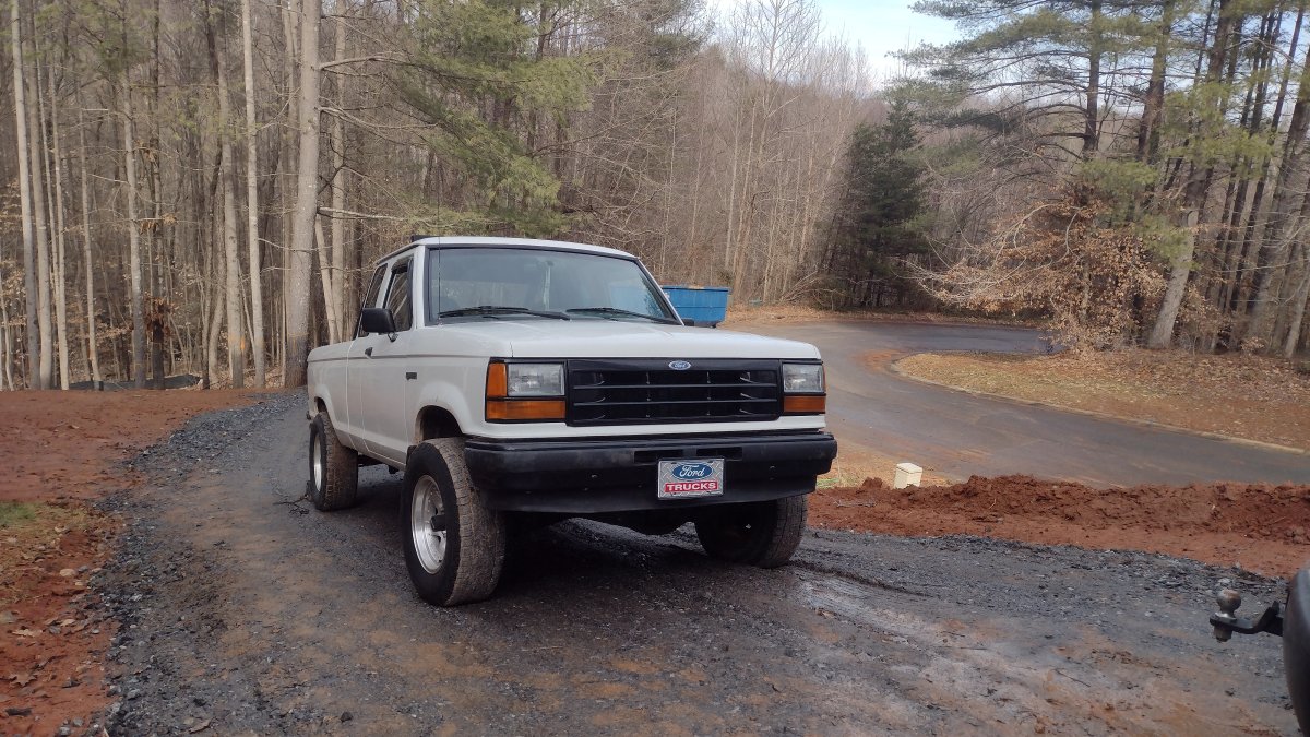

Rooster the 1992 Ford Ranger XLT 2.9L 4X4

Thanks. I read that page. Looks like I have the Rough Country lift kit. Need to fix that before I try any off roading. Right now I’m just driving back and forth to school, practice and work.
That really is a cool truck. I like your style of scavenging parts to use and replace. I enjoy my ranger very much as well.

Sweet truck dude! Ive had my 1991 STX for years and I've just now gotten back to working on it. It's come a long way from what it was. I've got to finish the lift next weekend. I'm doing Skyjackers 2" suspension lift.
