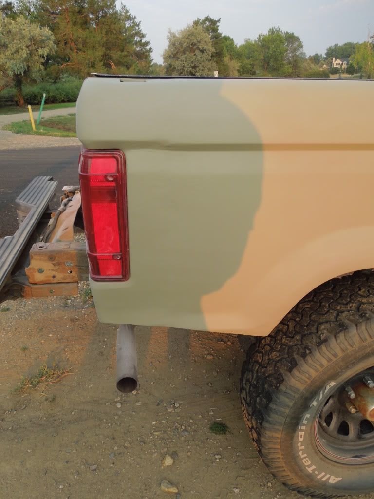

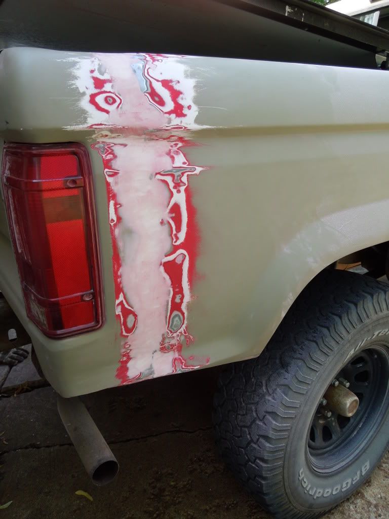

Ill get you some measurements tomorrow. It should be the same as a shortbox + an inch or so. I cut the bed to its new length with fitting the tonneau cover in mind. It would have been easier If I wanted to take out about 14" because I could simply move the rear holes to the mid hole location and be done with it. I still need to finish welding all of the seams.
I had to cut off the rear bolt/support member and do a little trimming on the very rear section that was welded back on for it to fit back up flush. I will also need to throw in a ~0.25" spacer underneath the rear bed so I can open and close the tailgate without it hitting the frame in its new location.

after 2nd cut I removed 12.625"

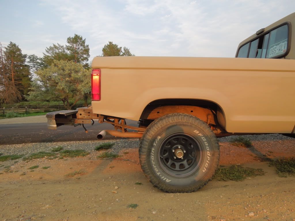

:icon_welder:I finished the bed bob today and cut the box behind the fenders to give more ground clearance. I will be taking ~11" out of the frame. The truck will be 19" shorter overall after removing the rear bumper, cutting the frame and welding in a new crossmember.:icon_cheers:

I went to the steel yard and picked up what I need for a new crossmember and some other odds and ends. Hacked off the rear frame and bumper, Cut and fit the rear 2"x4"x3/16" added 1" d-ring shackle mounts that I made. Cut stock brackets off the Dana 30, bent up and tacked on the truss, and notched the long arms.
