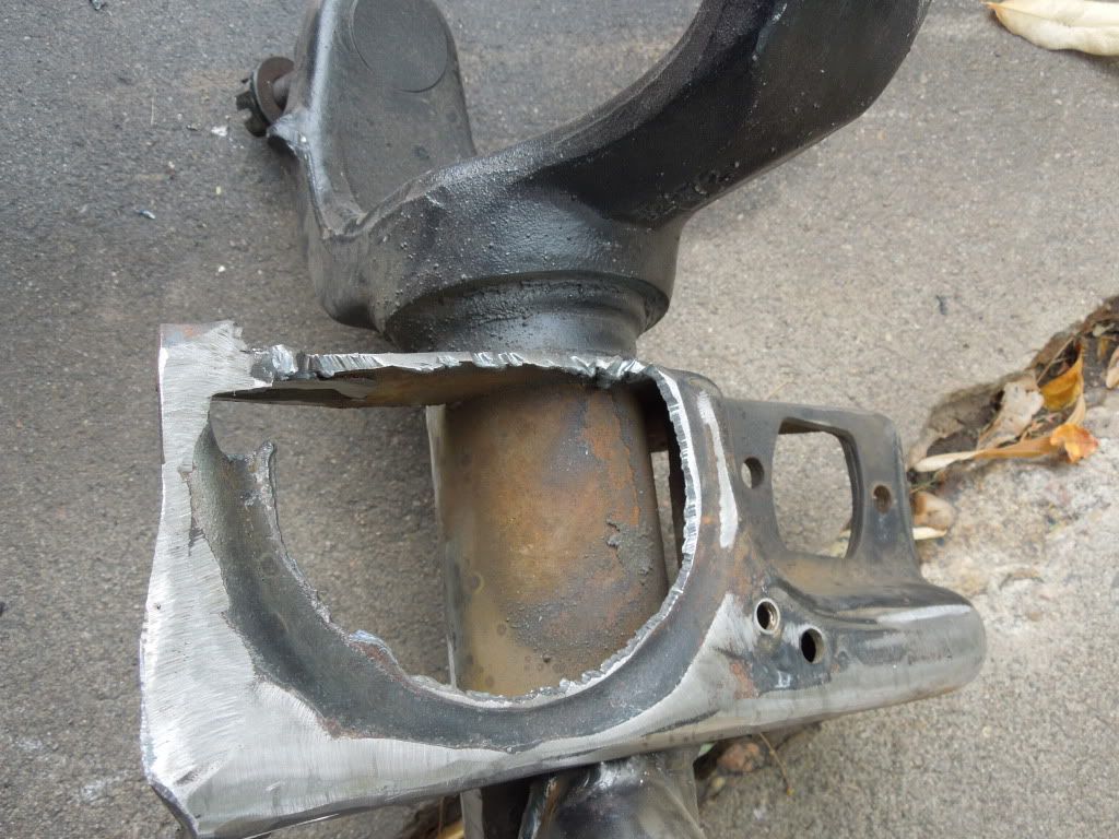

I cut the lower control arm mounts off and cleaned the tubes up to weld on the HD ones

burned off coil retainers via Stangs plasma

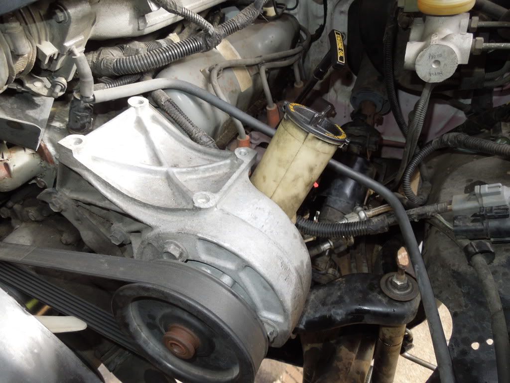

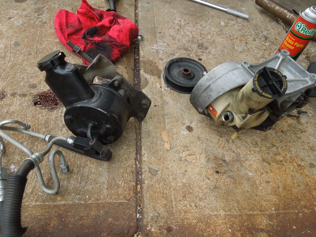

I upgraded my stock p.s. pump to a HD T-Bird Saginaw style pump. I had to make a few cuts and do some grinding on the 4.0 bracket to make it fit.
