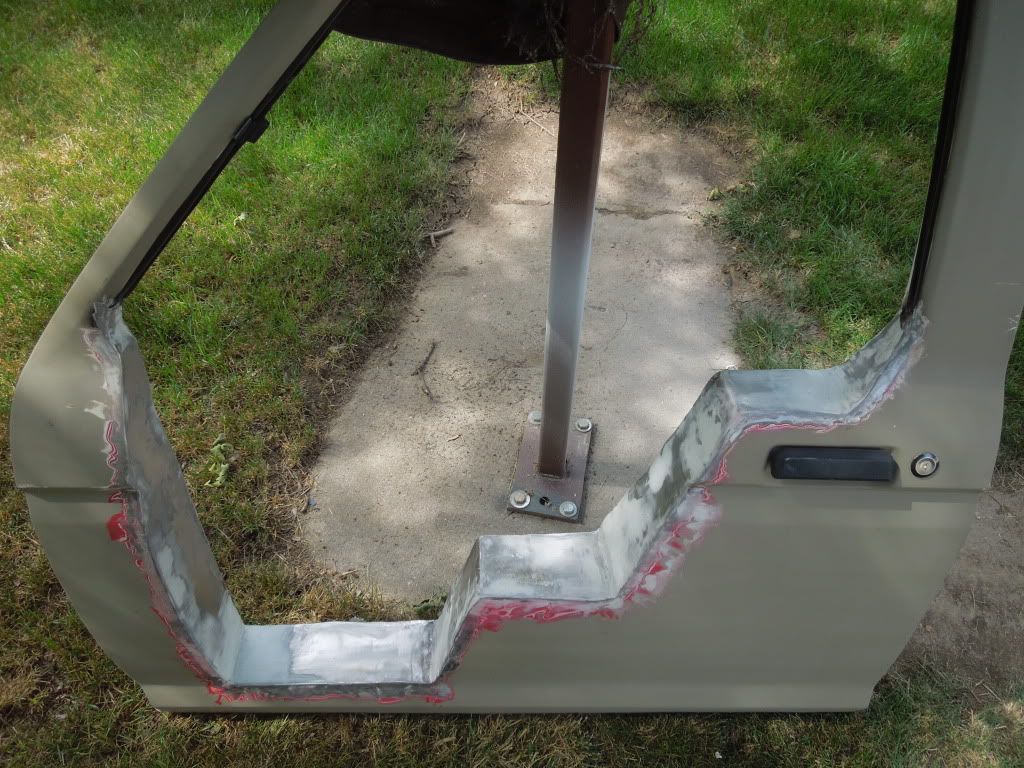

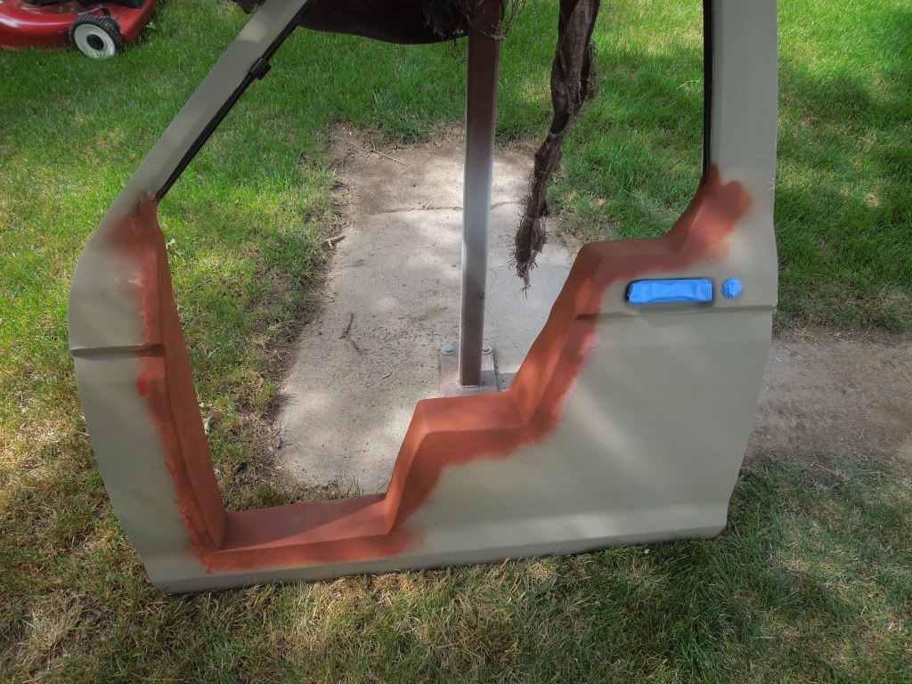

Oh, and I got these mounted today, since I had a spare set of doors I decided to cut them up...WoodyB2 gave me an idea for quick disconnects I used 3/8" bolts and drilled out the hinges as well as the bronze bushings that are pressed into the hinges to fit snug, then cross drilled the bolts and added retaining pins. I originally tried 5/16" bolts but they were too small.
The doors took me about 4 hours a piece including paint. I have always wanted more visibility on the trail, especially on the passenger side, the extra airflow is nice especially on a vehicle with no AC. I get a lot of looks from people when driving around. Just need to add mirrors, driving in heavy traffic is sketchy without them.
