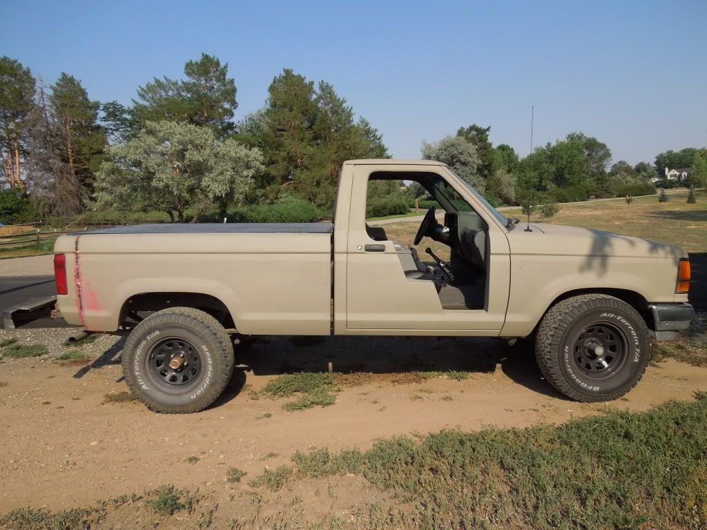

Rocky Mountain Ranger '92 SAS
Needs a bed bob, but looks good. I'm liking the cut doors, but the double step I guess is a like it or hate it...

Nice looks good! That's gunna be sweet with a D30 and bobbed bed.

The rear needs cut bad, I am going to do that tomorrow. I didnt feel like making new door handles so I kept that part of the door, and the second step just covers the seat which is nice. They are very functional, but I guess I could see how some might think they are hideous.lol.

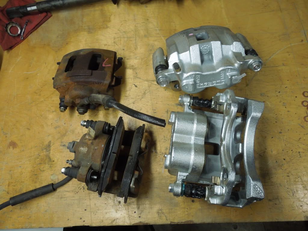

These are my new WJ twin piston Akebono calipers. These things are huge, nearly the same size as kingpin60 calipers. The WJ knuckles use two different style of calipers- 1.) Akebono and 2.)Teves. Both are twin piston designs with the Teves being a bit smaller. The Teves calipers have a reputation for warping rotors and were recalled and replaced with the Akebono style on the later model jeeps. I got these akebonos brand new, not remanufactured complete with hardware and pads.
and a picture of them next to the stock XJ calipers they are replacing

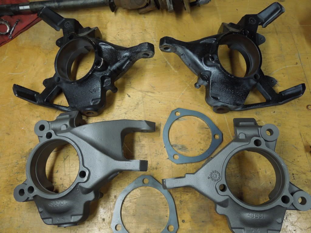

this shows the difference between the XJ (top) and wj knuckles. you can see the extra steering arm on the passenger side knuckle of the WJ knuckles that allows for a true cross-over steering design.
knuckles after beadblasting, ready to weld the JKS spacers on. The ~0.25" spacers are required to align the u-joints with the axis of the knuckle. It is sandwiched between the unit bearing hub and the knuckle. this spacer is needed because the depth on the WJ knuckle is shorter than the XJ knuckle, without it the hub will botom out against the outer stub shaft before it seats.
I ground a bevel around the inside of the spacers and bolted them on tignt with an old unit bearing and then welded them on with the MIG turned up nice and hot welding a small bead and skipping around. I wrapped the knuckles in welding leathers and about 20 old t-shirts and towels so that they would cool as slow as possible. It took about 6 hours for them to cool enough to touch.

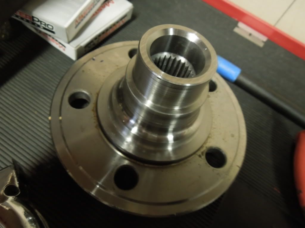

You also need 99.5+ unit bearings for this swap the 99 unit bearing isn’t the same. It was a mid year switchover. If you don’t use the newer unit bearings the rotor will not be properly spaced inside the caliper. I used a Timken part # for a 2002 XJ
96XJ on left 2002 XJ on right

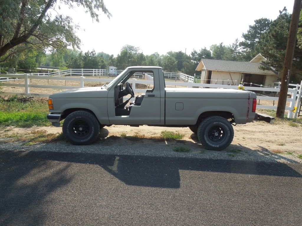

Looking good so far, liking the Reid look a like color :icon_thumby:
SVT
I will trim just below the lower body line, and finish the body work. The frame will be cut off just behind the shackles, til then Ive got a battering ram for the tailgaters.:icon_cheers:
